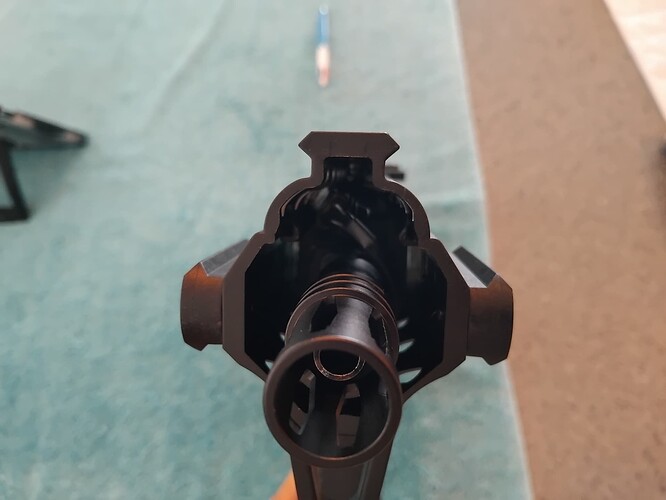

I effed up one day and the fertilizer spreader went arse over tit. Broke the whole plastic hopper. Gorilla glue applied so I could get back in action. Was up all night sorting that out.
Got it done :+1:
Pretty sure Low Guido has a video on these.
From memory… massively over volumes and poor seals. Anything you do is gonna be under volumes on this one though! I’d bet it would take a vector nozzle… :thinking:
Either way no matter what you do the tiny barrel is gonna be hard to get any decent fps out of.
It was a challenge to get 280 out of the 14cm APC-9K barrel, this will be on another level.
I’d settle for 240 fps, and feeding properly…!!
Here it is, for reference…
He got it up to 270 fps, in the end…!!

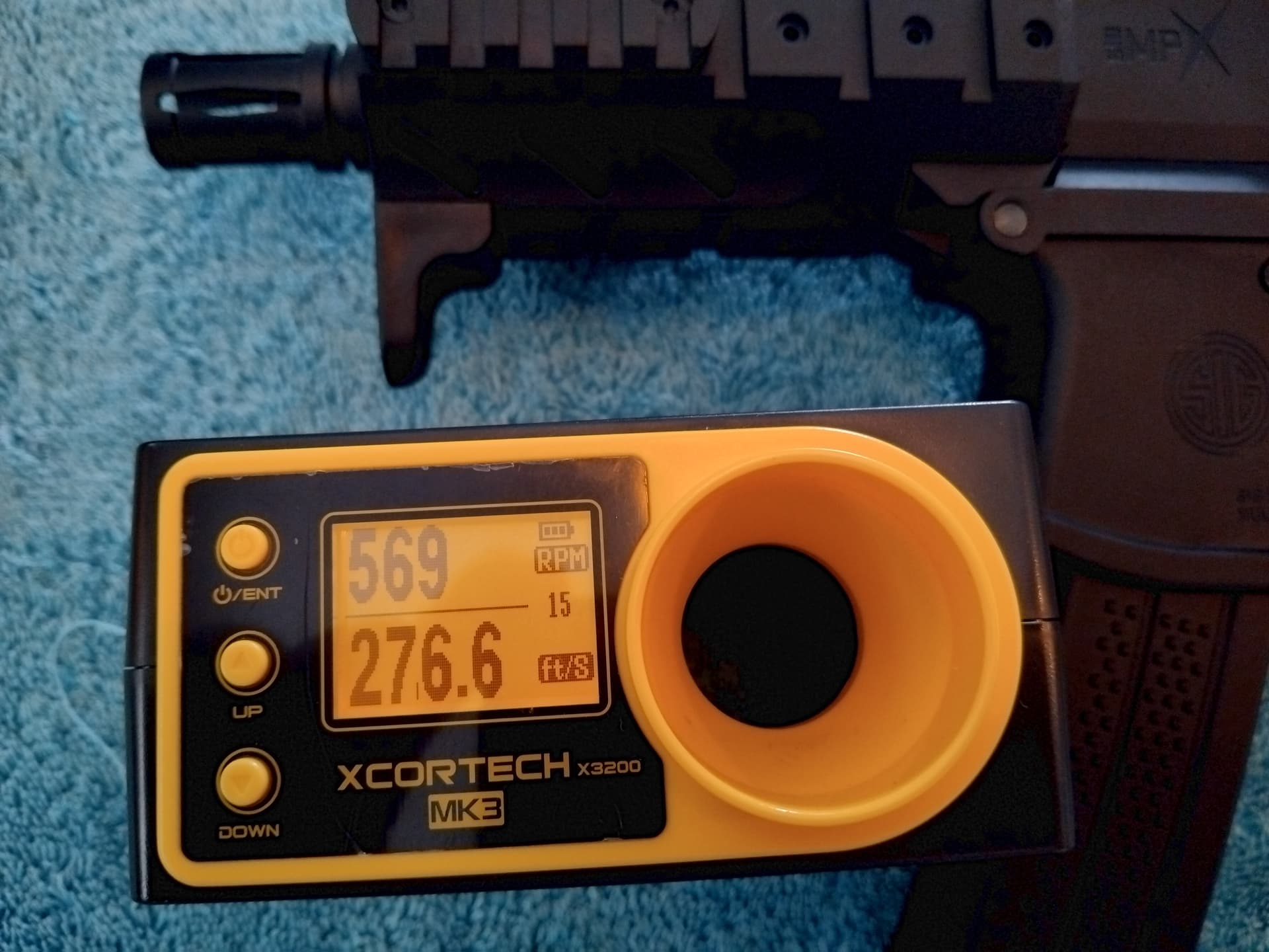

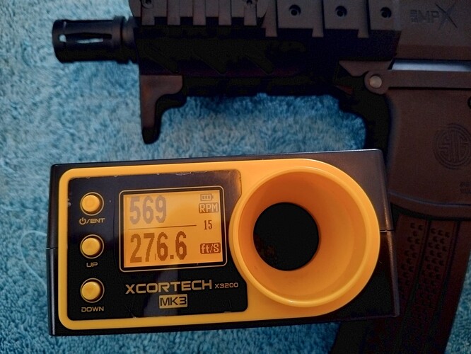

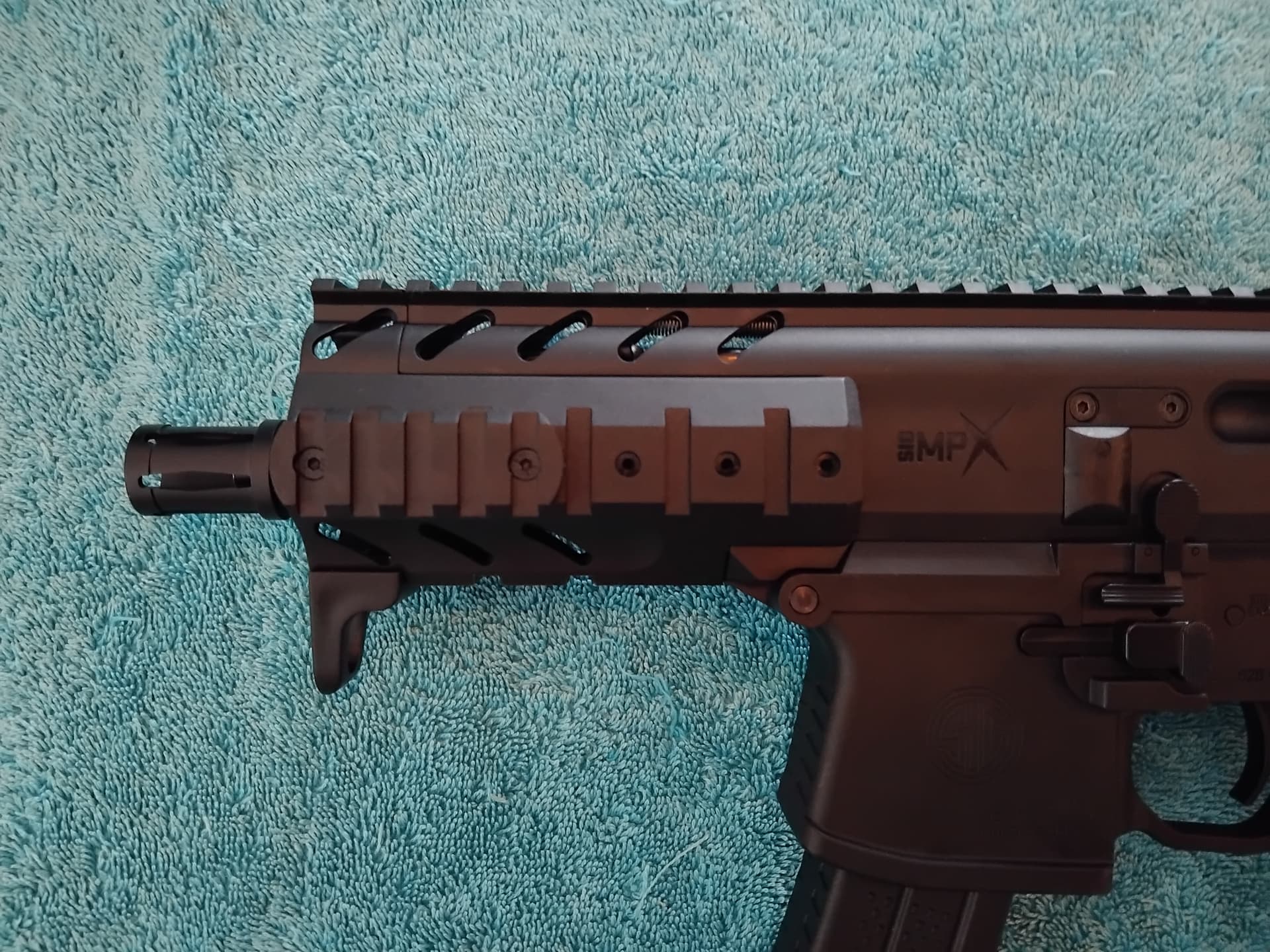

20hrs of setting time, time to give it a test fire.
First things first.

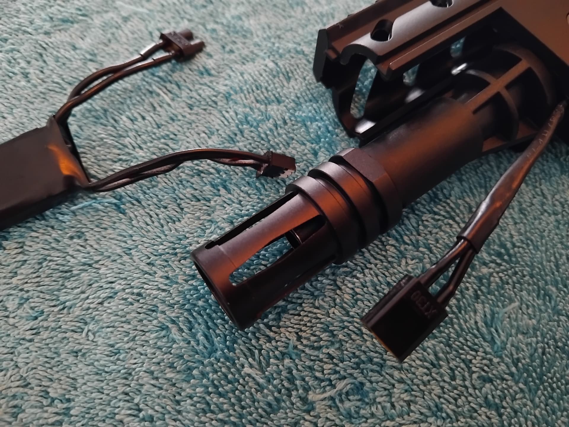

Paint / black out all those visible wires…
Nothing to see here…

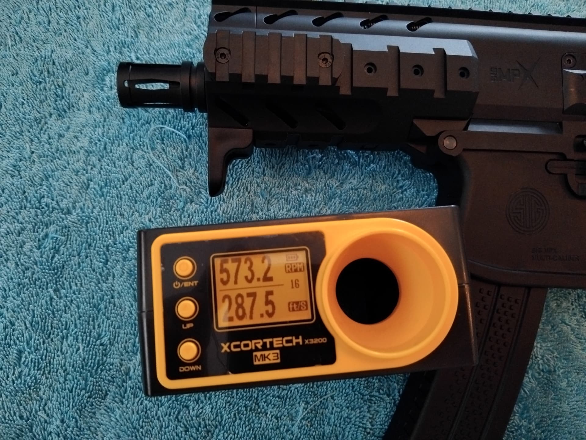

So, how’s it go.?.?

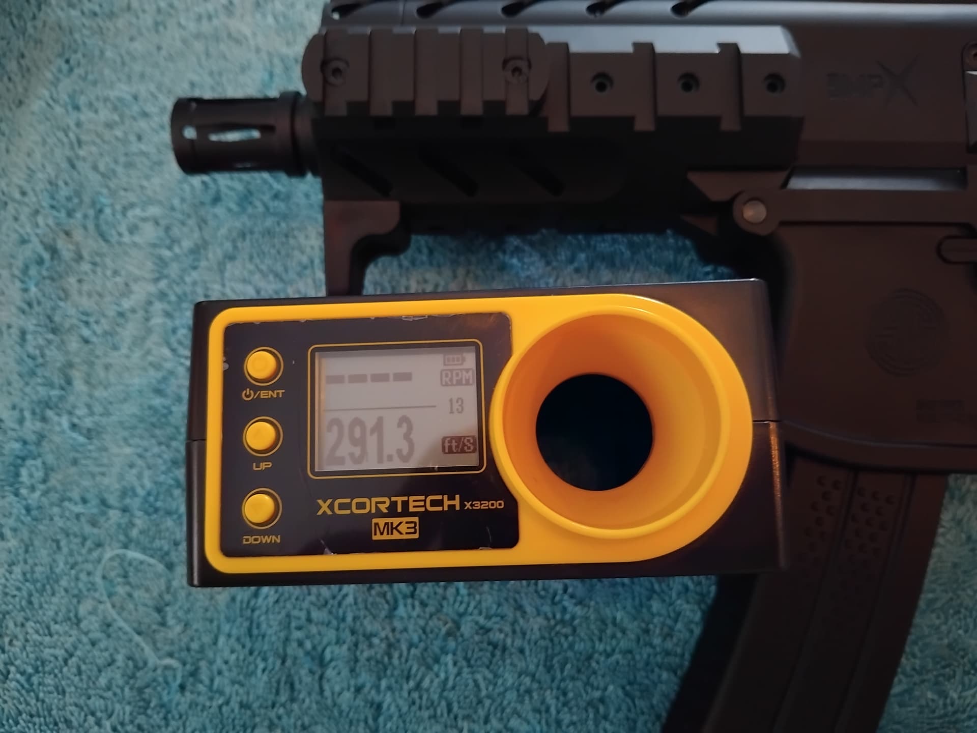

That’s from a M95, with the extended barrel.
I could try a M100…but the larger Rattler spring jammed regularly on it…
And it did 340 fps, on a M95.!!
This should keep it running OK, and stresses down.
The gearbox is also a bit loud… so this will help.
The new spring will settle down…and probably be a solid 270+ fps blaster.
FPS can vary… ive seen some 240-250…but most 270+…
ROF is a bit lower…but that’s okay, coupled with a smaller mag.
Accuracy is good, the barrel is stabilised quite well, with its tight barrel holder.
I dont have the " dart launcher" Low guido has…my inner barrel is about 2 cm shorter than his, and the tip hides within the birdcage…not protruding.
The initial feeding problems, must have been due to a “slowly flailing, and failing” nozzle…which eventually came off.
it still does have some feeding issues occasionally…but a prolonged auto burst usually clears the throat.
Like wise, the very occasional shredded gel…go for harder gels, ie ihobby blues.
Final verdict… Me Likey…!!

2: Shortest barrel i’ve ever seen…!!
My pistol packs more inches than that…!!
LeHui…what were you thinking.?.?
Replacement mandatory… but easy…no glue reqd.
3: need slimline 7.4v battery to fit into compartment.
11.1v would struggle to fit.

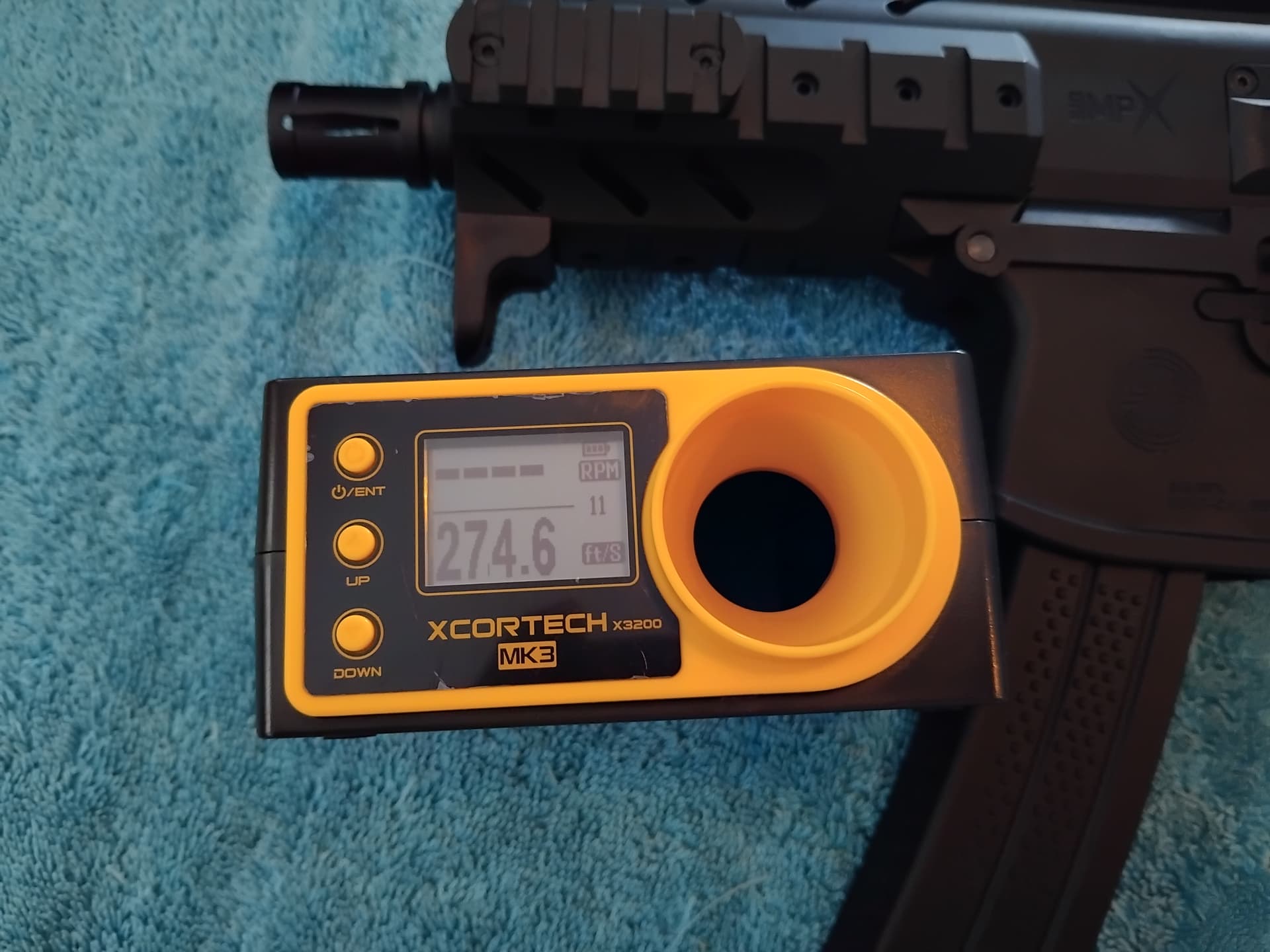

Nylon comparo round up so far…
Long rattler…340 fps…m95…bigger M4 mag( proprietry)
PDX … 320 fps…M100… M4 mag ( standard)
Mini rattler… 275 fps…M95…Custom mag.
Mosfet Mini rattler…300 Fps…$$$…
