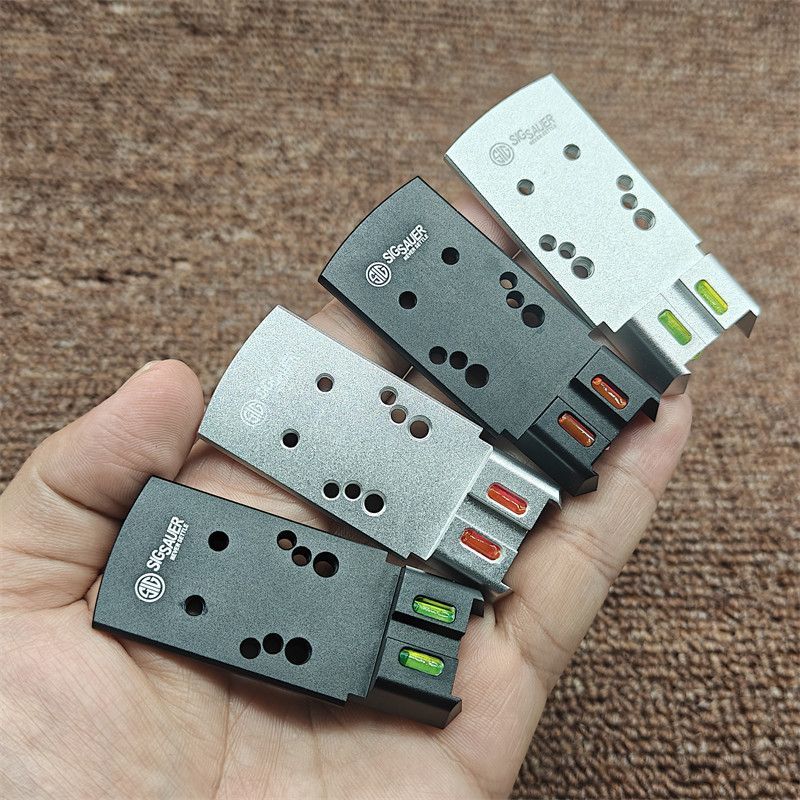

Ordered a red dot off eBay, their tracking is weird but it showed up, tried mounting it on my p320, nothing lines up.
Mounting plate the rmr came with I’m assuming is for a Glock cause it’s got a dovetail I’m guessing replaces the rear iron and the removing the plate on the blaster reveals no mounting options underneath and the mounting holes on the sight don’t align with ones on the blaster either… :smiling_face_with_tear:
Thought it was a pretty universal mounting at this stage, will probably have to get one of those universal plates for it otherwise it’s going on something else.

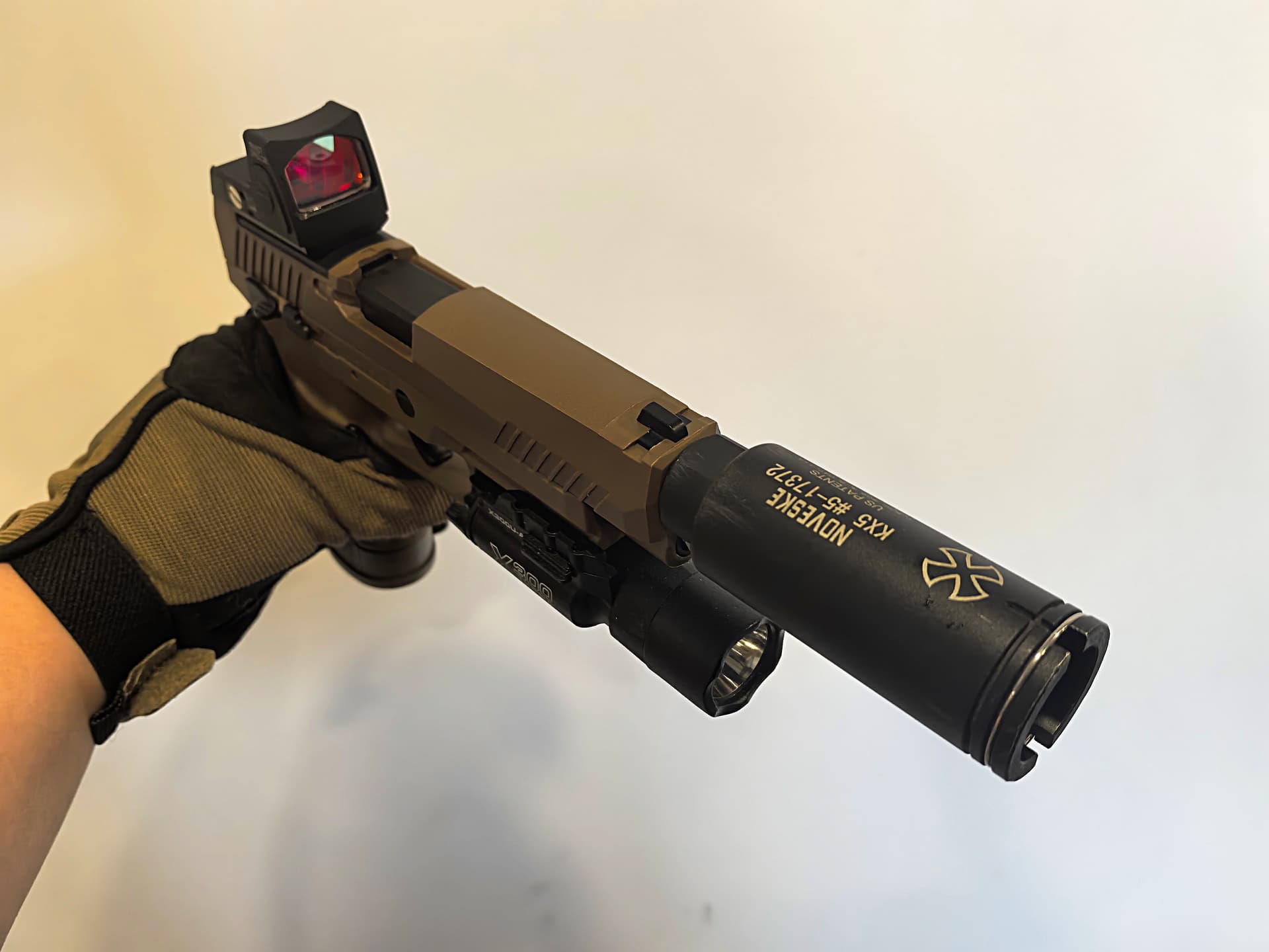

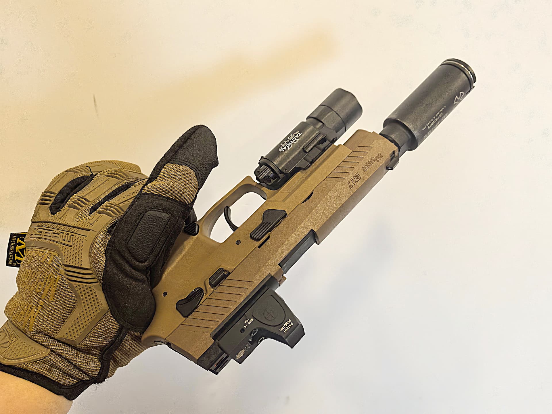

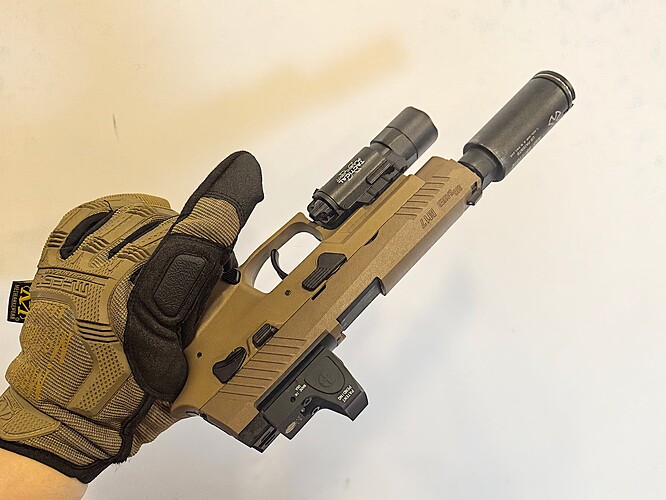

There are aftermarket barrels with a threaded front available, also upgrades performance and has a metal hop up instead of the nylon. Has been an improvement for me at least. Available in China from an independent shop that specializes in upgrades for pistols.
The RMR mounting plate is a bit different for the UDL P320. I got one with built in rear sights, but you can also find ones with an empty rear sight slot if you want to mount taller irons to get co-witness with your RMR. Again, available in China.
I put a suppressor on mine just for shits and giggles. So far I haven’t really noticed much interference with performance.
Mm hmm 3 types of patterns. Forgot Sig USA gotta have their piece of the pie besides Glock and Beretta. :roll_eyes:
