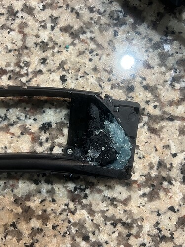

I just haven’t figured out to post any questions on the site, I recently purchased a gel blaster rifle from LKCJ for $179, the build is pretty decent, I watered the soft to the recommended size however the magazine keeps clogging up (see photo) I spend more time cleaning it out than shooting, any diagnosis or suggestions are appreciated.

The feedwheel shouldn’t be mashing gels like a mincing machine like that. Check it for sharp mould lines or anything that might be cutting your gels.
Another possibility is the above combined with a stuck gel retainer at the top of the feedtube. Check it for free movement.
But it’s more likely going to be the gels you’re using. If they’re the ones that came with your blaster they will be soft and of questionable quality. They may be too soft, too large to fit into the mag feedtube or just plain shite.
Grow some harder, better quality gels like AKAs or Ultra Elites and see if that solves your problem. :+1:
Welcome to gel blasters… where the fun of sorting out poor manufacturing practices never stops. :rofl:
