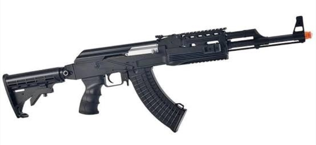

Newer AK from CYMA it looks, maybe they updated their whole range.
Why do they always have to do that with the rear sight leaf also…

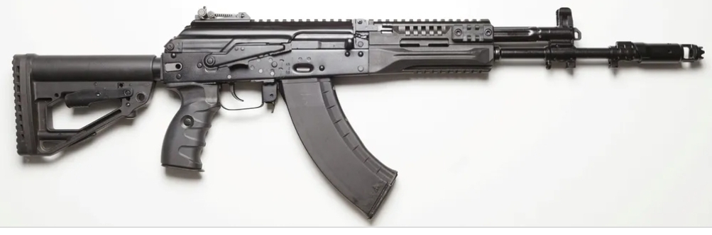

I remember everyone hating on the JM J11s when they were released… nothing like an AK, too tactical. Then the Russian Army was issued with the AK15s and the J11s started making a bit more sense.
Jin Ming J11 AK47
Kalshnikov AK15
Jin.Ming didn’t do a bad job. Now I’m waiting on a decent gel version of a QBZ191 to surface.
