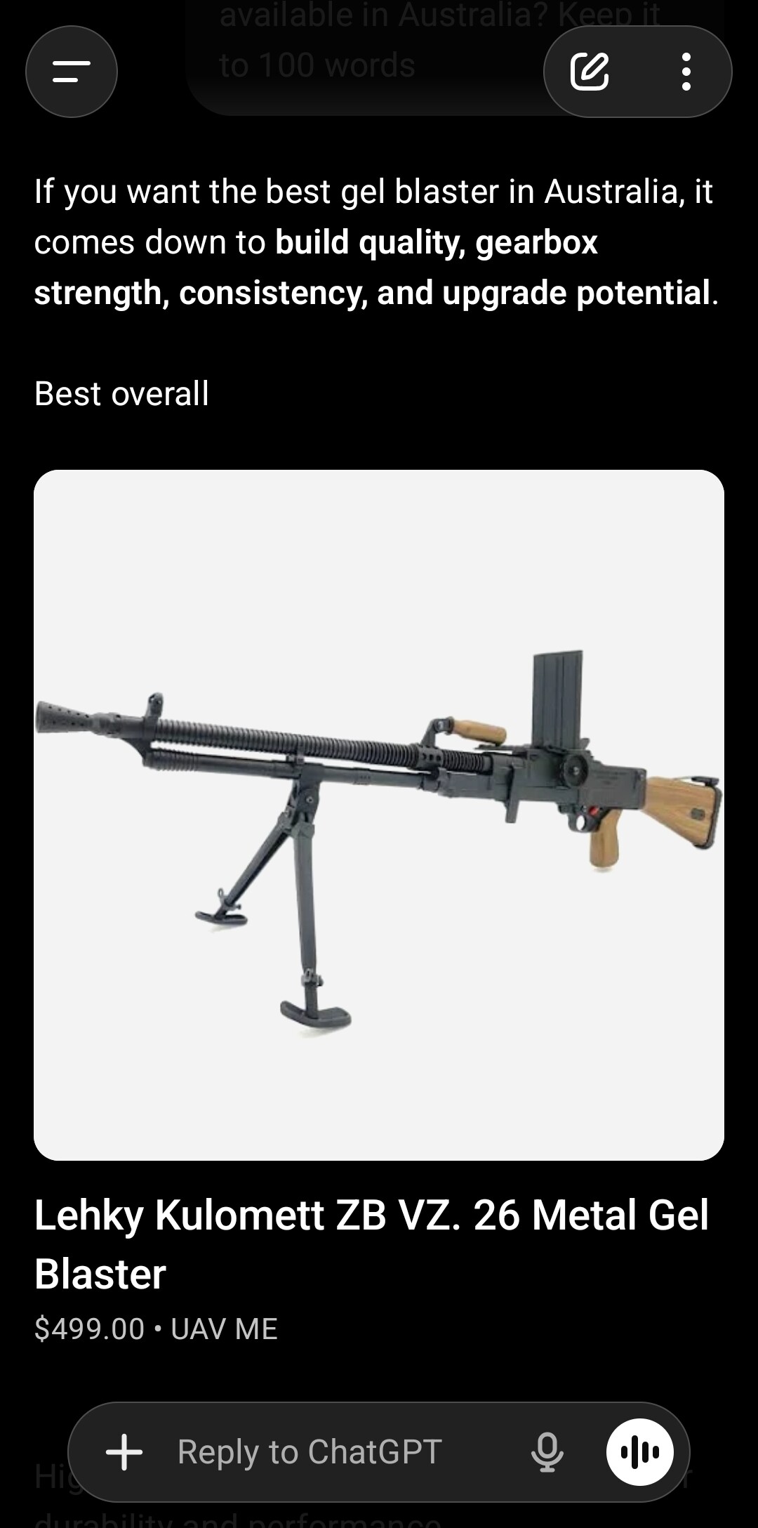

What’s the best entry level gel blaster available in Australia?
DocBob.com.datauser agrees…!!
Best for WA, anyway…!!
At least it got the upgrade potential right…
140 fps to 290 fps is doubling it…big increase…!!
They must be referencing Rok’s Reviews…!! Making AI smarter…!!
HAHA! The ZB is so far from the best gel blaster it isn’t funny.
Terrible out of the box, so much to be desired and so much work to get it just formidable.
A very cool piece don’t get me wrong, but for best there are countless better ways to spend your money.
