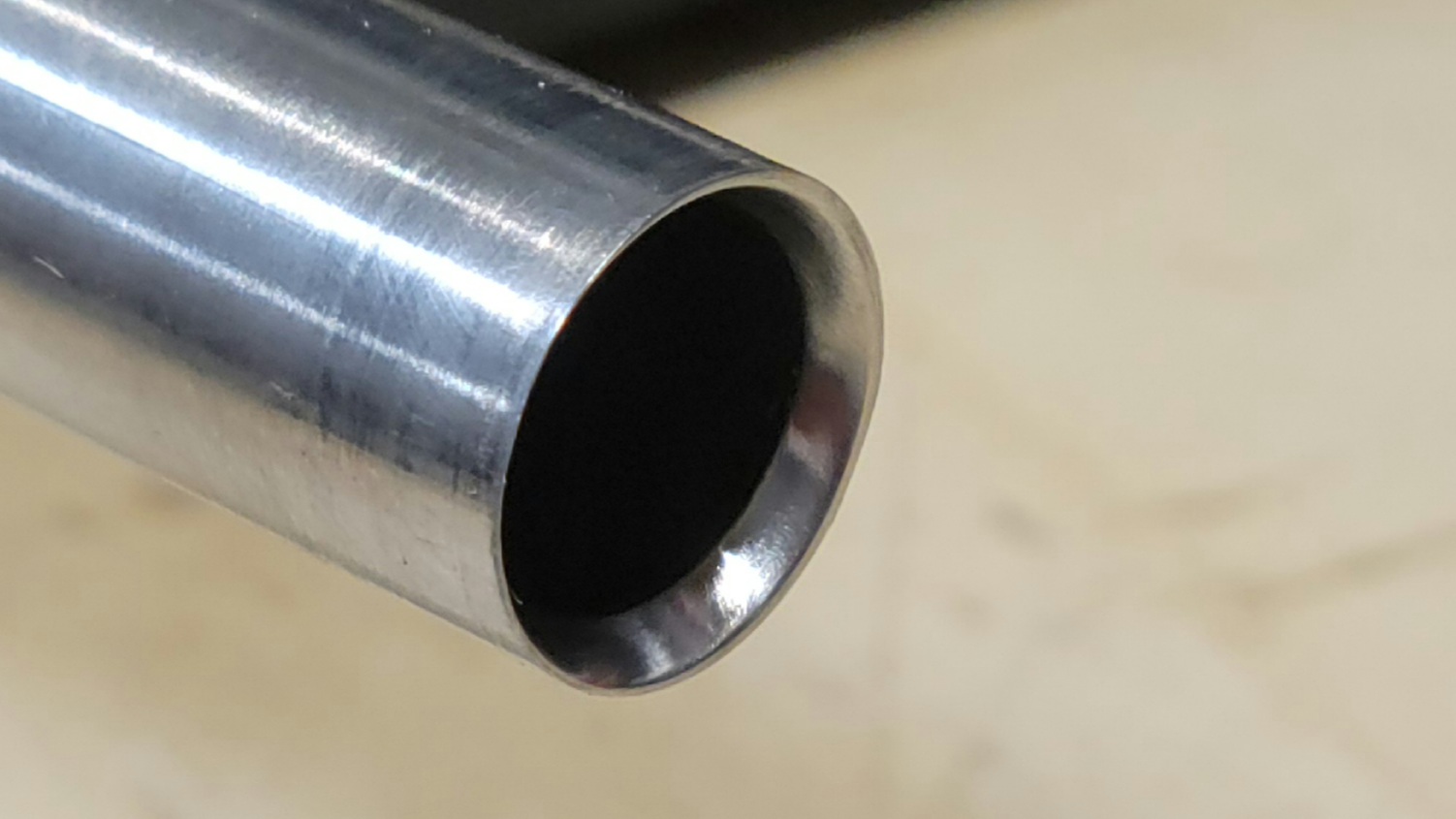

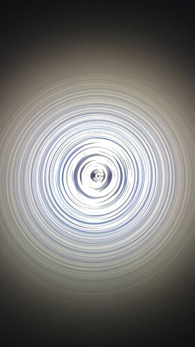

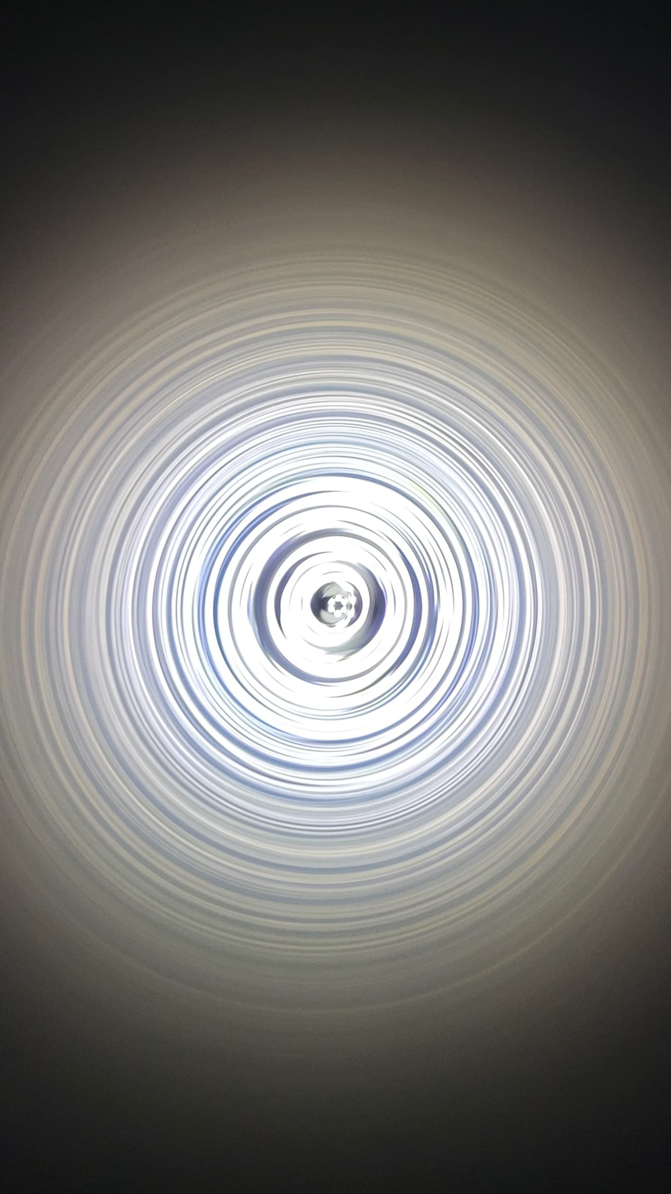

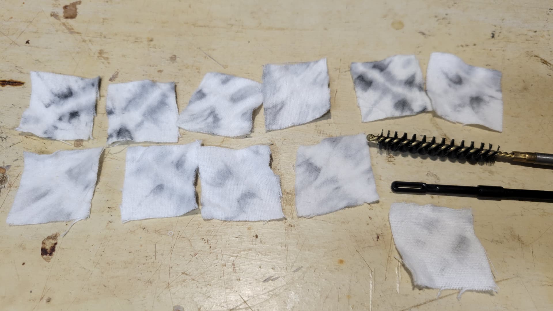

When initially looking down the bore I was pretty disappointed as it was incredibly dull, the inside of the barrel was incredibly dirty, assuming that’s from the electropolishing process. After about 20 minutes with a 7.62mm nylon brush, isopropyl alcohol and several patches the bore really started to shine.
Close up photography is not my forte so I wasn’t able to get a photo of how polished the bore is, but I was able to put a light down one end and the phone camera pressed up against the other to show just how much light is reflected inside the bore, hopefully that gives some indication of how polished it is.
Patches before and after
It also has a really nice bevel on each end

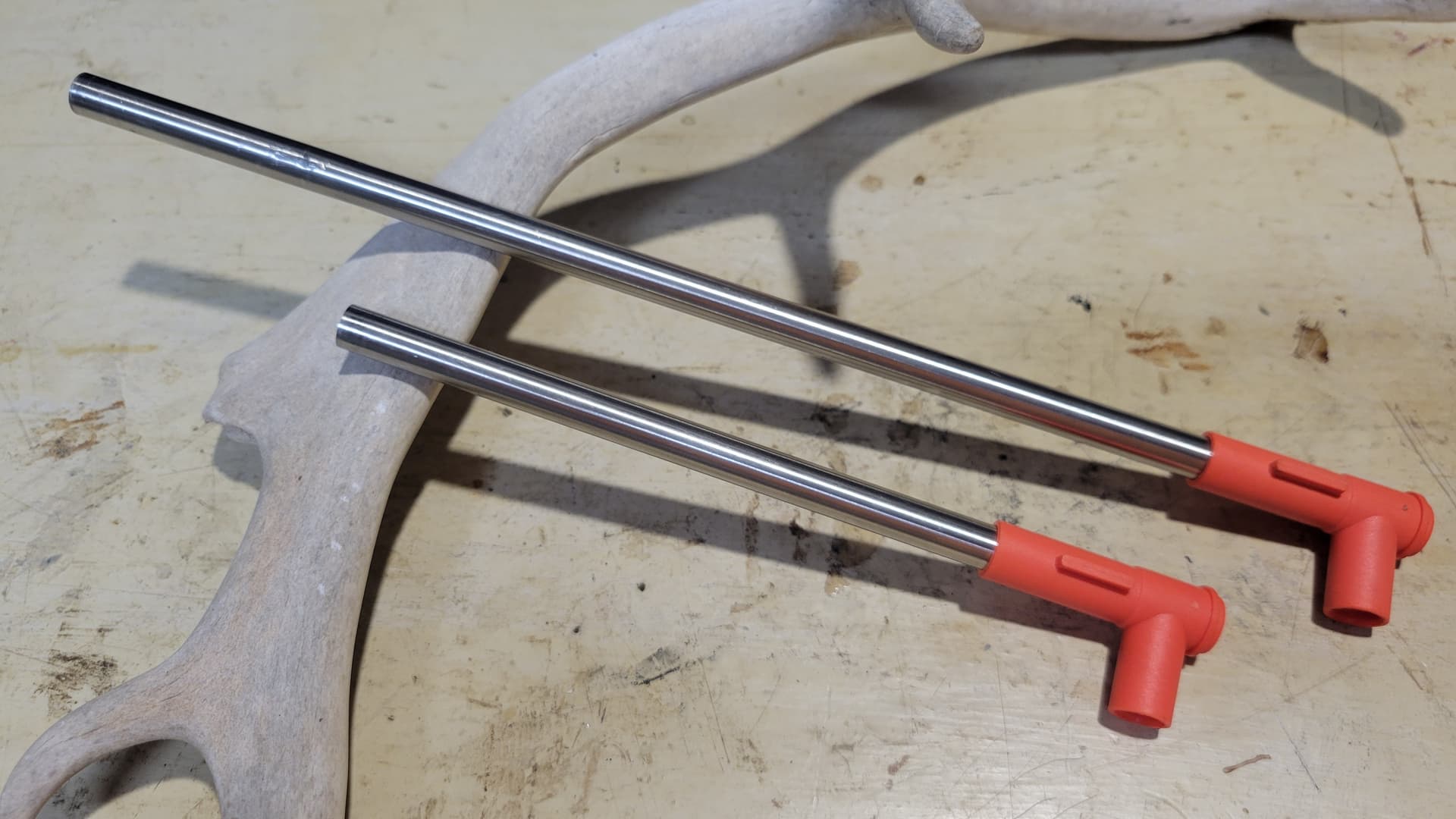

45cm is too long for my needs but I bought it with the intention to cut it down to make a 28cm and a 15cm barrel but given show shiny it is I’m thinking of trying a 33cm barrel on an SLR ION with a full cylinder.

Ah bugger, I didnt look at the light reflections from that point of view DB. All good, I’ll see how it performs on the weekend. It’ll be cutting this barrel to the same length as the existing alloy barrel for a direct comparison.

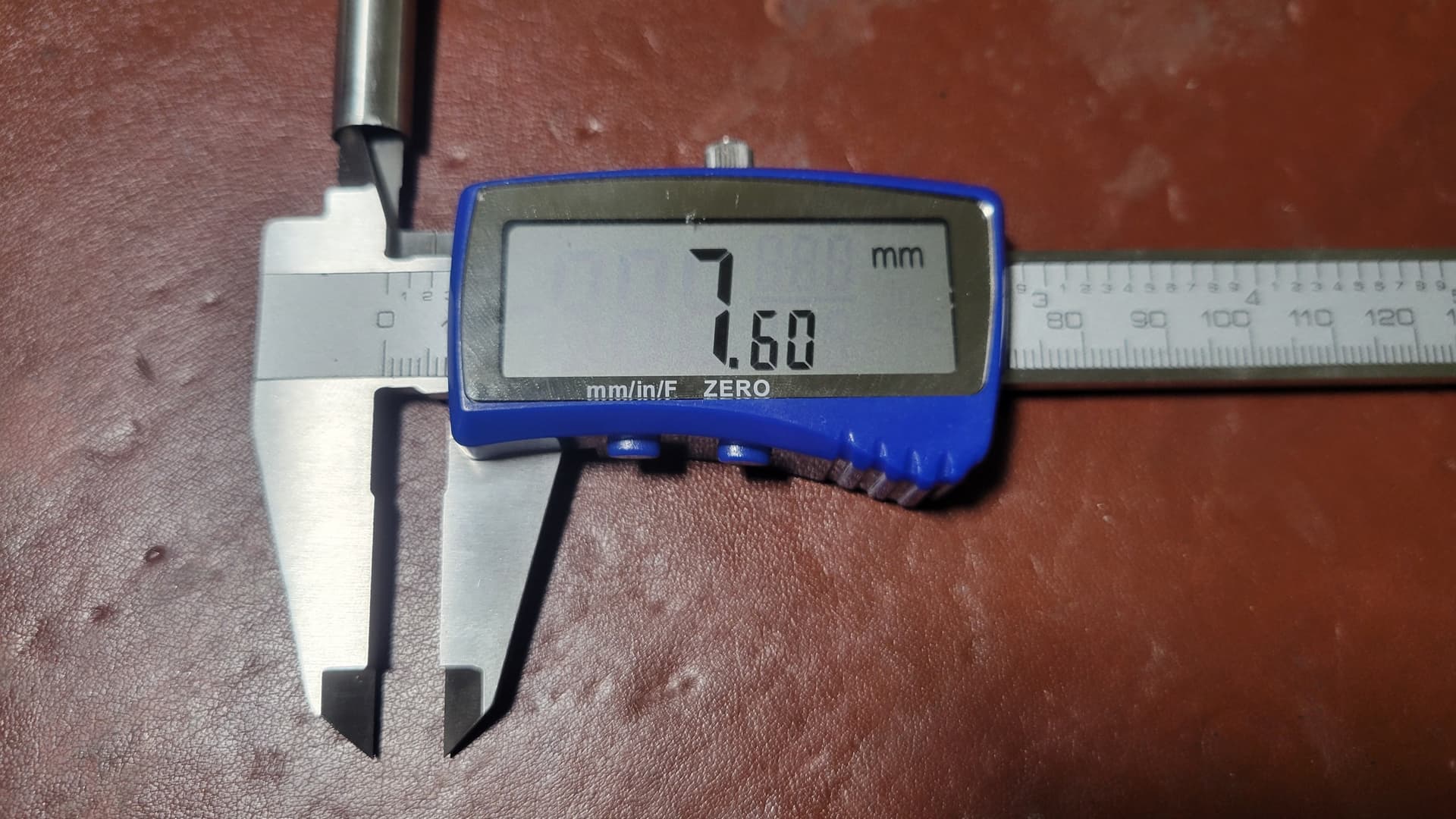

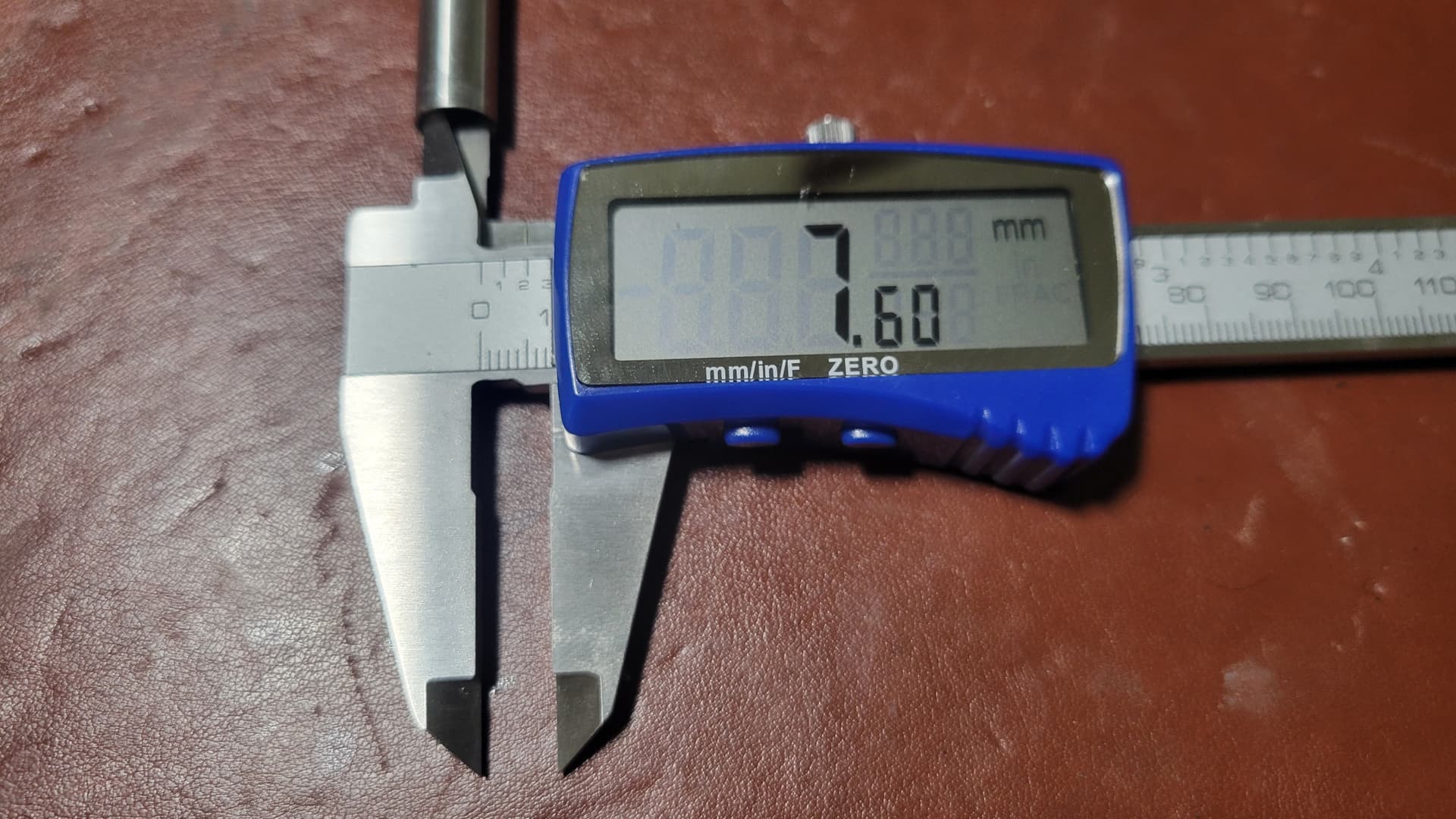

Or at least, a direct comparison as I can make it - I measured the ID of the new stainless barrel last night which turned out to be 7.55.
Might perform well with that nice “rifling” finish on the inside! :stuck_out_tongue_winking_eye:
If anything, it certainly makes for some pretty Artistic photos!

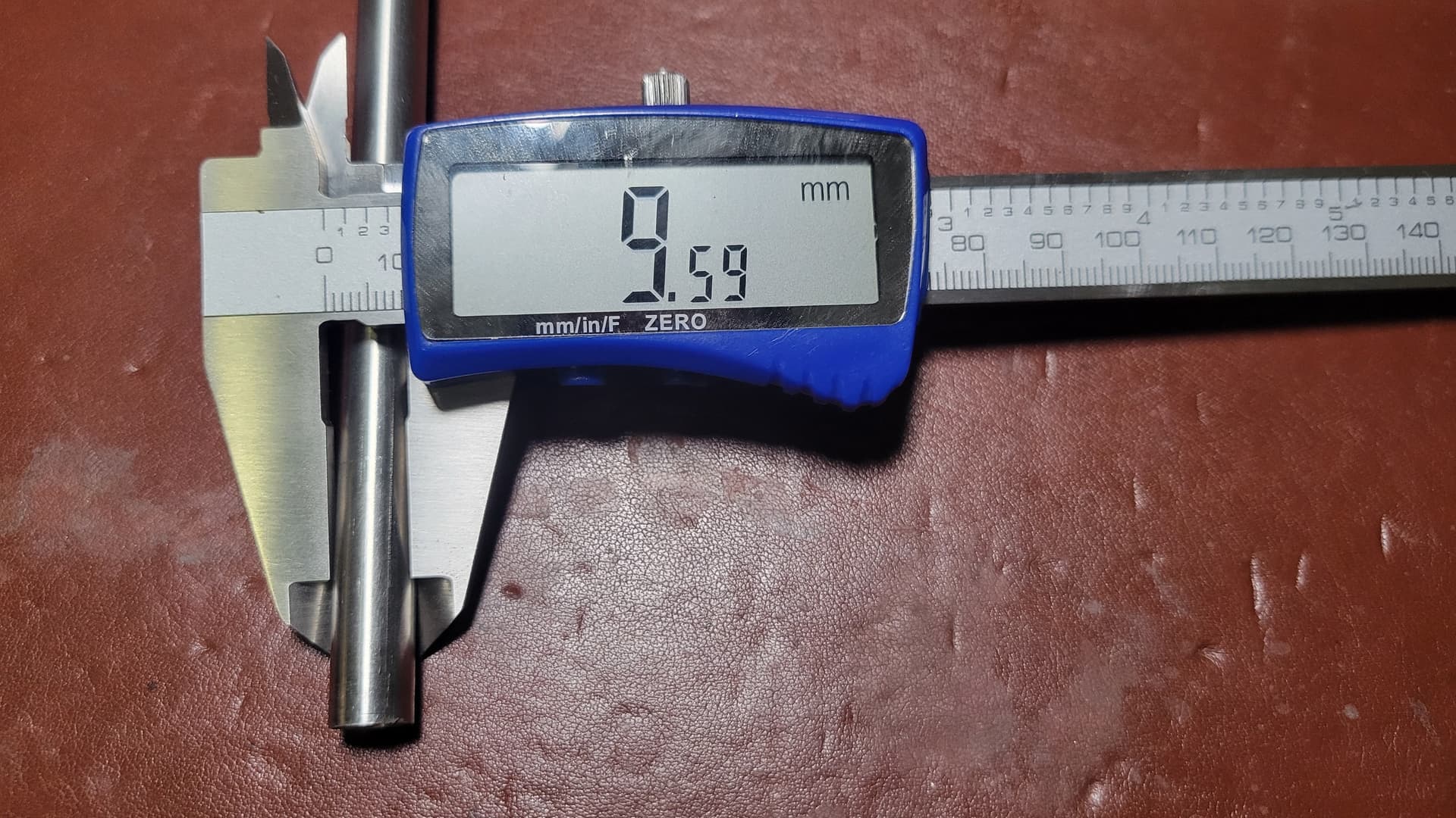

These barrels have a 9.6mm outer diameter so wouldn’t play ball with a couple of the screw on hop ups, not a deal breaker I could get them down to 9.5mm at the hop up end with some sanding. They are extremely tight in the T piece though.
Internally they are actually closer to 7.6mm inner diameter measured with a decent set of verniers. With our gels sorted between 7.25 and 7.45 the accuracy was no better than an alloy barrel. This was tested across two blasters with the same gels and the same hop up.

45cm barrel becomes a 28cm and a 17cm
Cut off end turned out OK
Two measurements taken north south/east west
