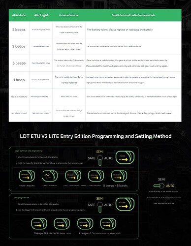

Hey @RokSolid or @AKgelblaster , I just bought one of those LDX green gearboxes (arrived at my door in less than 24hrs from time of ordering too :+1: ) and was just wondering if you had a link or image for the ETU programming sheet or anything like that? there wasn’t any cards inside the box and can’t see anything on the site.
Have had a look online and can’t seem to find anything for this one unit.
Thanks.
Figured I’d post it here in case others have the same question.
I have one in Chinese but google translate with it was challenging, didn’t get everything.
Will get one in Engrish soon for you.
We should also have it on the website for all.
Cool thanks.
Unless I’m blind I couldn’t see it on either site, but I’m sure I’ve seen it somewhere before but do you think I could remember where :thinking:
Yeah I heard ya!

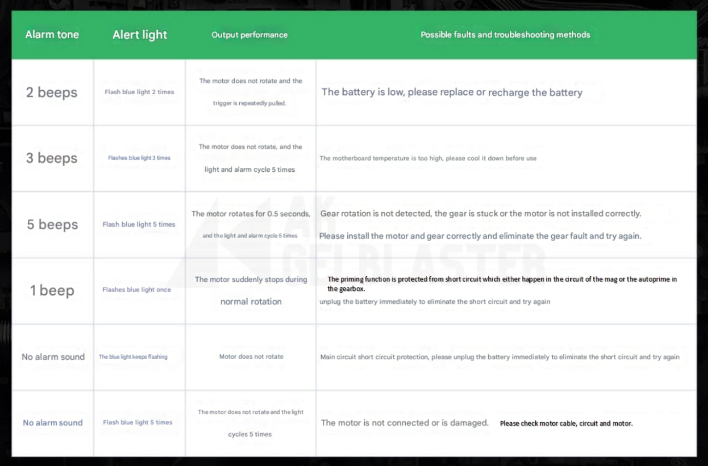

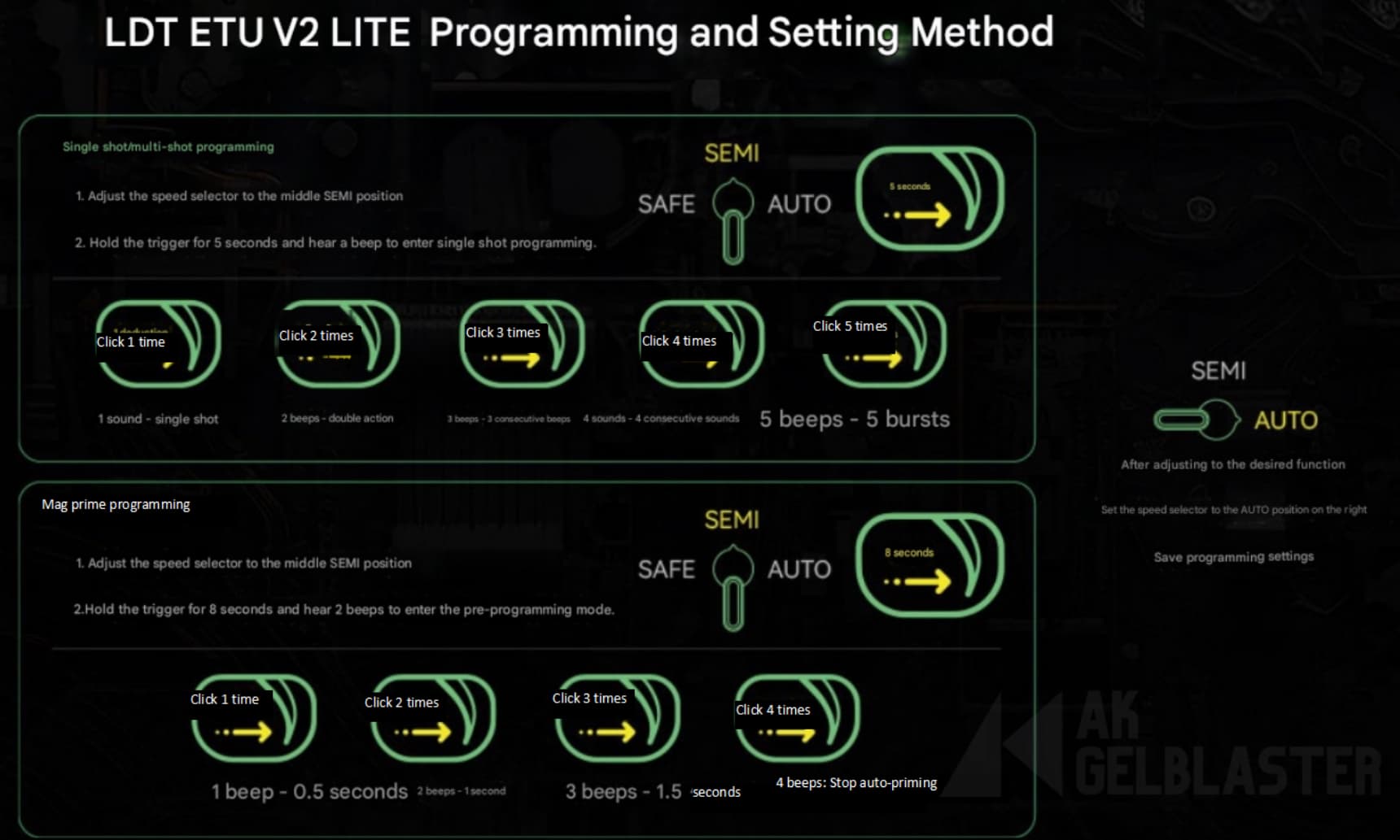

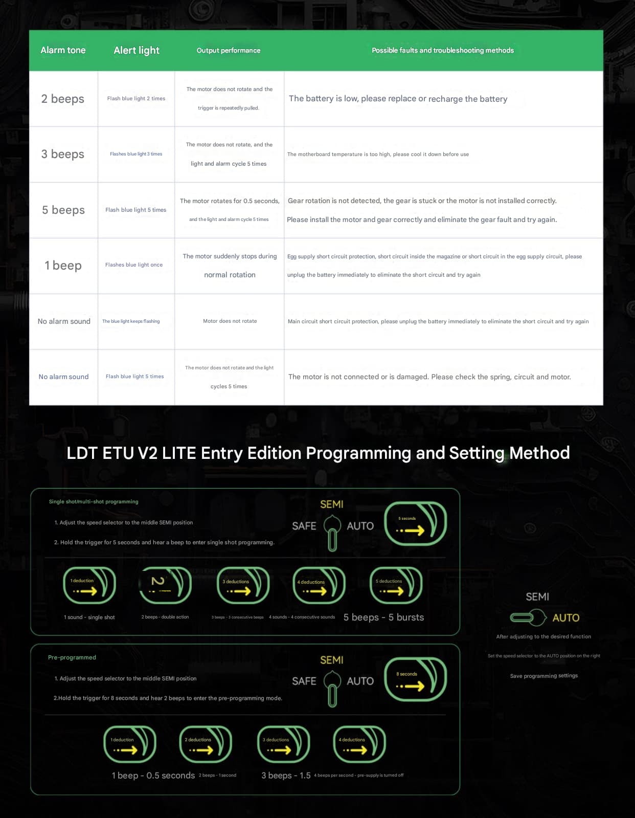

Currently… this is the translation version… will update to make more sense
Awesome.
I did manage to find the full Chinese version of that but Google Translate wasn’t helpful at all, that one I can at least understand what’s being implied.
Thanks.

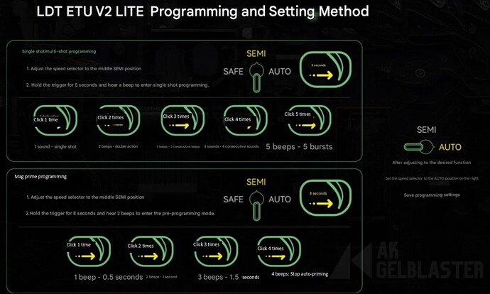

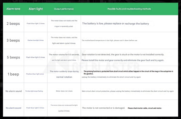

AKgelblaster has done some work on it.
Bit easier now :grinning:
