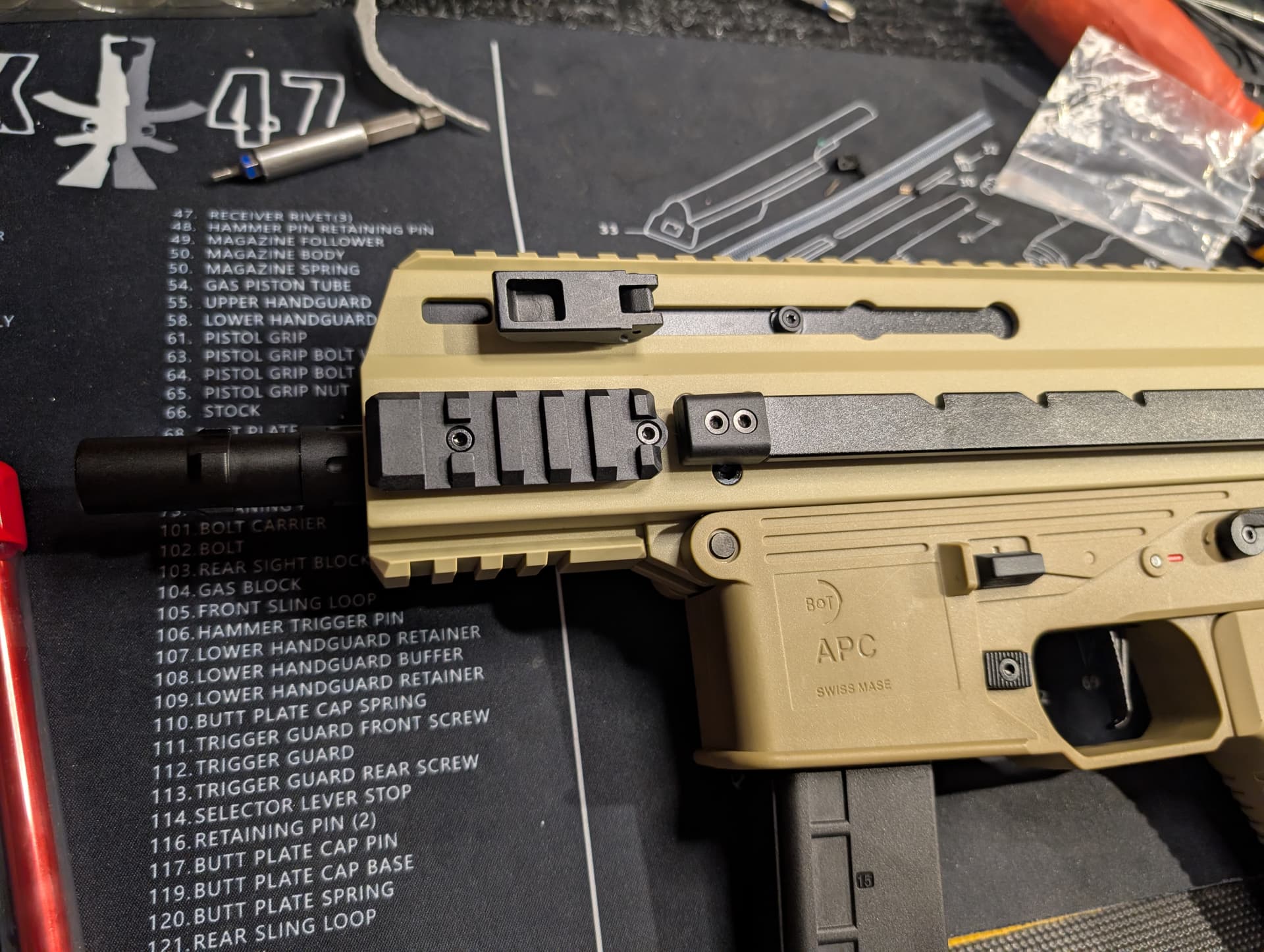

So @BME APC9K is done. I’ll have a video of it at some point, I have quite a few to get done!
Will also have a video on installing the hopup barrel. Pretty easy but it will be heaps easier and less worry to follow the guide.
As for beemers APC… nozzle, piston and piston head, short stroked two teeth, hopup barrel. Done. With stock spring got 225fps. Standard was 220 so not bad, especially since the semi is a little snappier with short stroking. Efficienter-er!
Using a JG stock spring usually around 280fps got it up to 240fps. An m100 seen it up to 270-280 fps but with noticeable motor load on 7.4v.
To be expected. I doubt there much more to gain from such a short barrel.
Now hopup barrel works a treat. Was able to sky the gels pretty easy and then backed it off to gave a good range boost. Like em!

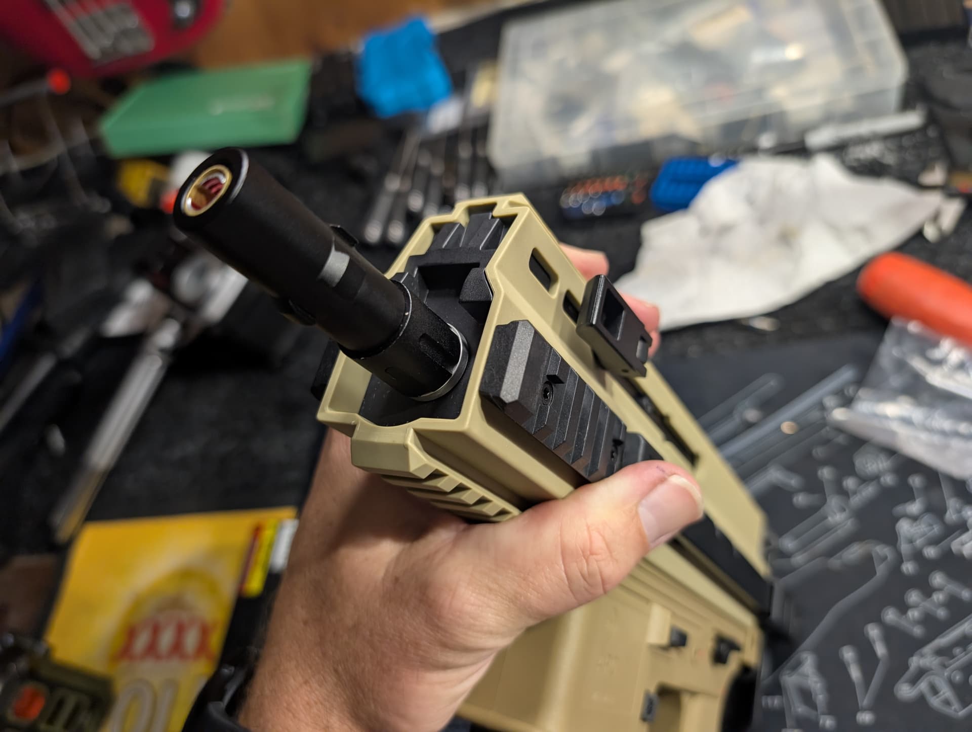

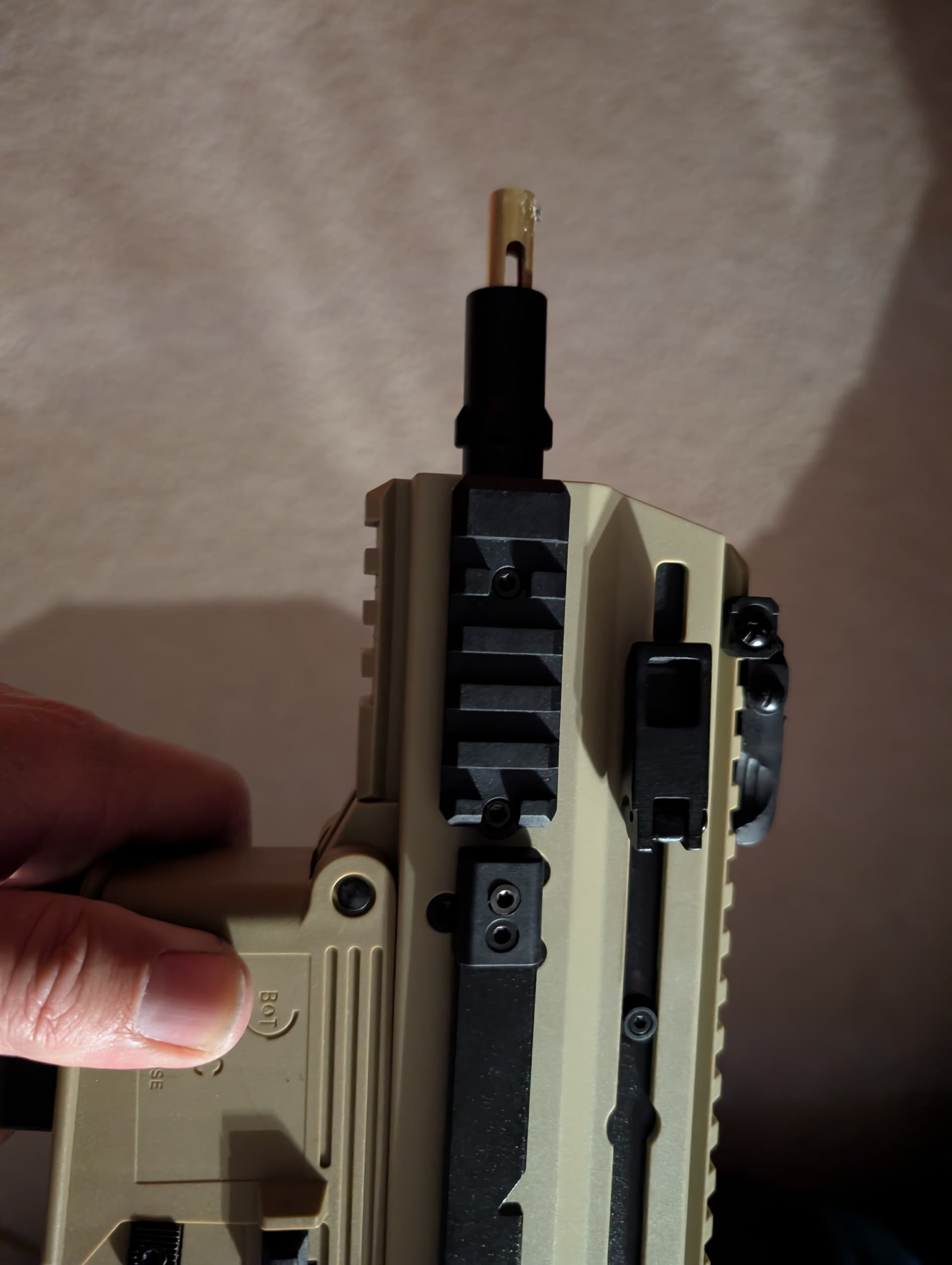

Got a pic, with the hop up.?
:smiley::smiley:
Just took one!
I used a barrel extension and a crush washer for you.
Without it is looks aids.
