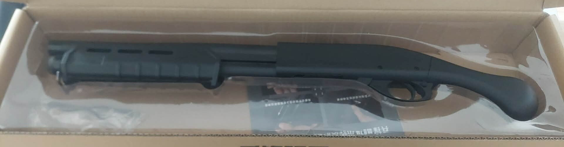

Bing Feng M870 shorty shotgun
Here we have an oldie but unfortunately not a goodie, unless you’re just after a wall hanger.
It has piss poor performance, when you can manage to get it to actually shoot that is. Apparently they were pretty dismal straight out of the box, and the only video I could find on it was in an Asian dialect, couldn’t find any other information on upgrading performance whatsoever, aside from Google AI’s way wrong information talking about GBB upgrades that obviously don’t apply to a spring powered gel blaster

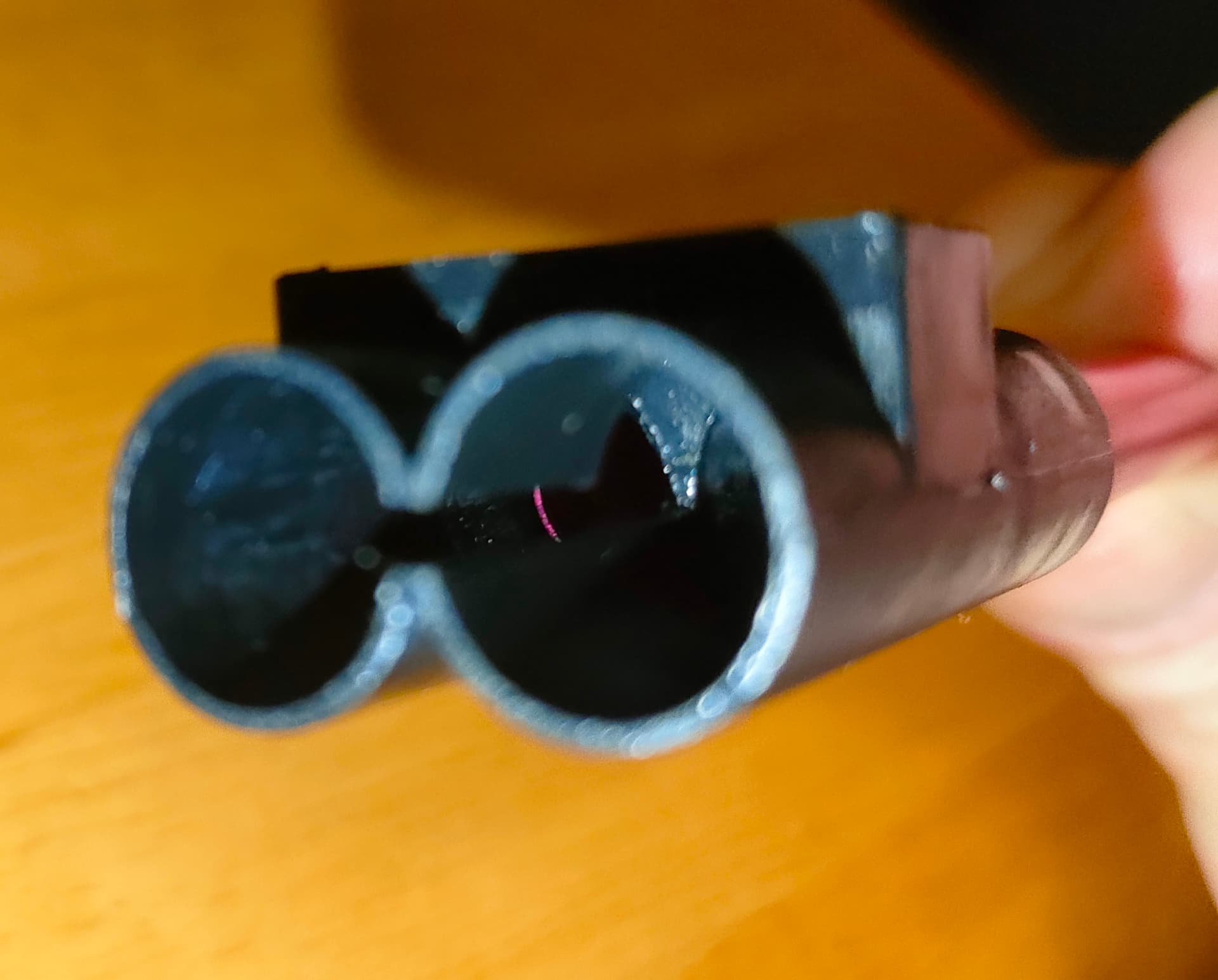

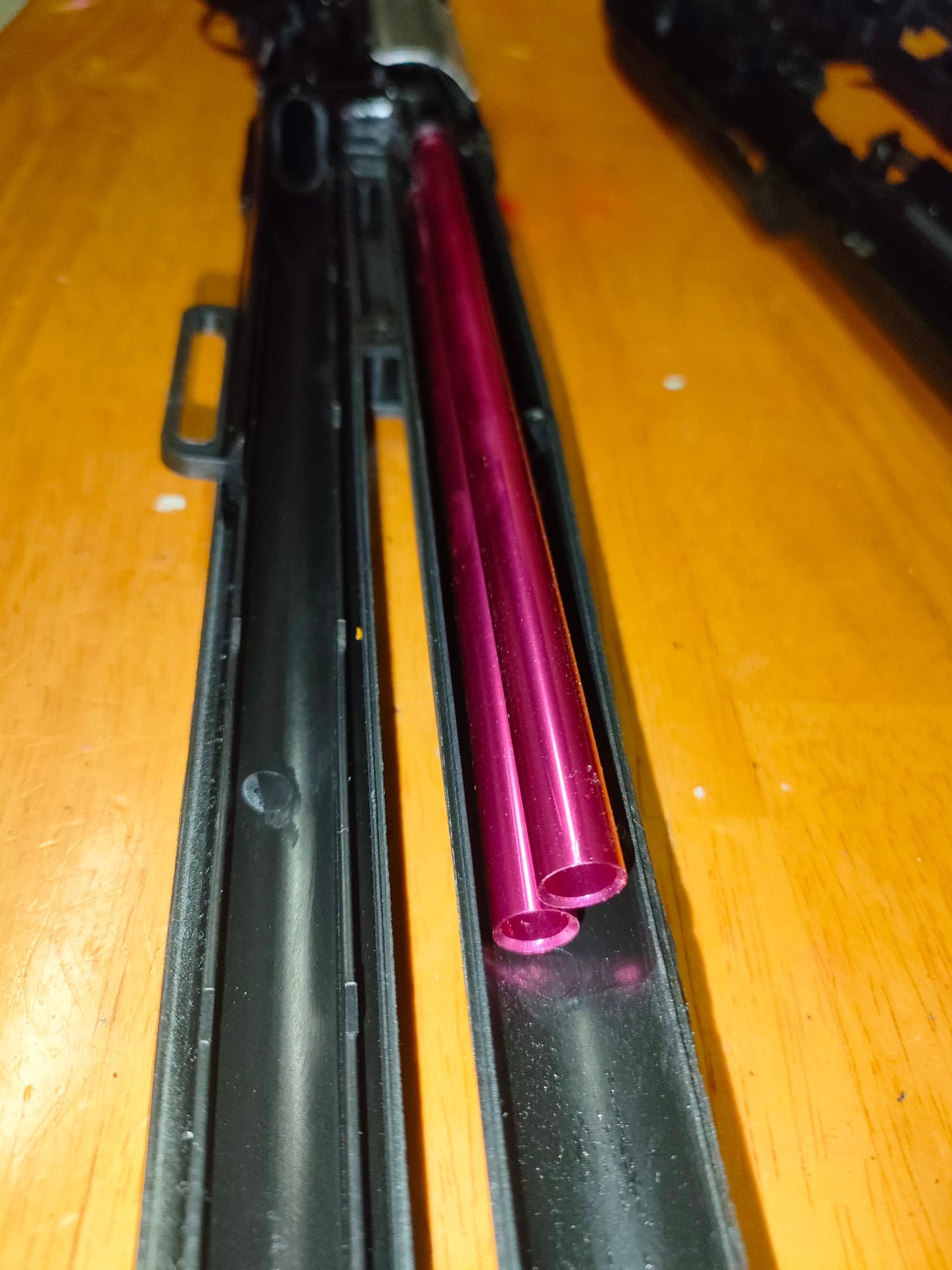

(as it’s a double barrel setup which is interesting and probably why it performs so badly FPS wise, poor seal. Other than that I believe it’s a feeding issues due to its design which is pretty spun out)

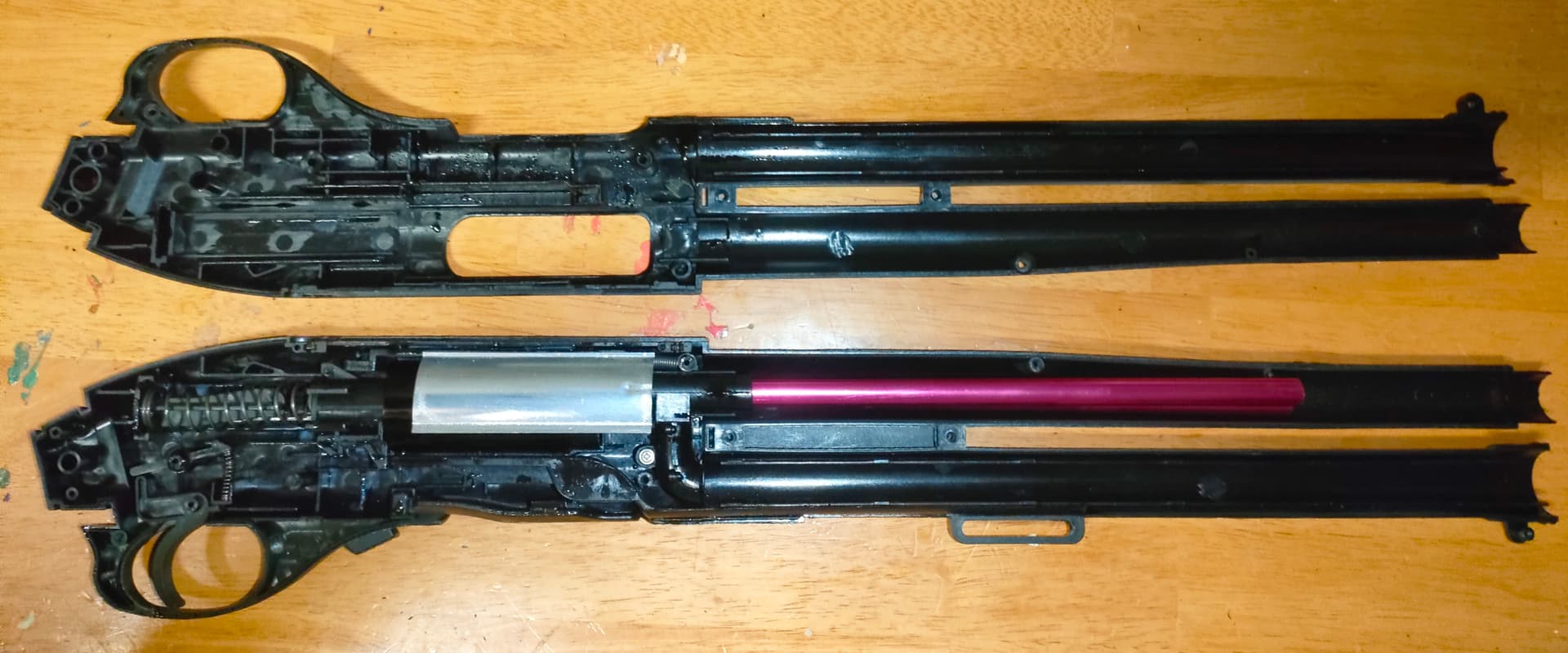

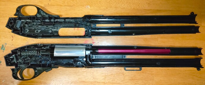

Most likely you’ll just sit there pumping it and pulling the trigger all day with the occasional pair of gels firing out, bit disappointing so I decided to pull it apart to have a look inside to see if there is anything that can be done to improve on its performance, not that I’m an expert in these matters but i figured it’s worth a look since I only paid $10 for it second hand

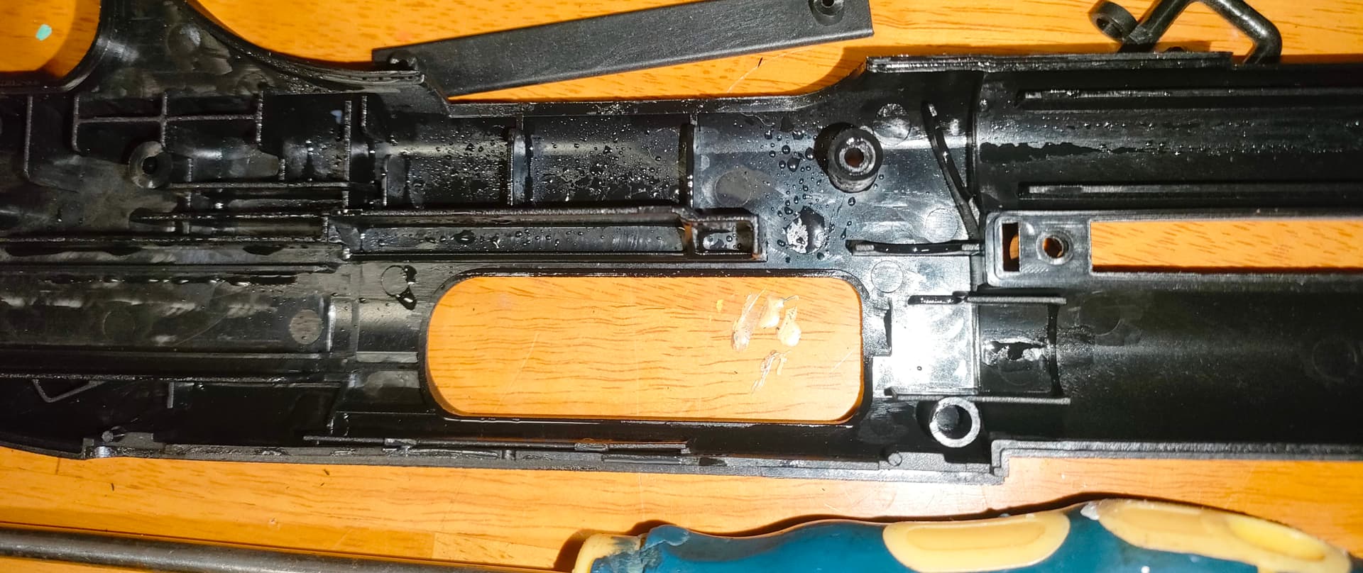

Firstly, it’s waaaaay greasy, and it almost seems as if it’s been submurged in water and not left to dry properly as besides the grease and oil, mine literally seems to have traces of water all through it :grimacing:
Good old second hand market :sweat_smile:

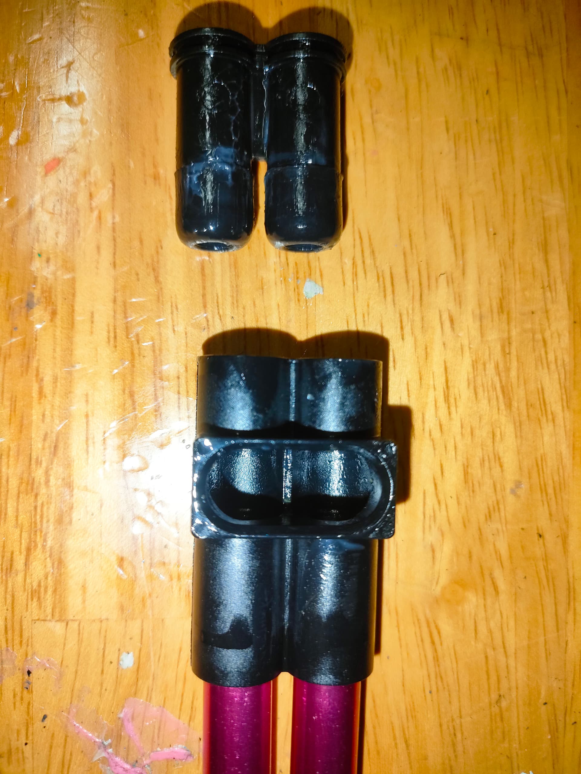

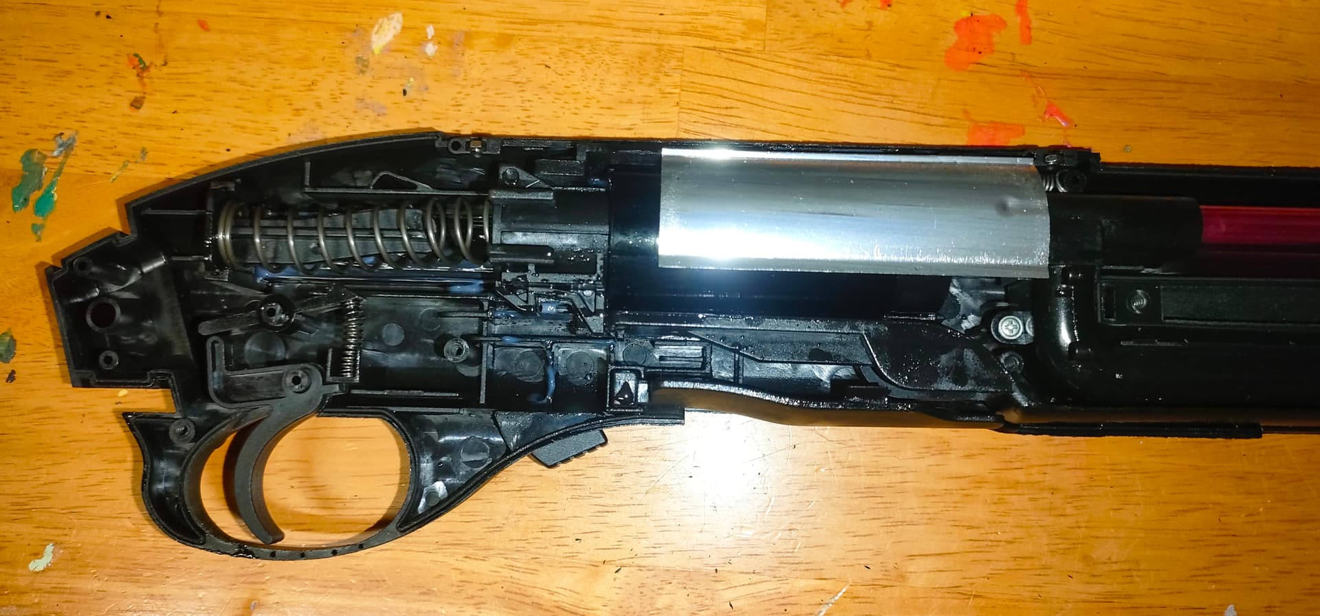

Internally it doesn’t seem much different to Hanke m97, operating with a fairly similar principle, minus the fact it’s magazine loaded not “hopper fed” like the m97 and it’s double barrel design, which I think was it’s downfall

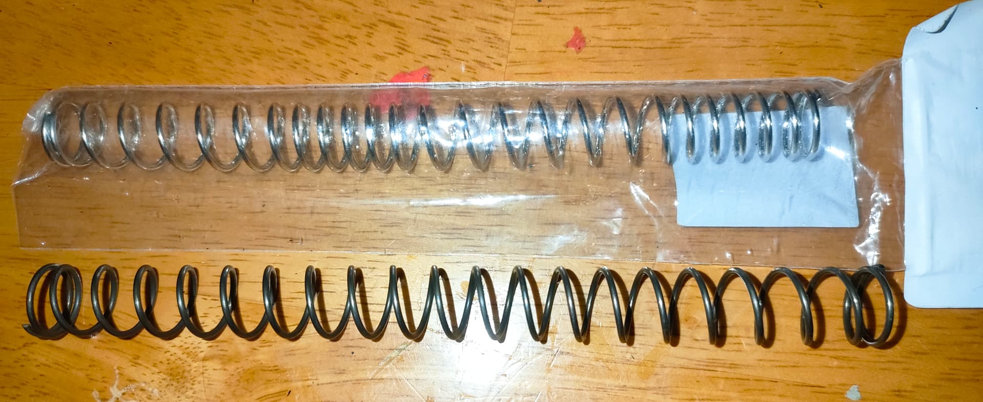

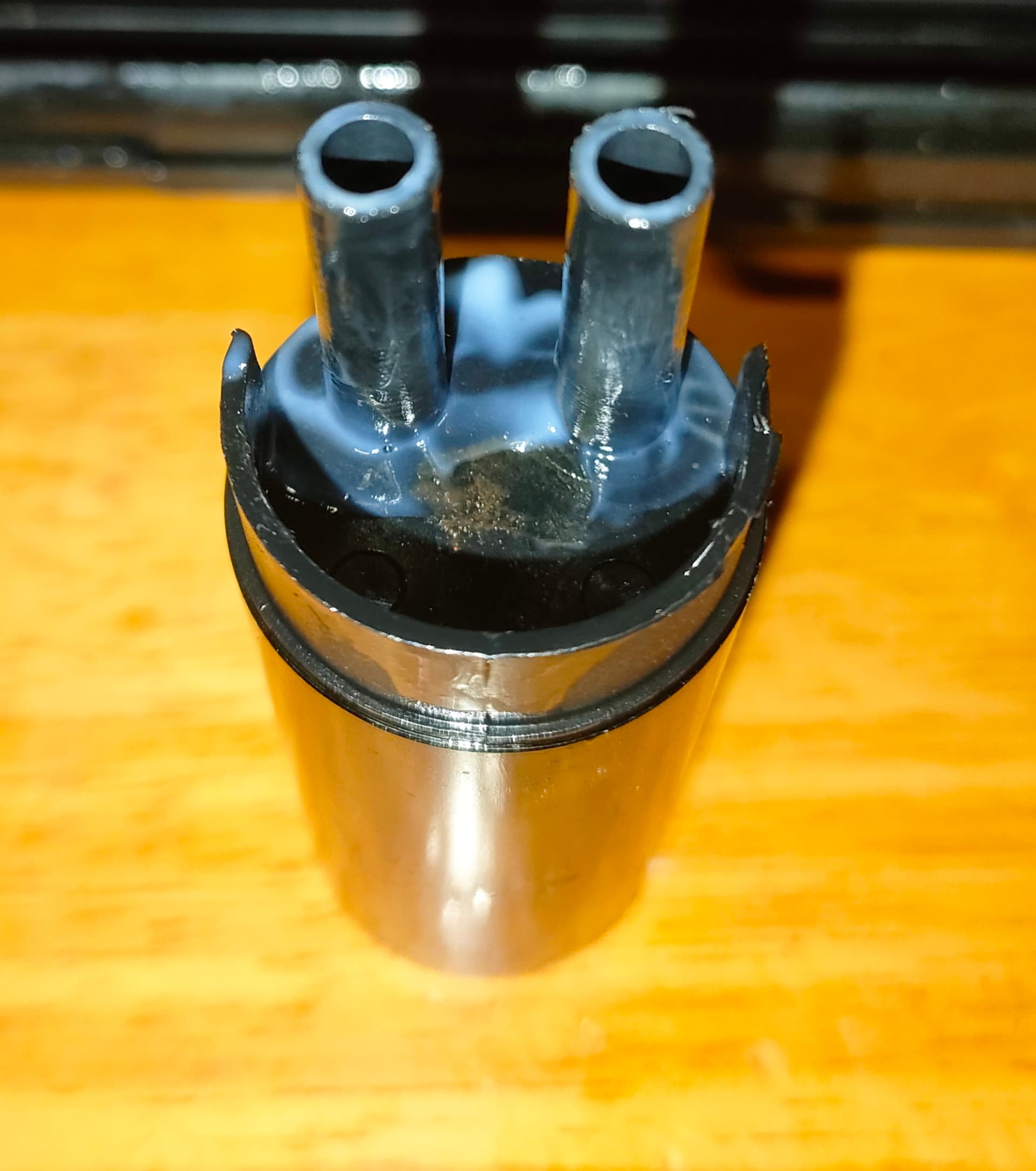

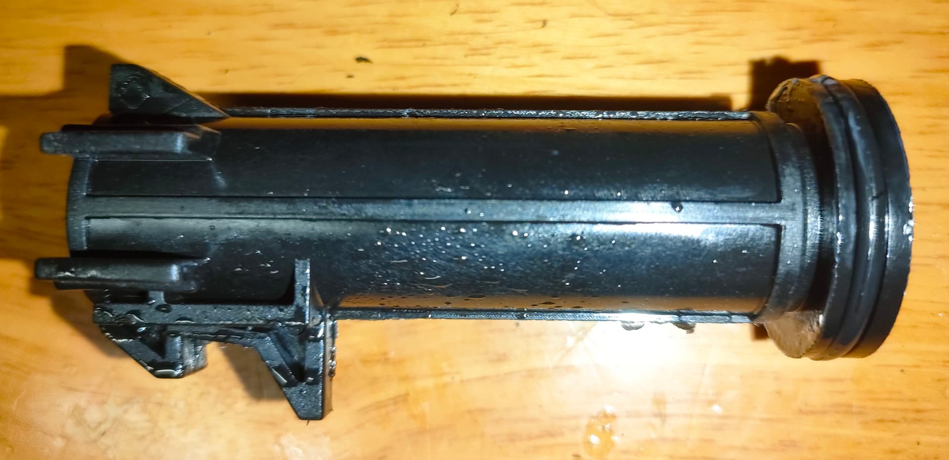

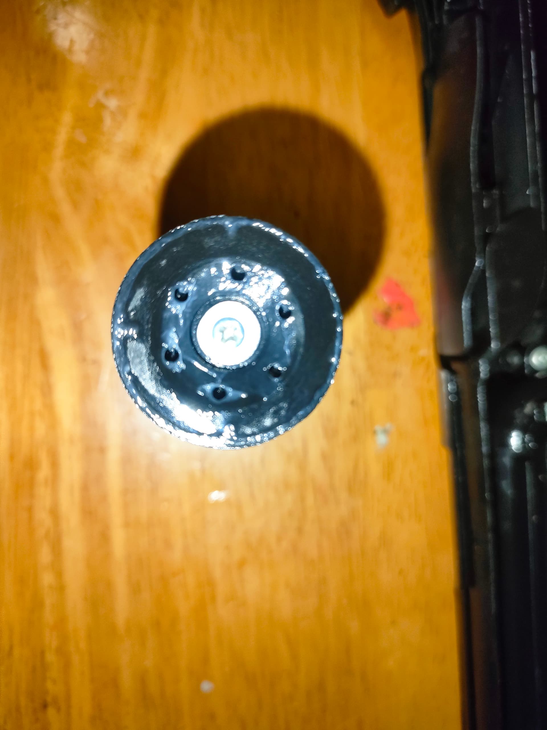

It has a decent sized aluminium cylinder and vented piston head so you would think it would perform better than it does when it does actually shoot, then again, pretty weak air seal at the T piece as far as I can tell

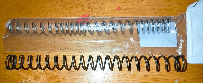

The spring it comes with is pretty chunky, next to an m90 it’s slightly longer, I would hazard to guess it’s either an m95 or m100
The spring next to an m90

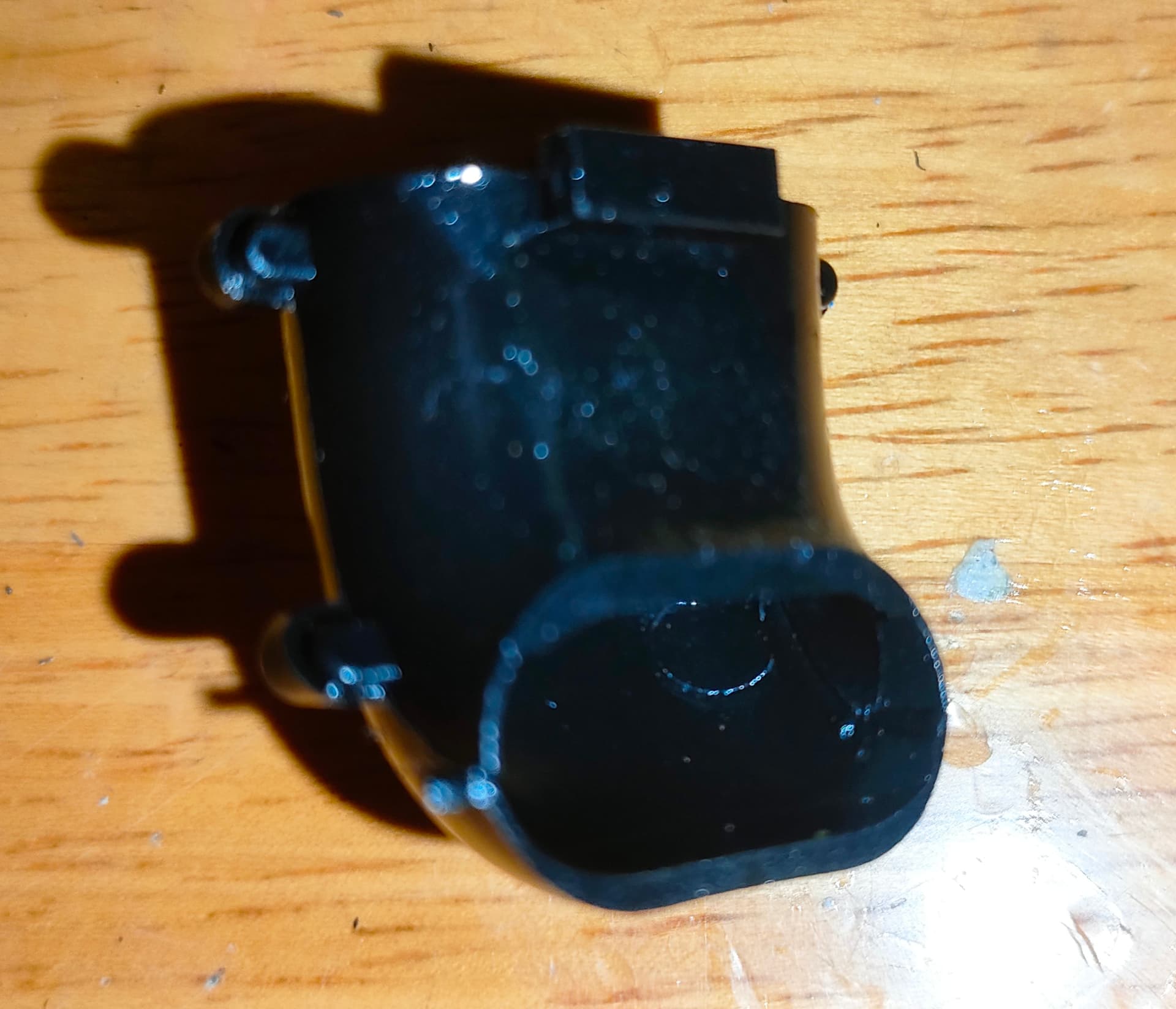

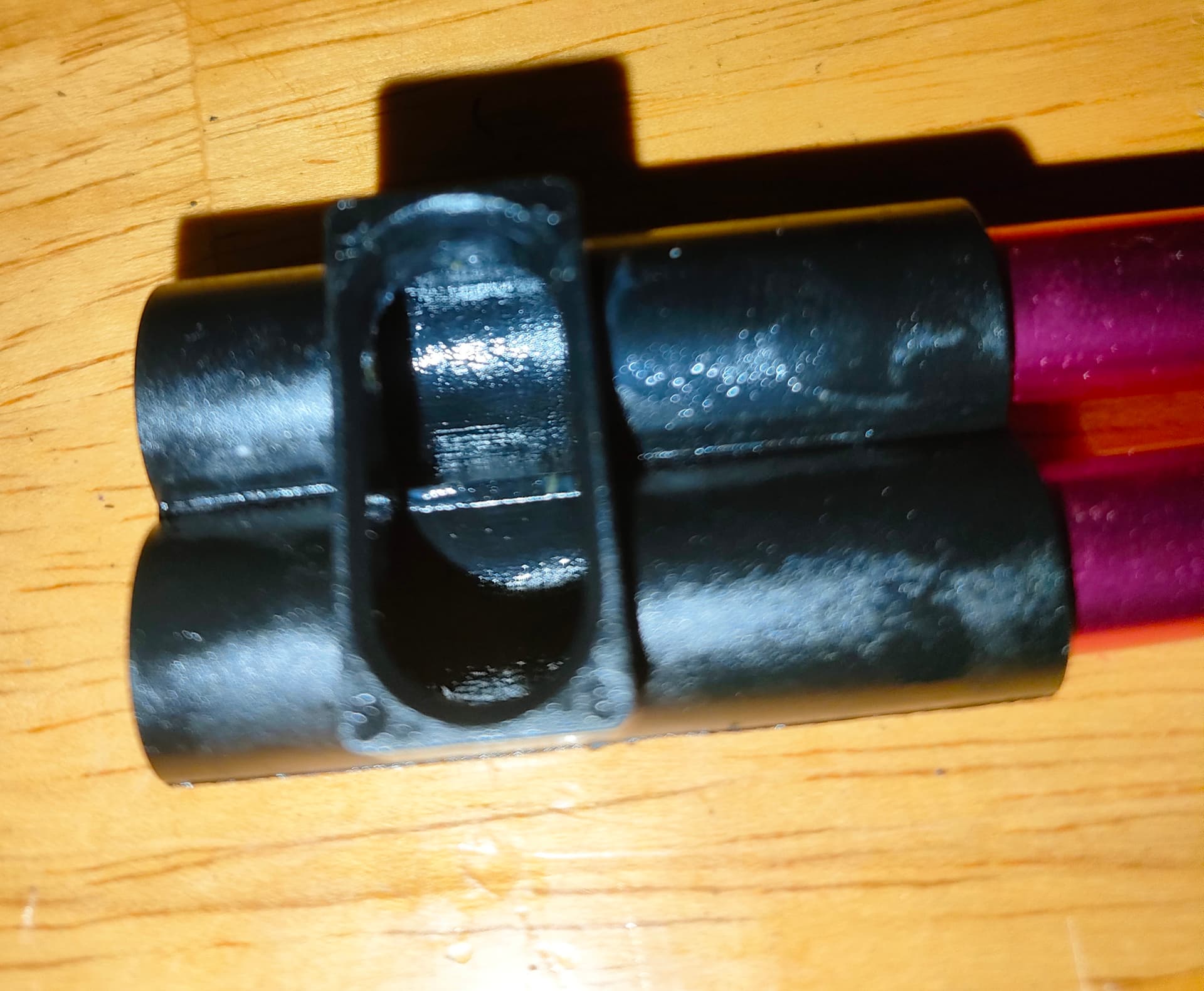

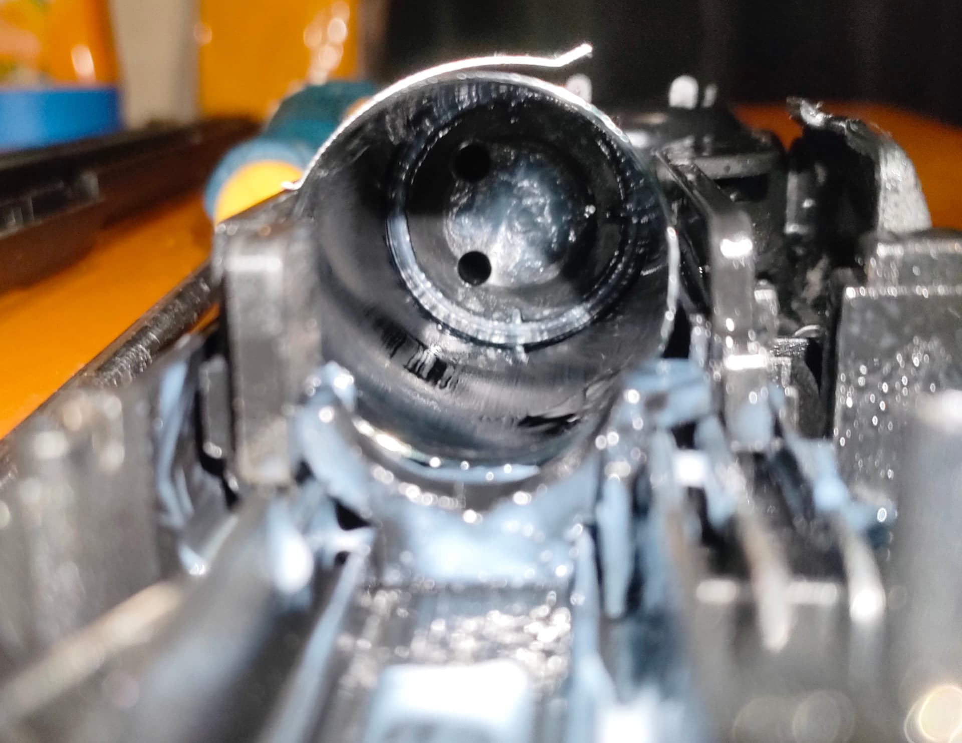

I feel like it’s biggest issue is the gels feeding up the t-piece, it’s like it’s not aligned very well where the magazine meets the bottom of the T piece, or maybe it’s an air seal issue, either way you’d still have to pump it a heap of times before the first gels reached the chamber regardless, but you can sit there pumping n pulling the trigger and pumping and pulling the trigger for ages and the gels rarely feed up enough in the T piece to allow them to be fired

That spring, can’t be compared to any M-rated spring, purely as material, coil spacing, diameter, and length all play factors and it is all unknown. Way back when everything was rated in mm wire diameter, I had 1.2mm springs of similar length out performed by 1.1mm springs. Anyway, unless it is M-rated, its a random spring.
Best way to check is to place it on a long screwdriver on some scales and compress it to where it would be at rest and at compressed in the blaster. It is a lot of hassle but only real way to check the pressure it will provide.
Probably an o-ring and checking the t-piece to nozzle and cylinder head seals are the best place to start, but also checking gels are being pushed by the “magazine” and have space to get chambered is in order too.

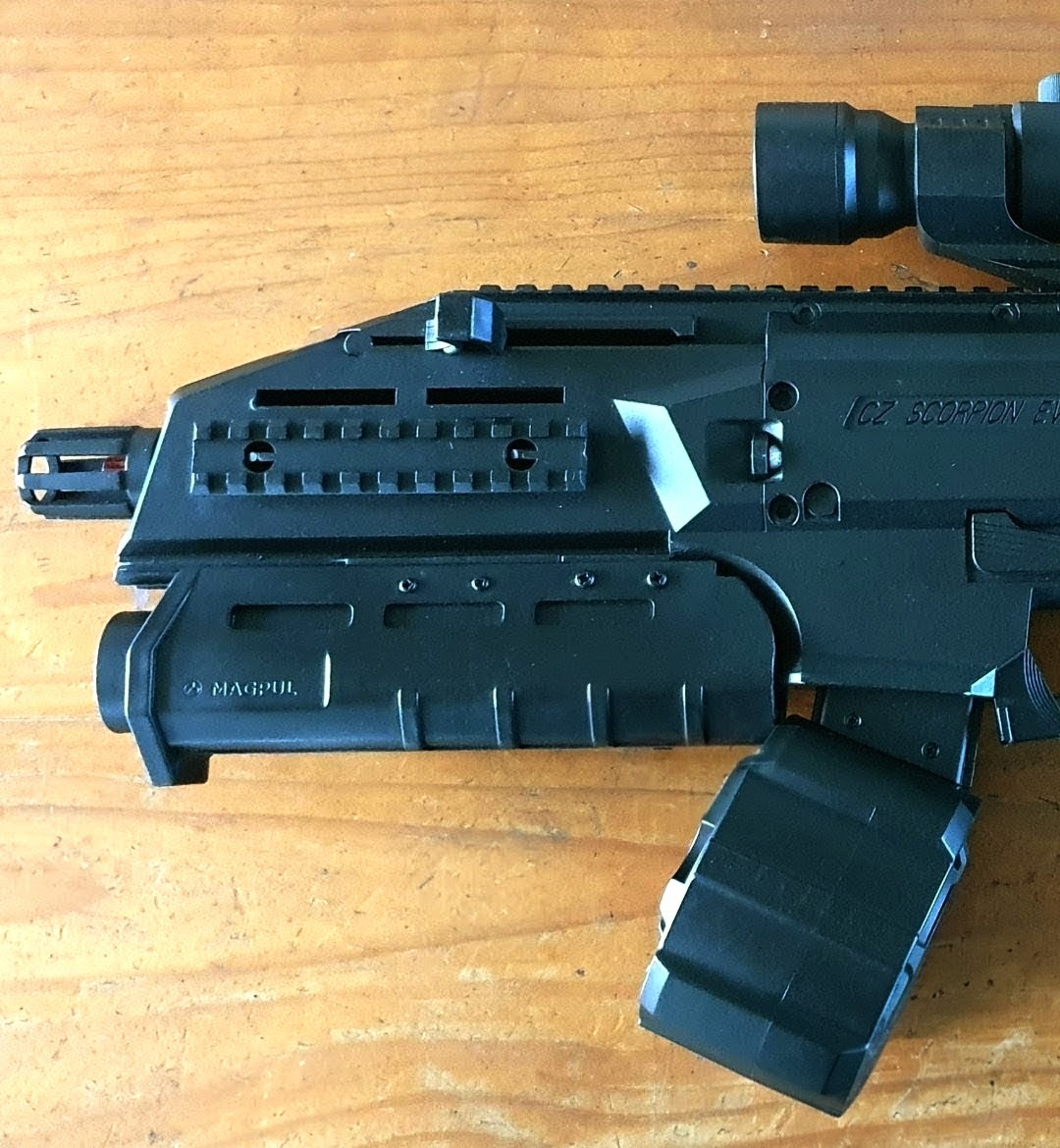

I fabricated my own divider for the first one I had out of acrylic and it was a lost cause. The best use I could find for it was to use the Magpul pump slide as a battery box for my forward wired scorpion EVO. :rofl:
