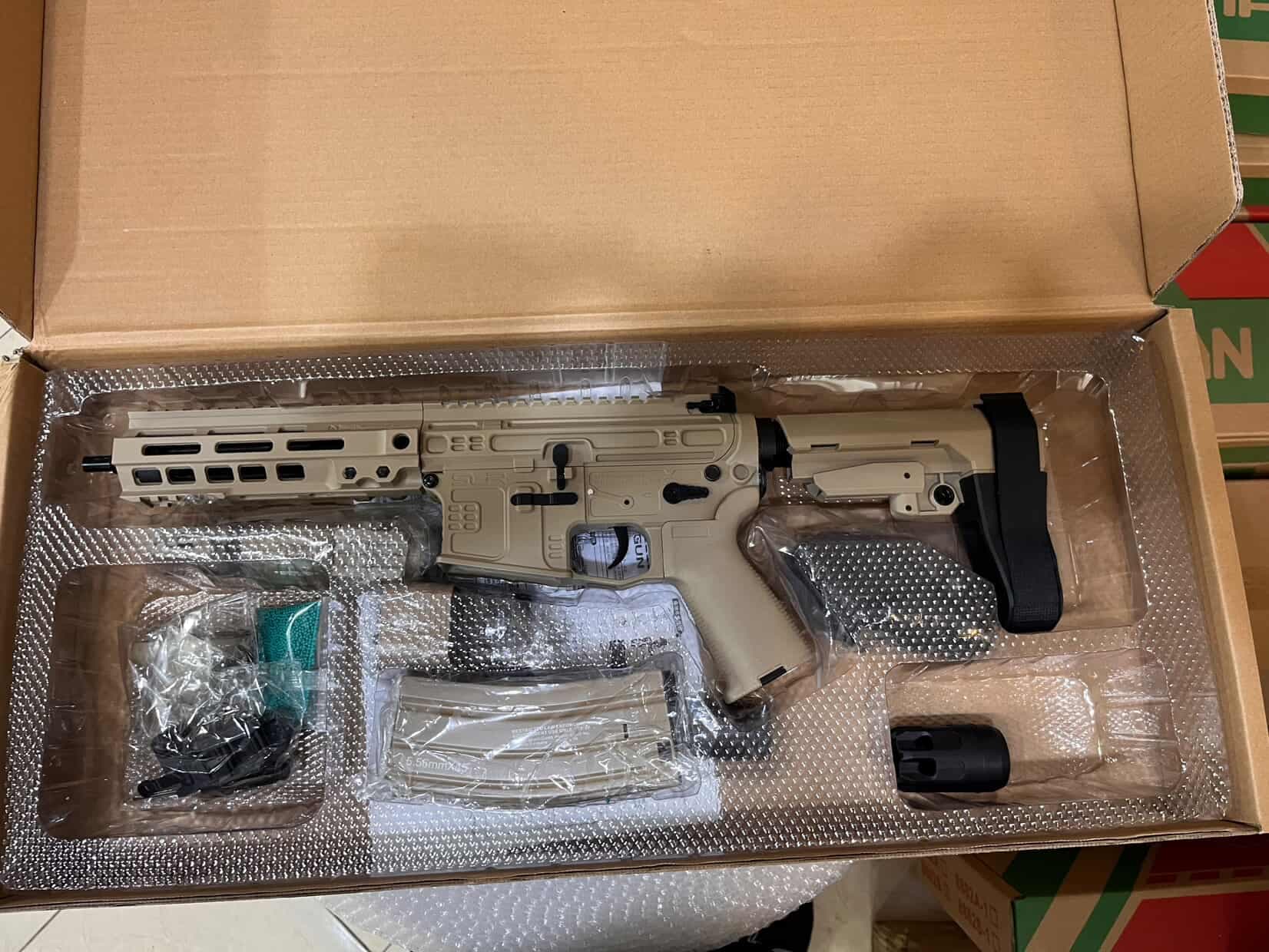

first impressions is that it comes with accessories and even a suppressor ! nice
then , metal magazine . weren’t the bohan slr rifles all included with nylon mags ? ( we have version 2 that comes with nylon magazines also )

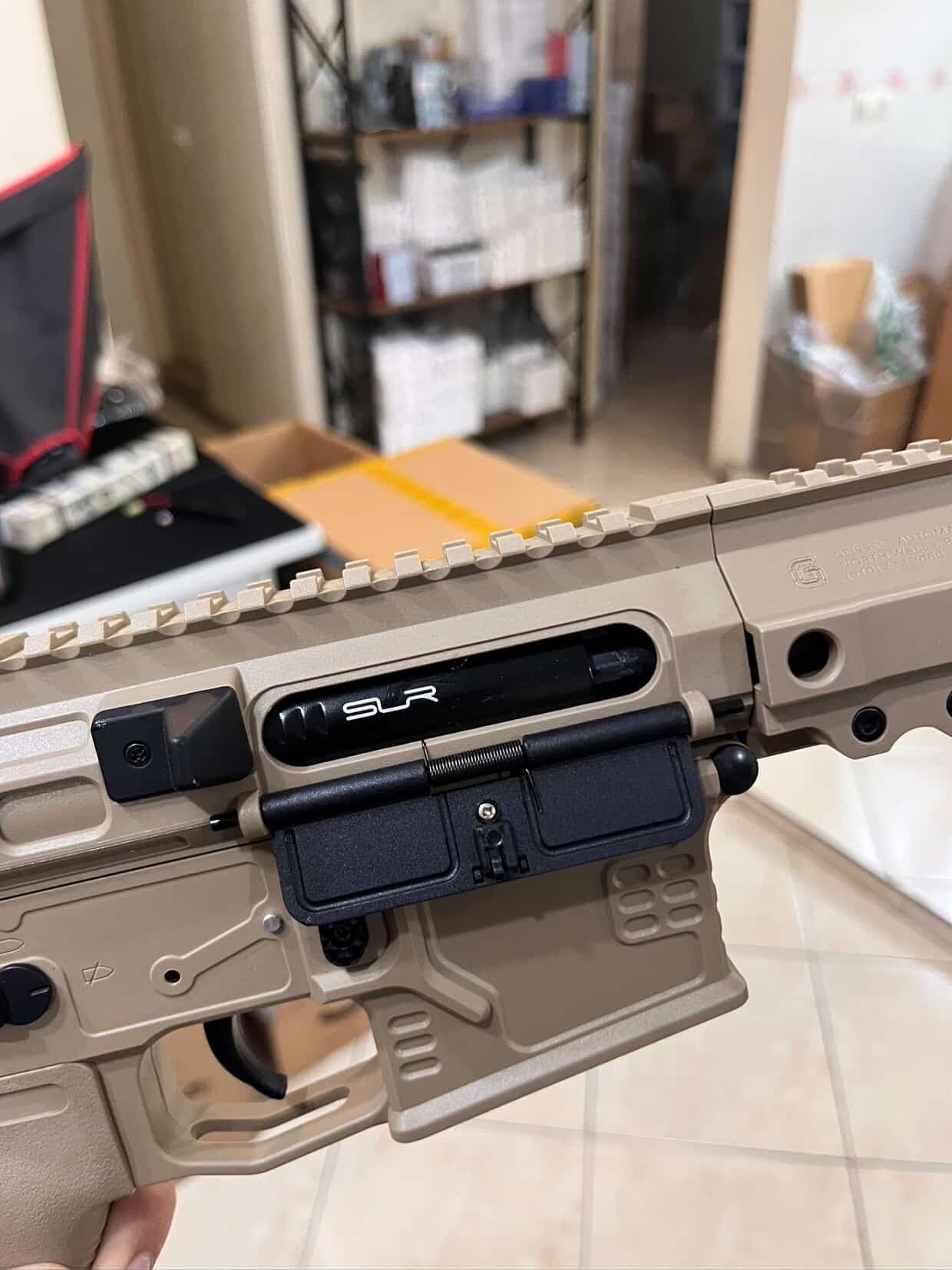

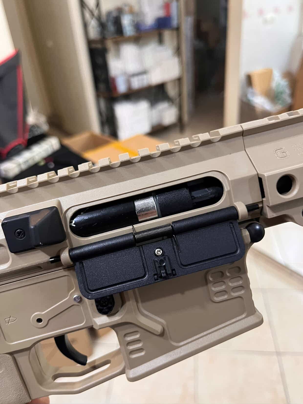

this has bolt catch , blowback functions respectively

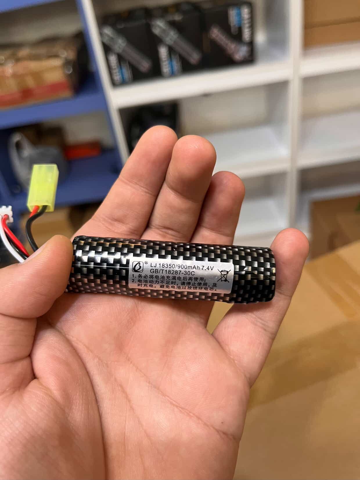

also another thing is the battery is mini tamiya i think as shown in the image

dunno that blowback will snap or not , but the seller says the gearbox and the blowback problem is solved in this version , they say its a version 5 but this looks alike a version 2

For slr from bohan brand, for example bohan slr V3, it is true they come with built in mosfet? And if an ar is using mosfet, can i just use a regular 11.1V battery? Because my friend said i need to use the XT30 battery model if the blaster use mosfet.
I just use this battery for my previous slr
Having a mosfet does not mean you can use an 11.1v.
The rest of the build needs to be able to support the extra rate of fire and stresses.
Now… most blasters will handle an 11.1v in stock for for a time… how long depends on the blaster and how it’s used/abused. It’s just a risk most of us take.
My advice is if you are going to use 11v, be prepared to repair or upgrade it at some point.
Either through getting parts, knowledge and doing it yourself or by finding someone you trust to do the work.
hey man , sorry for late response
mine doesn’t have mosfet and the blowback’s thin so never use 11.1 volts outa bohan
or you need to replace blowbacks , gears , motors and maybe even the gearbox at some point as @RokSolid said
well buy a jingji slr v4/v5 if you wanna chuck that 11.1 volts on
