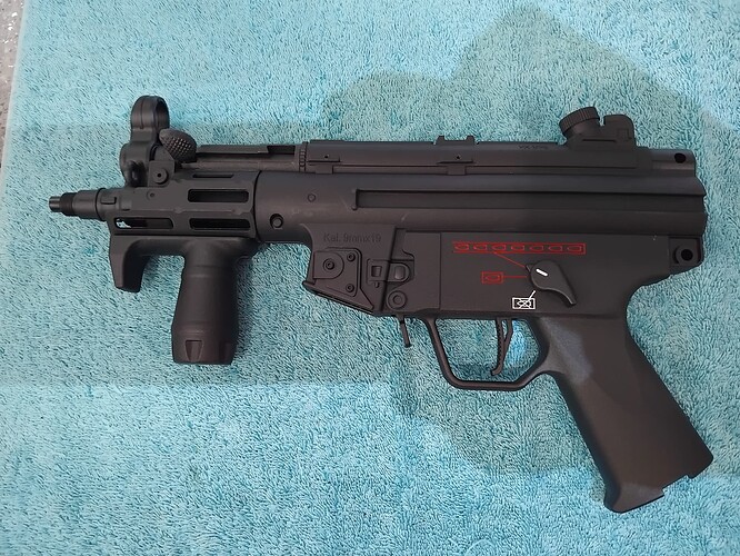

This is a budget blaster… $130 from cybertrigger.
From the outset, i know it will be similar to the MP-9 performance…
Small proprietry gearbox, with limited upgrade capability.
Still, what caught my eye was all the cool accessories.
A few little tasty extras.

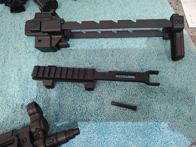

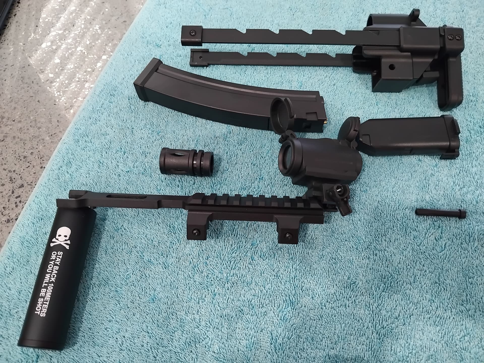

The blaster is kitted out…upper Pic rail, multi stage extending stock…
Look at the Bitz, ya Getz…!!
With the exception of the supp… that was mine…
It has a 14mm ccw thread, and the birdcage is tight friction fit.
The upper Pic rail is nylon, but works just fine…and fits properly.
The multi stage extendable stock, is the star of the show.
I haven’t seen one of these before…and yes, they do fit JM MP5’s…
They do rattle around a bit, but that is part of the design, and unavoidable.
they pull out step by step easily…and retract just as easily. Locks in well.
Overall, quite stable when out.

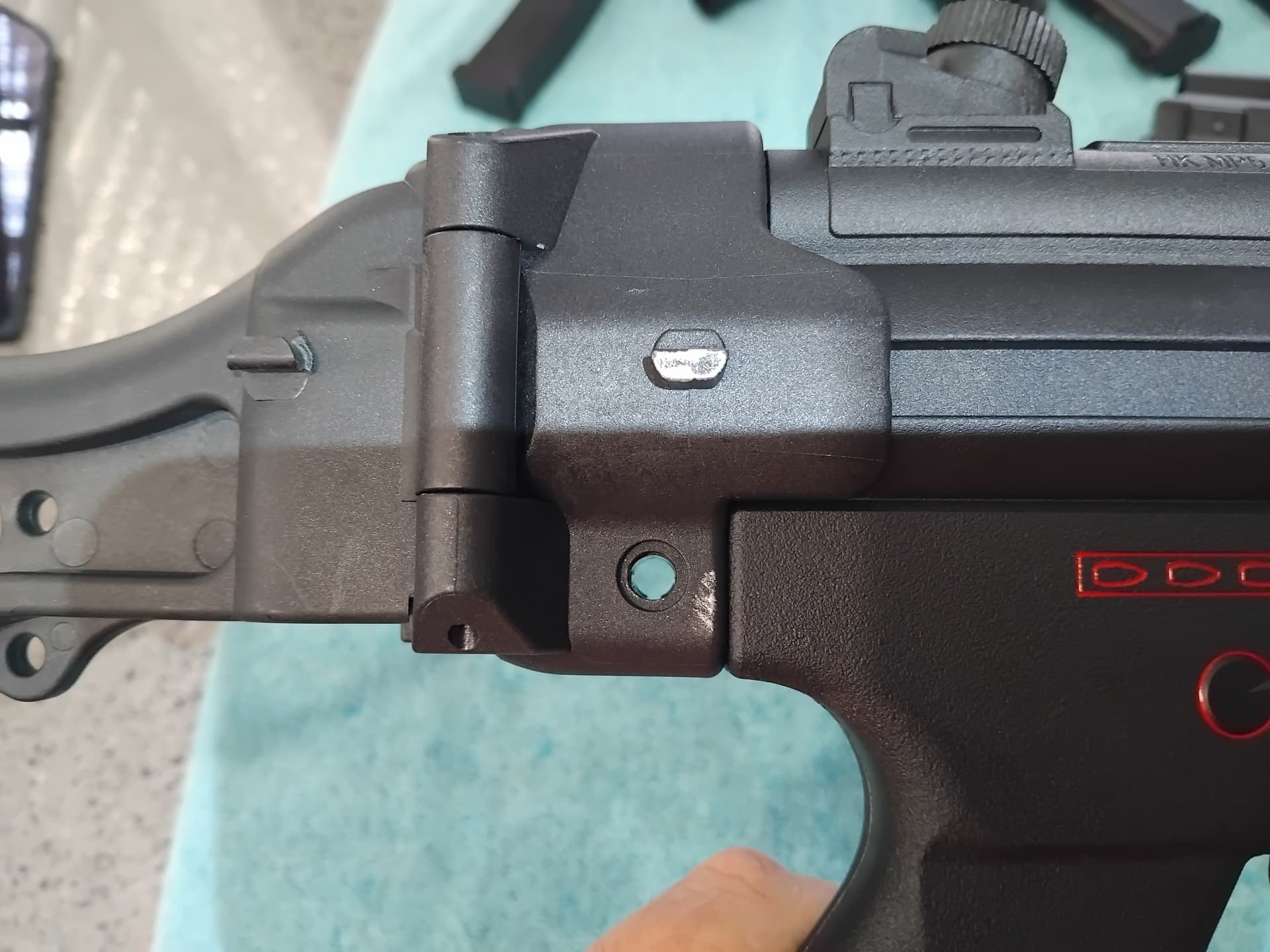

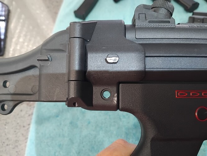

Bit of a tight fit to get on a JM, but they go on, no fettling , and are toight, toight, toight…!!
Likewise JM stocks also swap over…

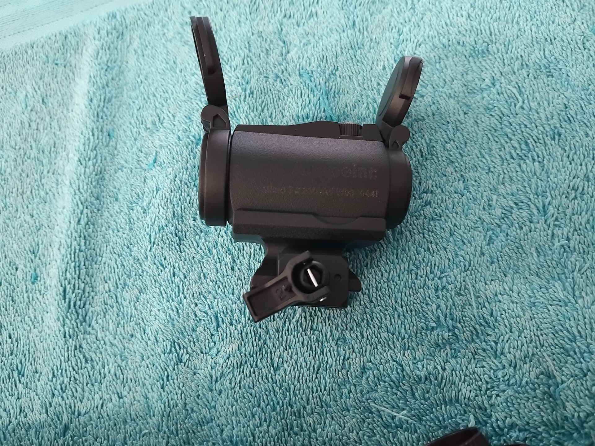

The red dot is a fake, but looks the part.
I painted over some of the text…it was quite bold and stark.
QD design, and all plastic…it serves its aesthetic purpose.

Fully Nekkid.

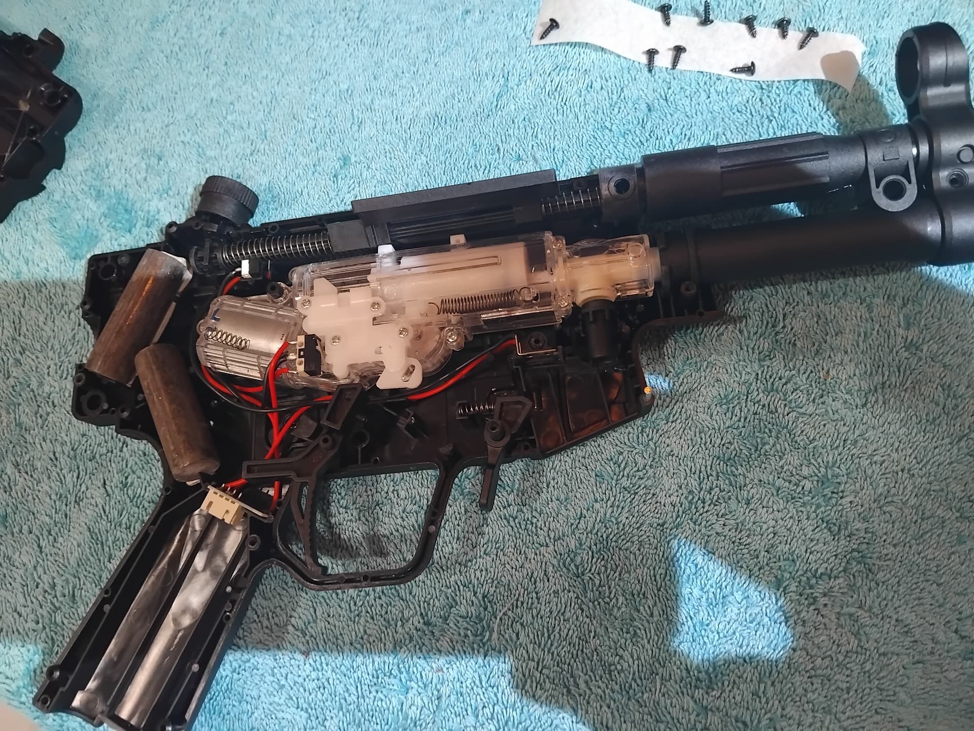

Its a clamshell design, and will get pulled down…tomorrow…
Its a combo nylon/ plastic jobby…pretty decent, and light weight.
Less weight than the JM, so probably thinner, less beefy shell.
Its quite adequate though.

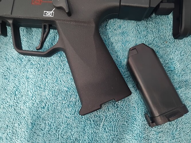

Battery is 11v, proprietry, and goes into the handle…
This rules out V2 gearbox use, so expecting smaller combined motor / gearbox.
It has a charging handle with mag prime, but be careful with it…no HK slaps, its thin nylon.
Magazine capacity is small, and coupled with a 11v battery, it goes through it quite quickly.
They have spare mags, at $15.
It does have blowback, that will be disabled. It also has a transparent plastic gearbox…you can see the piston cycling.
The rail is decent, stiff nylon, and holds weight easily.

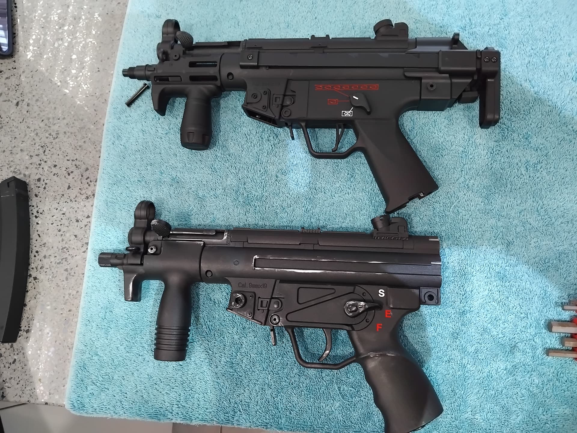

Size wise, its all the right dimensions and shape, compared to the JM.

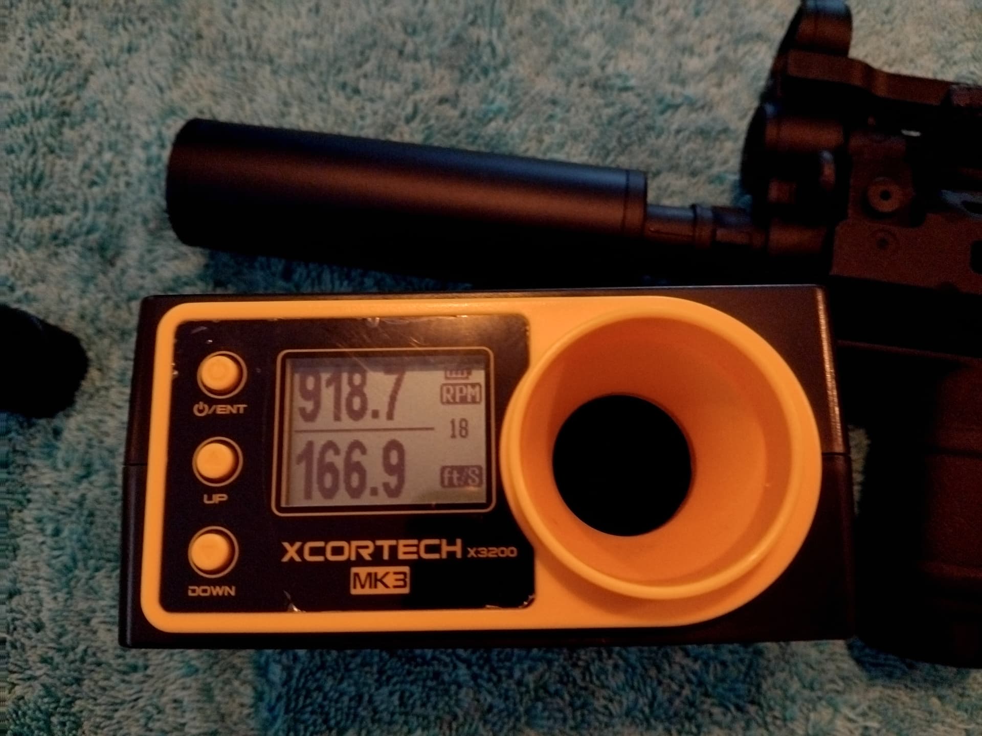

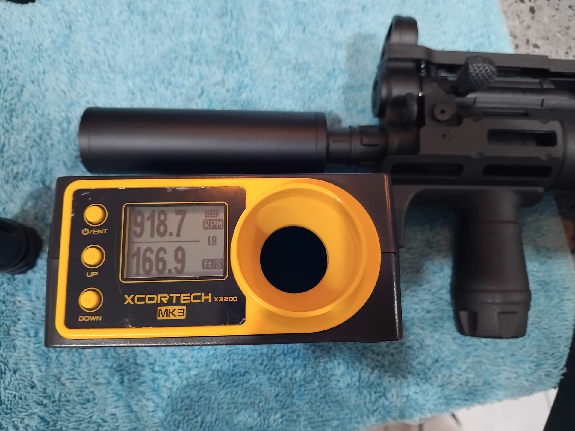

So, how does it go.?.?
The big question…
As you’d expect…
160-170 fps. Nothing awesome…yet.

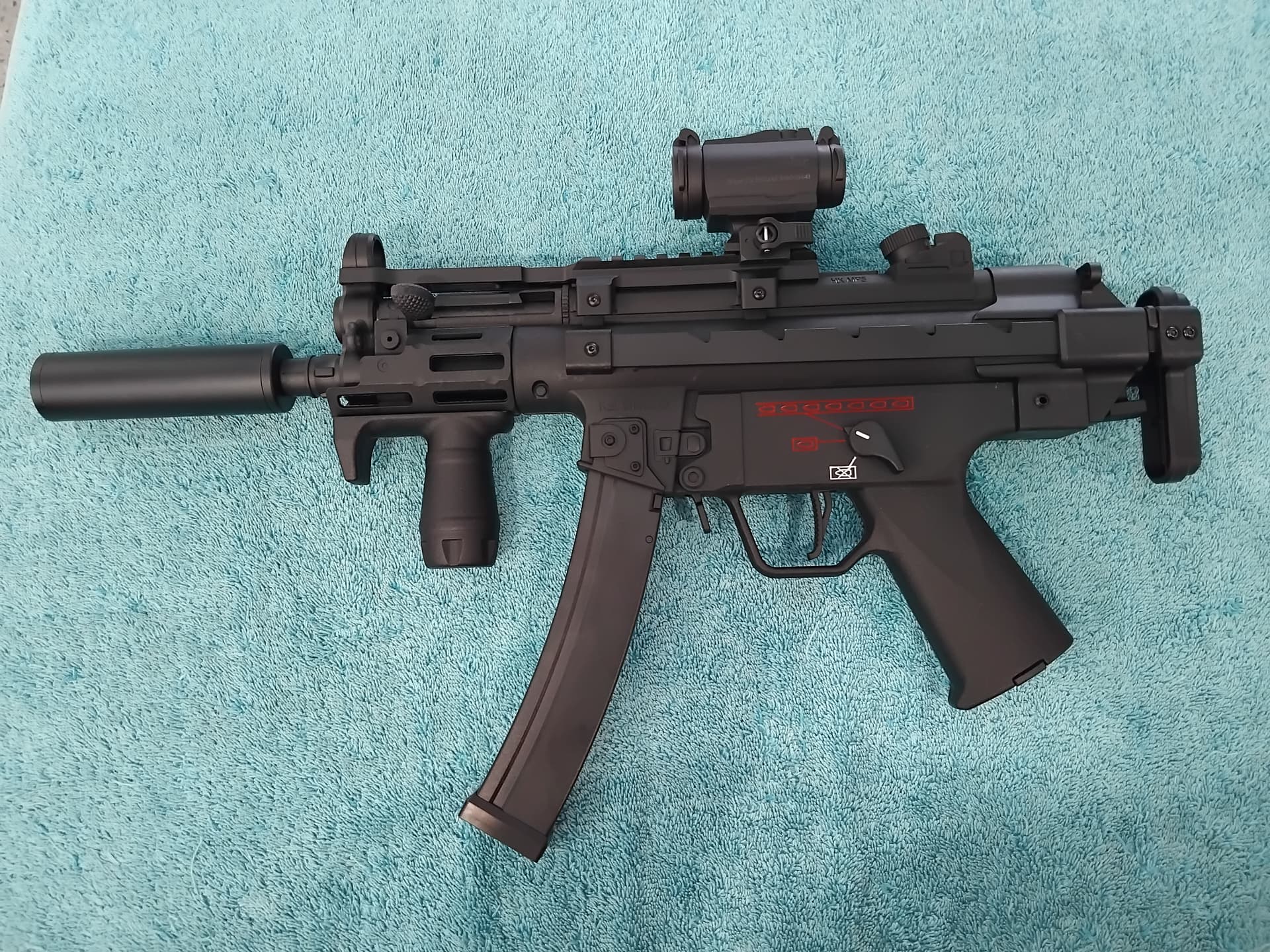

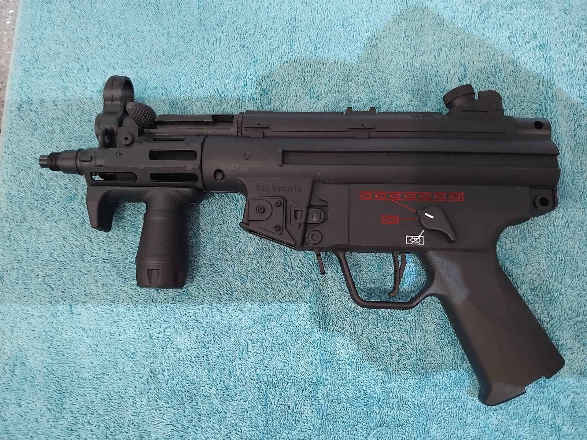

Presto-changeo…!!

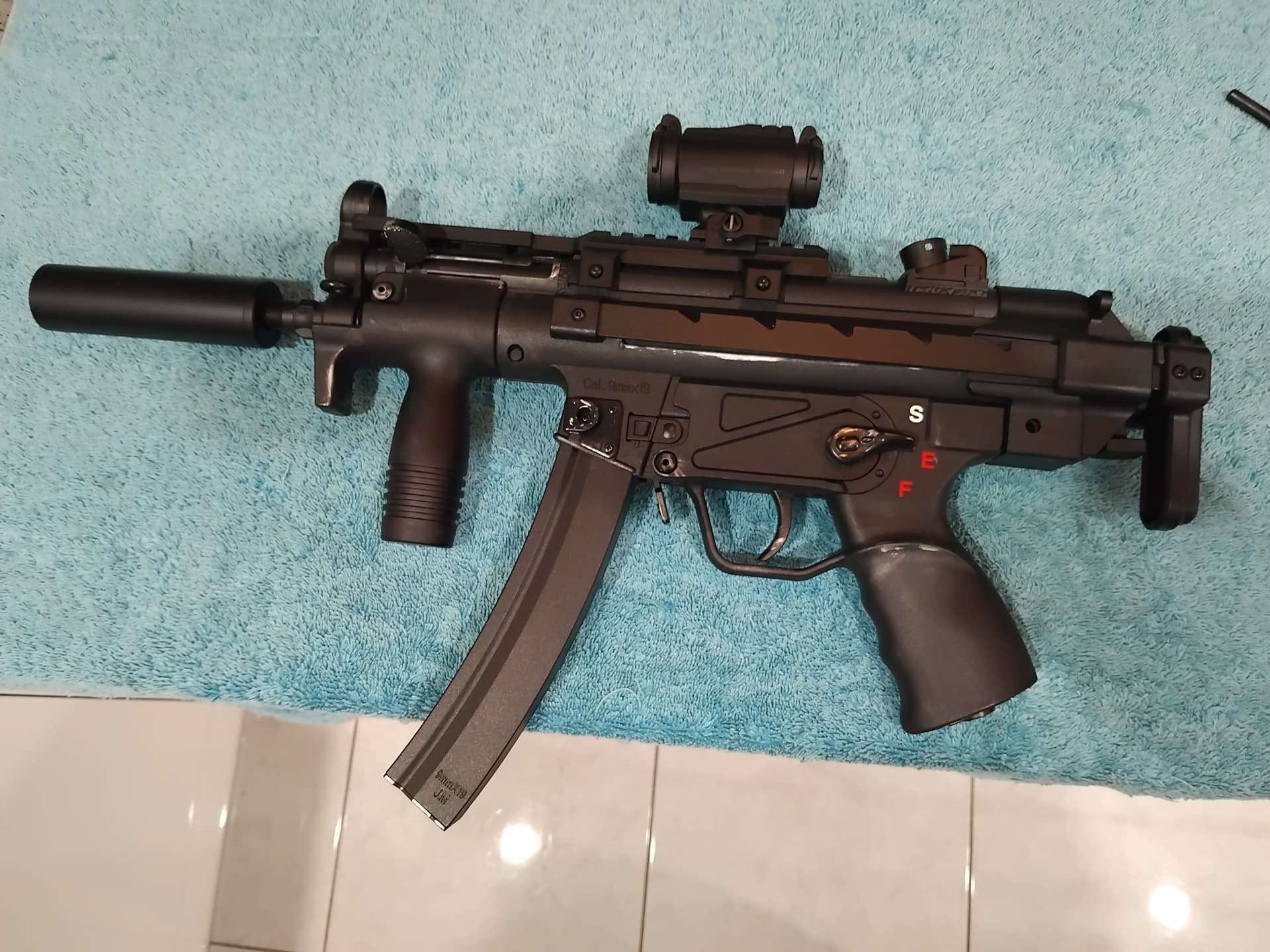

JM transplant complete.
All the bits, on the JM
For any JM’ers, contemplating the accessories…
Its all a good fit.

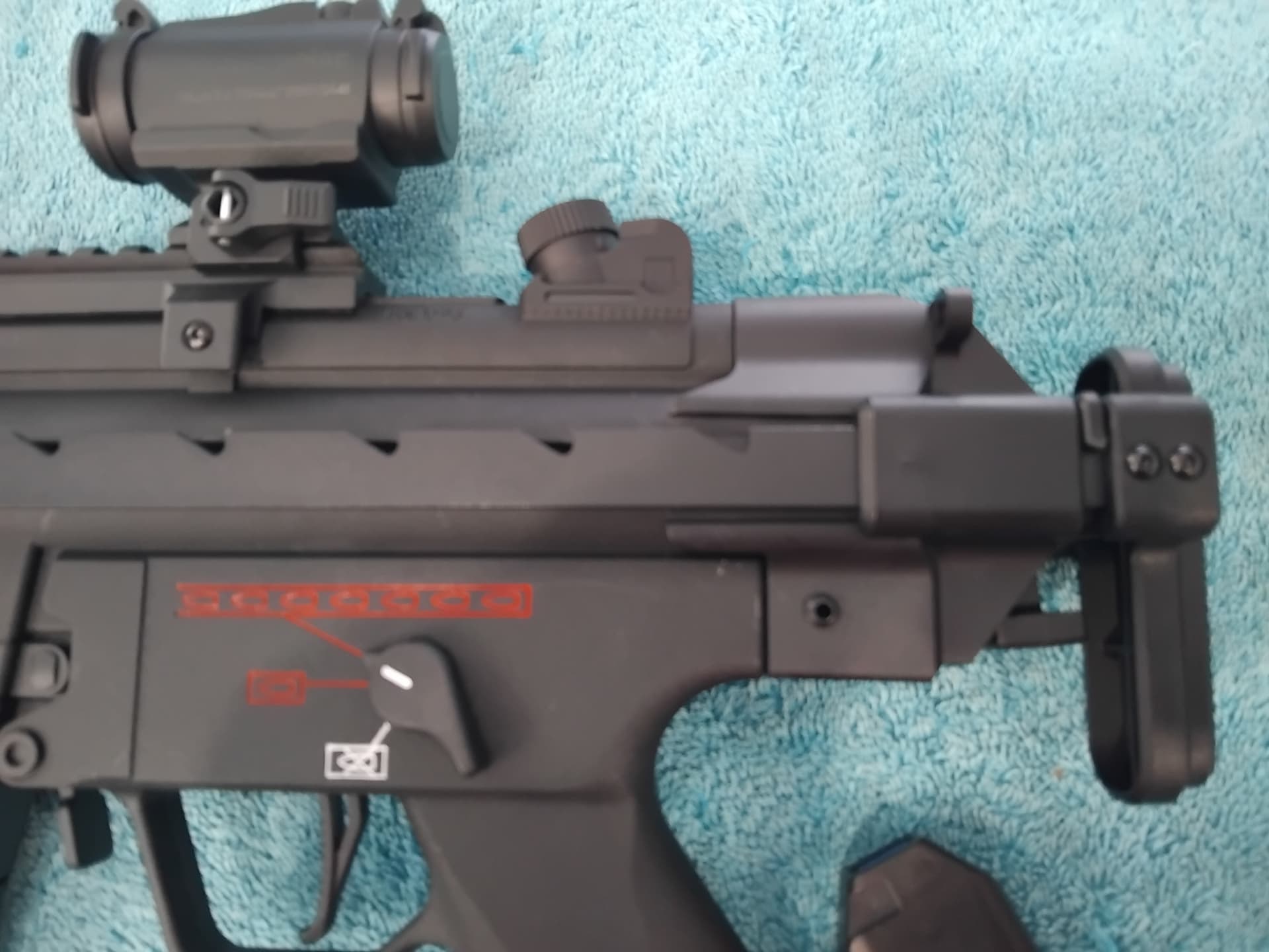

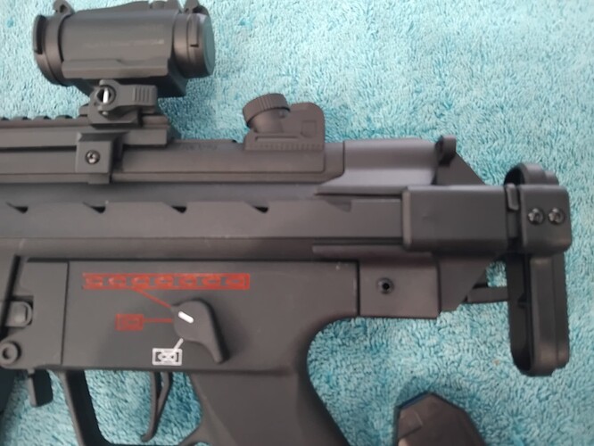

The Rear stock is a good tight fit. Don’t even need the pin.

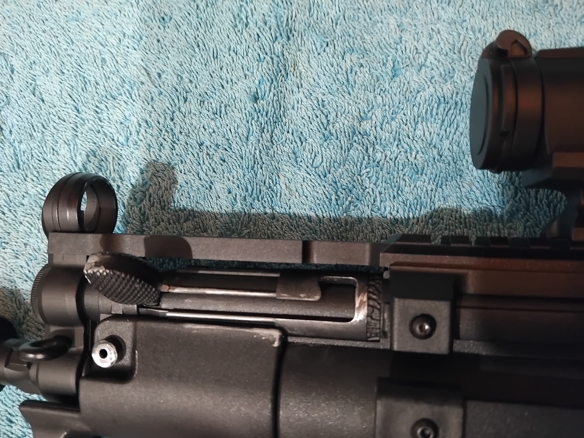

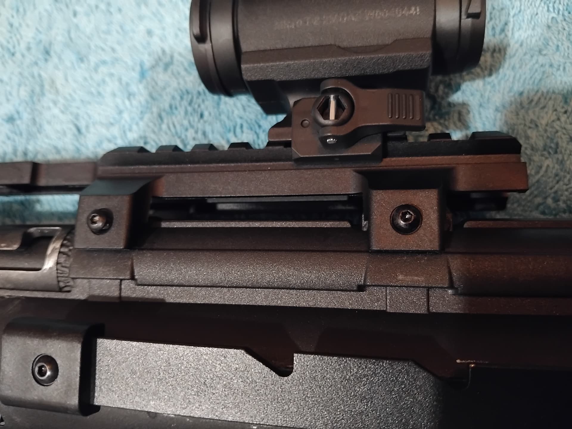

The top rail fits perfectly on the JM.
It fits into the slots on the JM frame.
Sitting just above the slots, in the pic above.
When its on, the front rest and front sight fork all line up properly.
Its all held on by 4 allen key screws.
The cheapy model has 4 holes drilled.
You could use them as 4 grubscrews, if you dont wanna drill holes in your JM.
Alternatively, you could use some hot glue, to hold in place temporarily.
You can get all the gear, on a JM with better performance.
If you consider it a accessory kit, with a spare kids blaster, you wont go wrong.

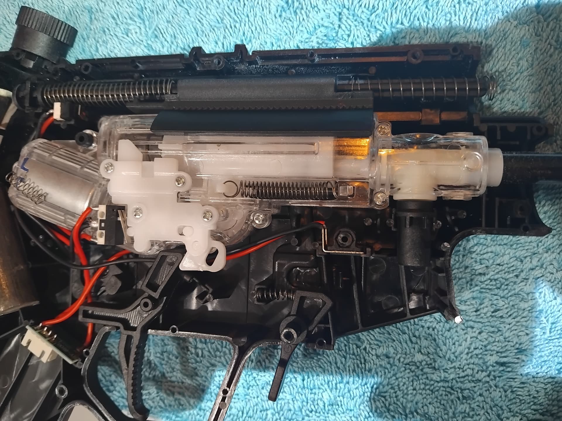

Tiny motor, small gears, small cylinder volume… not much to see here.
Nothing a M140 wont sort out…!!
Broke out the dremel, cut off the tabs for the blowback.
Have to actually cut it right down to the shell to get clearance… and a bit off the plate as well… but got there
Quieter now.
So, as expected from a ultra cheap nylon jobby… 160 fps it is, a-la tec 9.
