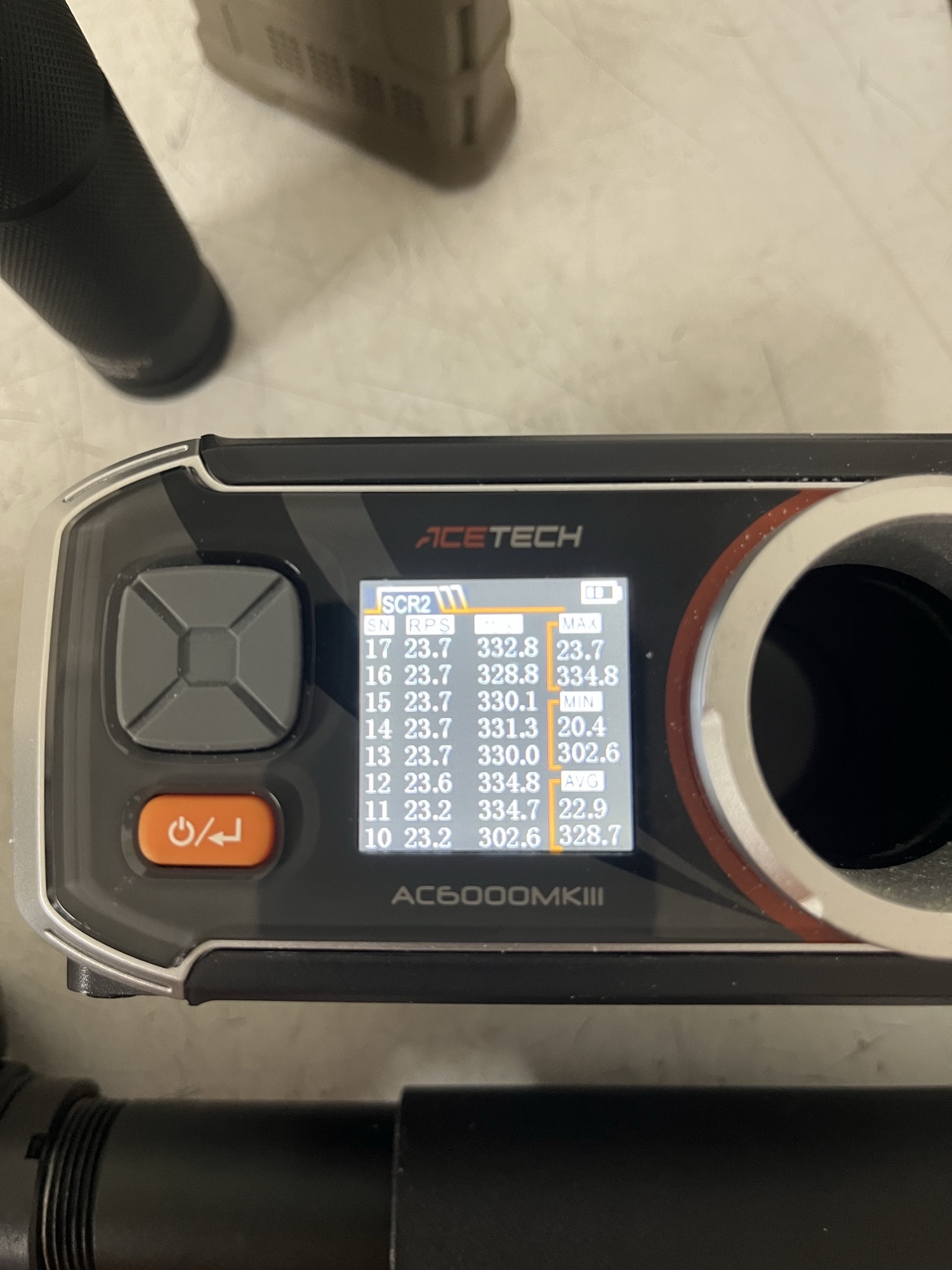

Benefit of this model over others is that it gives you FPS and RPS in the same screen
Mine is nearly 9 years old… And this is the one I am considering to get to replace it, but my ancient Acetech one wont die!
I’ve got the old (very first) ACETECH 6000 Bluetooth, as it was the first to display all that information on one screen, plus the ability to scroll through other types of screen readouts as well.:ok_hand:
Interesting to see that they’re now up to a MK III version, but hey, if you’re onto a good thing! :grin:

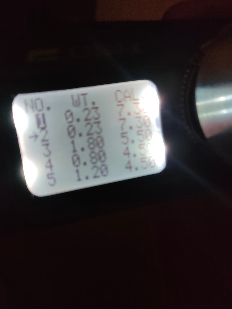

If you get the el cheapy from AliExpress, E9800x , the top settings are for gel, courtesy of @Maiphut
Wt = 0.3
Cal = 7.3
Requires going through the manual to find where to change the settings as stock standard it’s setup for 6mm bb
Can I just shoot and it will read correct fps of the object flying thru it. I can do weight fpe calculations on paper.Just looking for reasonably accurate velocity readings.
With the el cheapo I don’t think so, if it’s going off the wrong weight and size I would assume it wouldn’t give accurate numbers, when I go home on Monday afternoon I will have a look at mine and run through the steps to set the correct weight and size, it’s not too difficult, but you definitely get better readings with the more expensive chrono and functionality, eg my cheapo doesn’t read as well during full auto bursts compared to the expensive chronos
The size and weight “should” only be for the chrono calculating joules, something that in gel is only a curiosity not a unit measured at fields. In Airsoft where there are 0.2-0.5 gram projectiles it is a factor.

Chrono is a valuable tool, recommend a decent acetech. Mine is nearly 9 years old and I’d bet I’ve used it way more than most people would and it still works. The battery is getting very poor but I’ll likely just solder in a 18650 to replace the tiny single cell lipo it comes with.
The one sold by X-Force will be my next chrono though, having the rps and fps readout on the same screen is very handy for diagnosis of miss feeding.

Definitely wasn’t the case with the el cheapo I picked up, when I first got the chrono I was using it with my mp40 and the results were all over the shop, inconsistent and low
After getting the settings sorted it was all g
However I have no doubt with the better quality chronos it was a different story and much more reliable straight ootb
