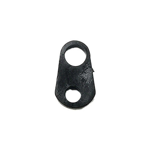

They are almost a wells, but not. Their gearbox is pretty similar but is a bit different, but they do share some parts like nozzle, cylinder head, cylinder.
If you have it open, does the sector gear have a “delay” chip?
I use quotes as it is as much a sector delay as it is a tappet travel extender of sorts.
Ausgel, $1.50.
They do increase the distance the tappet travels slightly, might not have one installed from the factory. The nozzle will move but not quite enough without it.
That said, if changing to SHS gears you do not need the chip in my experience with wells, but classic army are slightly different despite being very similar.

I think that sector delay chip will likely do the trick though after reading some posts about them on reddit

I’ll try and remember to grab one of those sector delay chips next time I order from ausgel and wait til he comes down next and get him to bring it down again but that could be a while so it’s a stalemate until then unfortunately

Ooo looky what I found…
apparently specific to classic army
