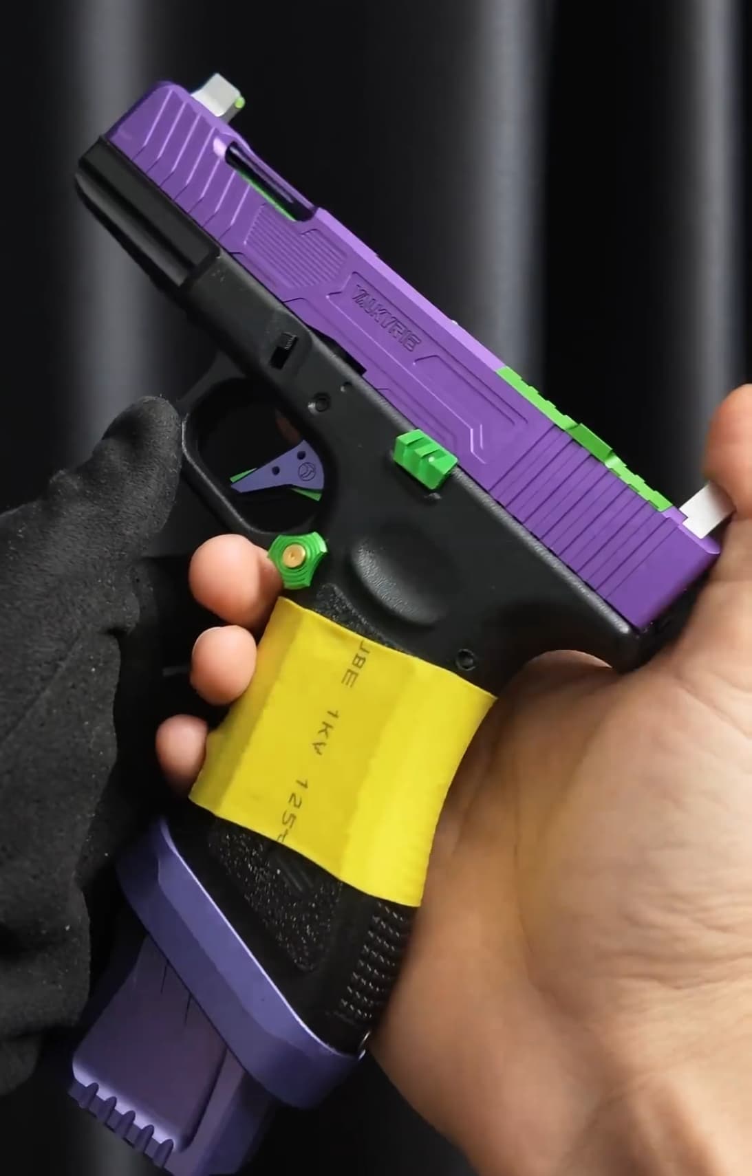

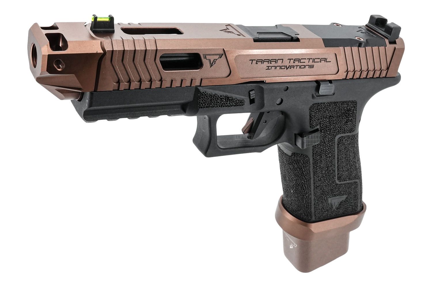

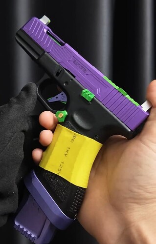

I mean, they are fine in the beginning, but they are two problems with the ZWK or we should just call them reskinned OY g18 at this point.
First problem is with this funky safety function under the main body. ZWK decided that putting a sliding switch in the area of the number plate is a good idea.
That thing will randomly rock back-and-forth and lock your trigger out and turning the whole thing into a brick with the slightest amount of vibration or impact. First week of only it gave me fear of breaking this four digit CNY investment.
second problem is that they constantly tried to remind you that you should not pre-cock the blaster without the battery on a.k.a. the magazine. They also mentioned you should only release the loaded spring with the mag on. I mean, I understand this is a field blaster meant to have maximum RPS out of a Glock body, but still, such design hurts my brain.
At this point, I’m not interested in playing any AEG Glocks anymore.
Mechanical electric pistols seem to be extremely fussy about getting all the motions right to prevent mechanical lock ups and damage.
I found the GBB Pistols more reliable purely through having much less mechanical parts having to work together perfectly in synch to function reliably.:thinking:

QC problems, I think the sliding switch came with a weaker spring enough to lock the trigger, and yes with these OY Glock 18Cs/ZWD TTI G17, the spring can’t be released without the magazine. It is a different structure from OY G17/G34, this is why they have separate parts for each other, they are not swappable. Glocks under 2000 RMB have QC/structure problems, it is best to avoid a Glock EBBP, stick to a 2011 above 2000, maybe the QWK 2011. I know many rare exceptions for a good Glock EBBP, but they are above 2000
GBBs are mechanical, they win in reliability, electric is more complex, after the release of the piston, the motor needs to cycle the slide to lock the piston again, too close timing within each other and the piston will not return properly, and too far timing within each other and it will be a slow trigger response. Talking about the ZWD TTIG17, and the OY G18C, the motor’s RPM can’t be replaced, or else the full auto/binary timing will mess up, meaning no higher RPM, so you can’t replace it with a Chaoli 280 brushless
Not to mention, GBBs are easier to maintain in terms of disassembly, with electric, you have to engage the disassembly lever, then remove the rear slide cover, and then take it off from the front, and when you want to put the slide back on, there will definitely be a small metal piece you have to push down to slide the slide back on.

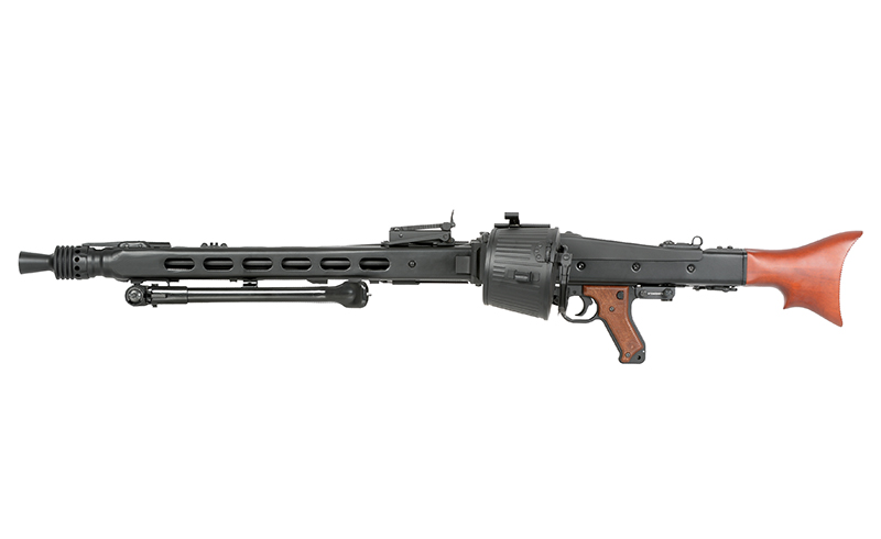

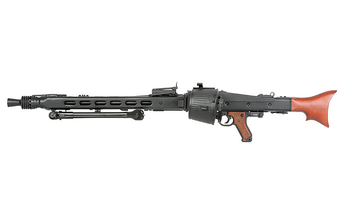

Fully Metal AGM airsoft MG42
That’s one huge slice of Heat Shrink!:smile:
Absolutely LOVE IT, even though it’s a Buzz Saw and not a Kerchunk Kerchunk!:smile:
Damn our stupid Government.:confused:

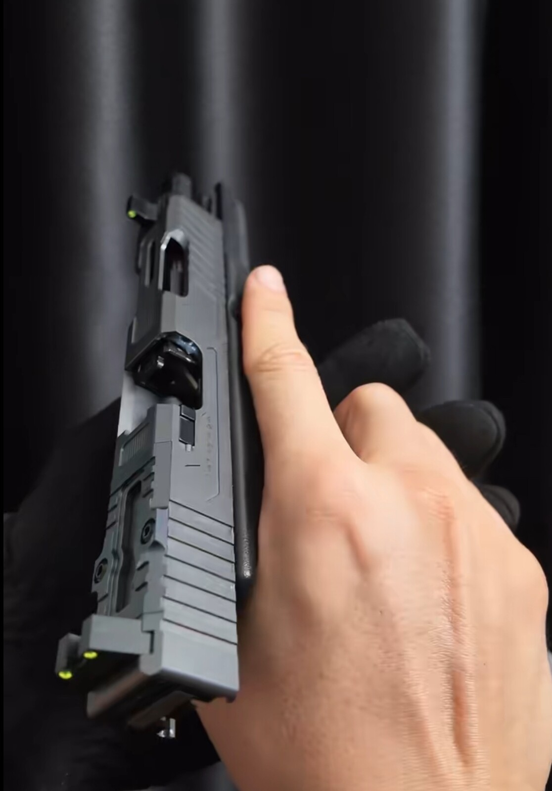

No one asked for it but here is a gray version with a different view
@Bart368 unfortunately those are Airsoft so even without the current border cock blocking we wouldn’t be able to get them anyways.
At least with the ones QQ posted they’re gel blasters so there was a >0 chance of getting them.

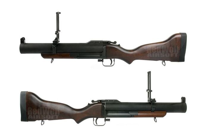

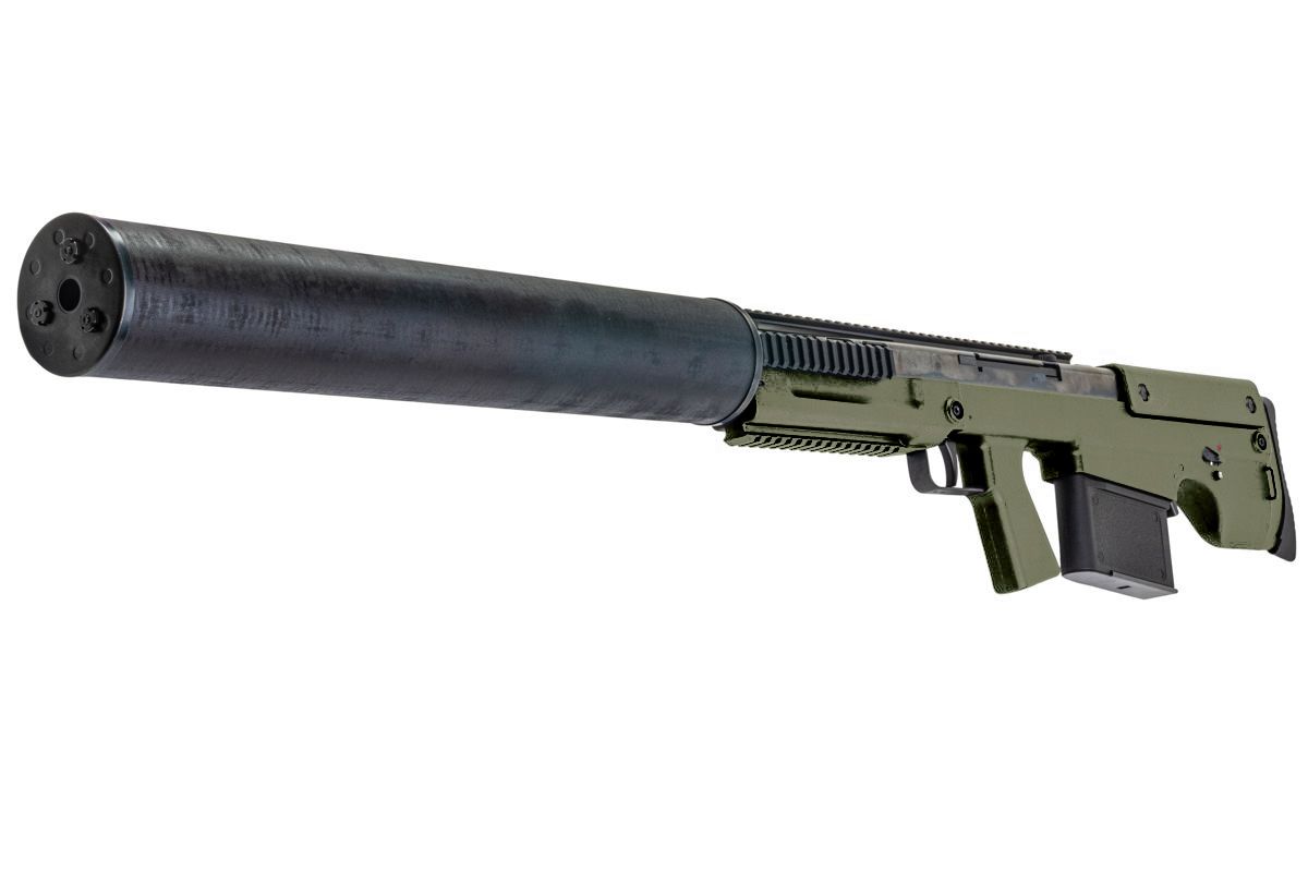

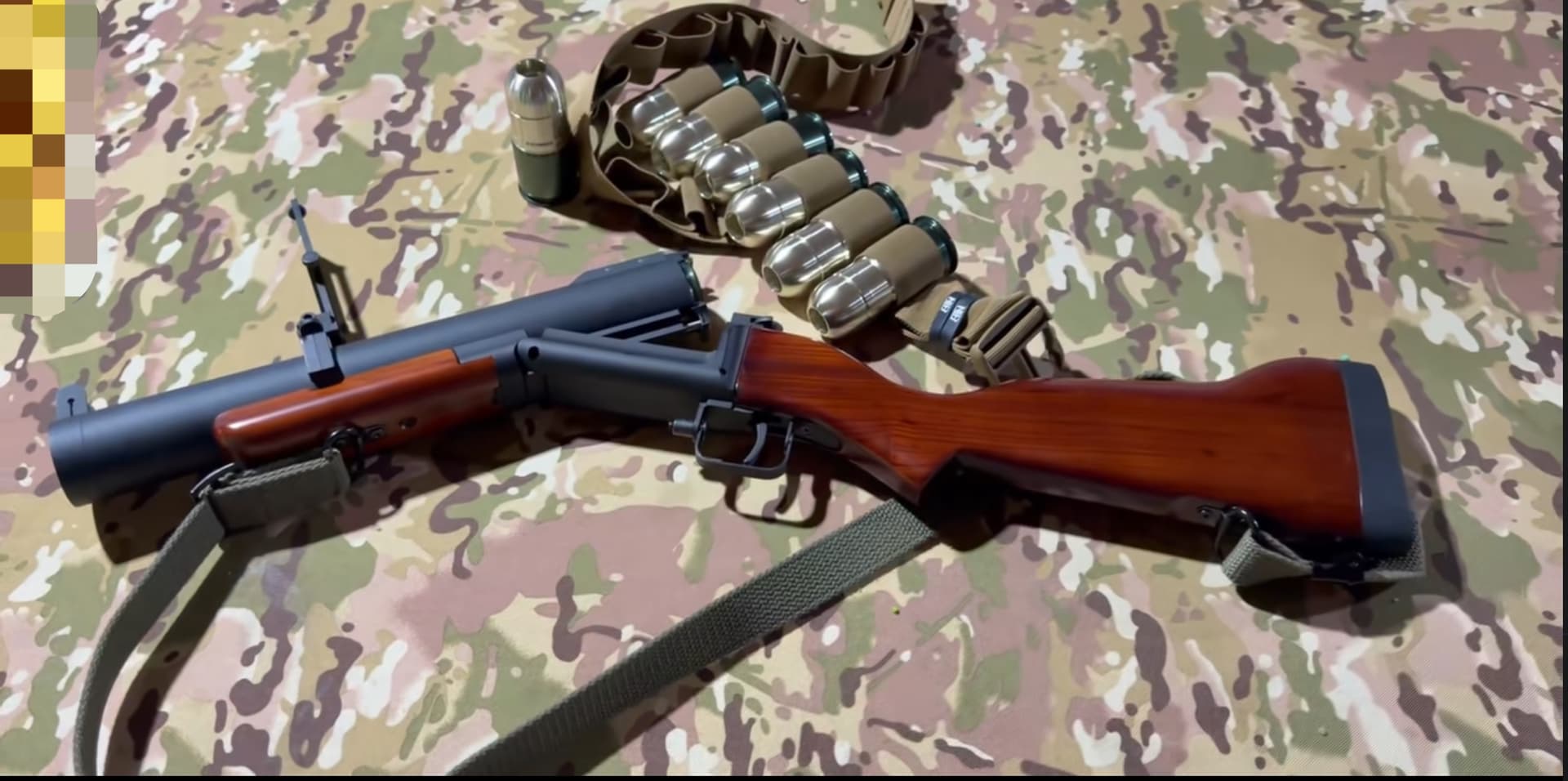

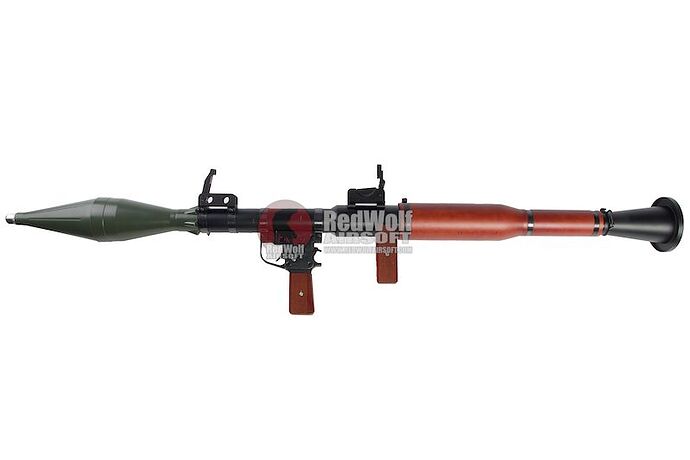

At the moment, there is definitely no metal & wood MG42 gel blaster, no metal RPG-7, no VKS sniper, and no TTI G17 Gen 5, but a real wood & CNC metal GBB M79 gel blaster is available to dream about…
