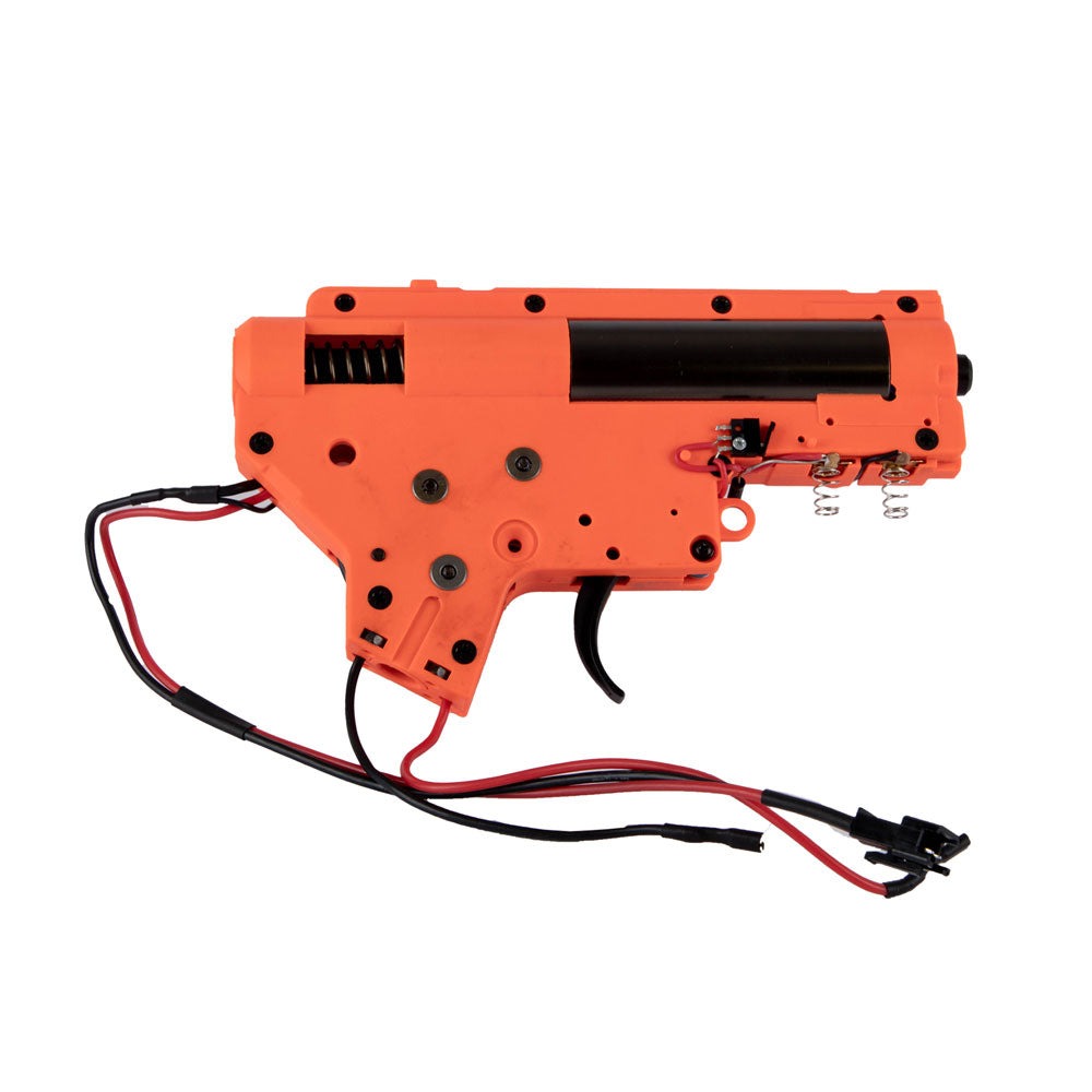

  • CYMA nylon gearbox
  • Nylon piston (to keep everything nylon)
  • alloy double o ring Cylinder Head & Nozzle
  • alloy double o ring piston head
  • 1.18 unequal spring
  • ausgel yellow 460 long 30k motor
  • titan 7.4v 6000mah nunchuck battery
  • 35cm polished barrel
  • rizer hopup
To me this is peaking the safe limit to a nylon, yes could maybe do something more but not sure or cant find appropriate parts. So i want to use the above and learn and plan the stage 2 and up… maybe even hpa if i can afford as jesus this tech has advance since the old school gen 8 …

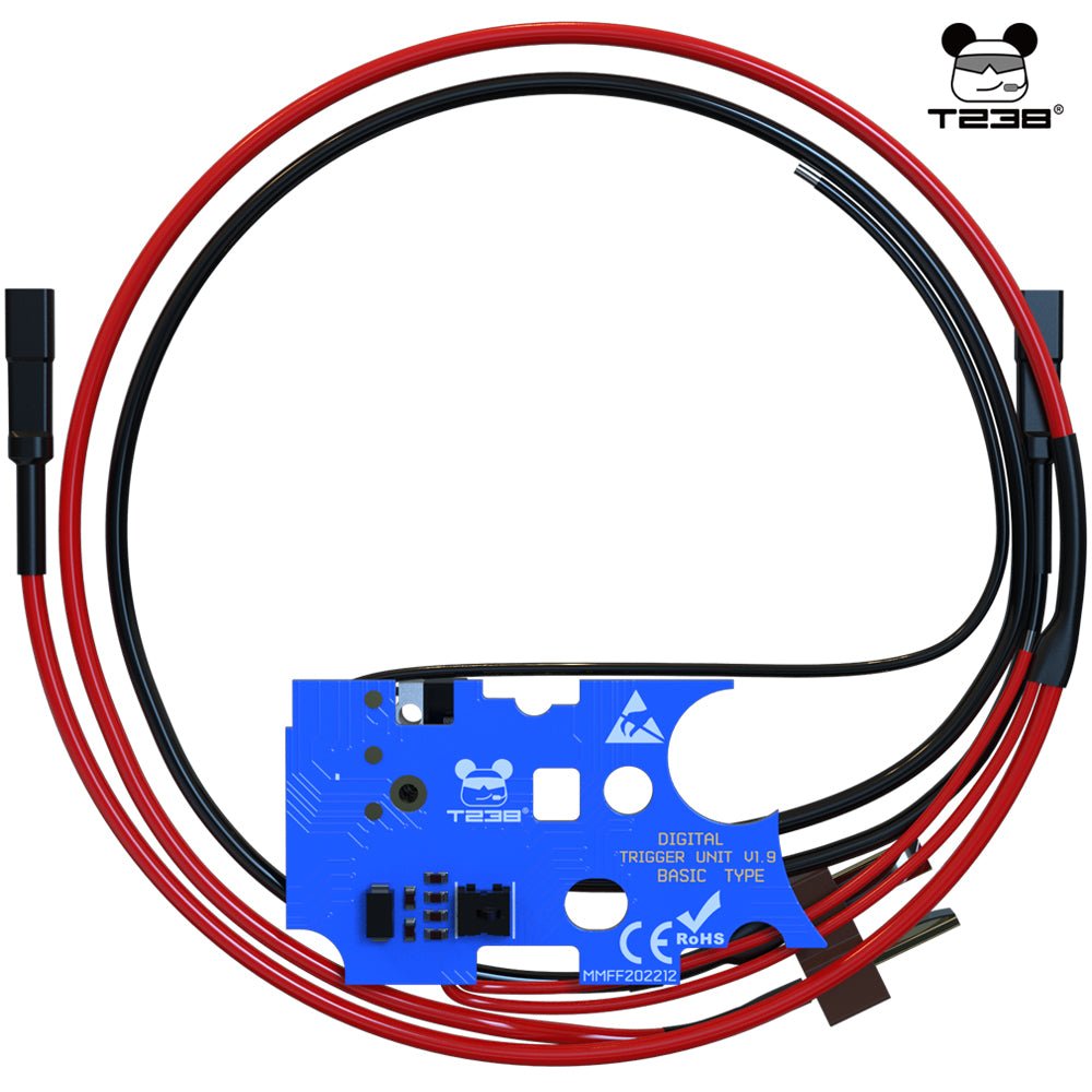

MOSFET
  • what do i really need… i just wanna take the pressure of the switch so i can run 11.1v without killing it. I know nylon has it limits with M springs etc so most likely will try a metal gearbox. I am not after a leviathan or programable thing just basics?
  • can i make one myself, would be keen to investage and have thoughts?
  • i understand the soldering however need to learn but any tips as i have heaps of shit to practice on.
  • where can i get a basic one or whats advice for this.
  • basically i need help and knowledge to take the next step…
  • can i run heavier springs with nylon box and mosfet. Is it logical or worth it.
Any advice around this topics would great. First post here.

I run a number of nylon gearbox CYMAs on 11.1v without problems, There is plenty of safe margin left in your configuration as they easily handle M100 springs and metal gear setups (with the correct anti-reverse latch). Most are running around 300fps when tuned with the correct ported cylinder
The only issue has been with the trigger when constantly running in semi-auto mode as it tends to wear and bind in the thingy with the contacts

Like Wombat, I’ve had plenty of nylon CYMA gearboxes in different builds and haven’t had any issues running an 11.1v lipo in them. Definitely one of the better nylon boxes on the market. Haven’t had any contact issues at the trigger trolley though… maybe I’ve just been lucky. :man_shrugging:
I can definitely vouch for the CYMA full metal gearboxes as a drop in replacement for the orange nylon ones. Very reliable, don’t break and can run big springs in them with no issues. I think the stock spring is around 1.4mm from memory, and usually hits at around 320FPS.
The two M4s I have running metal CYMA boxes are all running M90 springs and are sitting around 280, usually my target FPS. Very understressed and bulletproof. :+1:

I’ve seen a lot of CYMAs run 11v with a 1.18 or m90 spring for quite a while with no issue, eventually the trigger block will cause issues, usually just a gentle file and quick alcohol wipe sorts it.
I would run an M90, an pick up another gearbox to play with, they are only 17.70 right now… so get a few and run em hard!

If you do want a basic ETU, the T238 basic is a great cheap option, I use loads of them.
Again, I wouldn’t recommend being too fussed until it breaks… but I would change it because I change everything (compulsive tinkerer!). It is better value to not be like me!

Would never of though of the Double o ring piston head reducing drag… makes sense now you say it. Also the 480 motor, again did not know that and the “basic DTU” and the website, perfect.

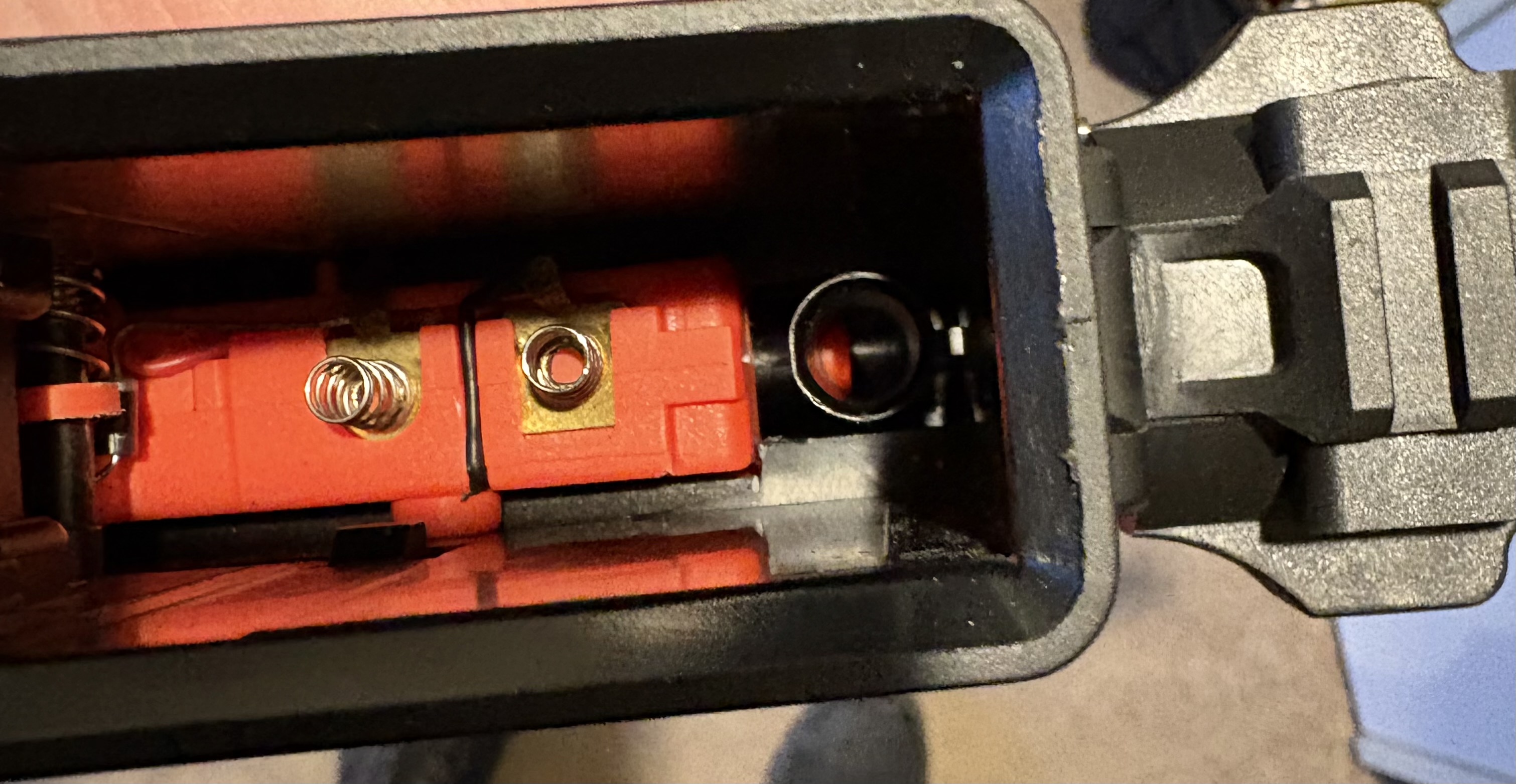

I have a wells CQB and recently bought the orange cyma nylon gearbox. It doesn’t seem to fit in easily. Before I go modifying anything thought I would ask the question am I missing something…?
Yeah, CYMA V2 gearboxes are not a straight drop in option for a Well M4 receiver.
I successfuly put a metal CYMA gearbox into a Well M4CQB receiver a long time ago, some dremel work on the shell around the area of the front of the gearbox was required to get it to fit.
It can be done though.
Yeh the gearbox is in after some modifying. Still need to adjust terminals on my mag as they suit the previous gearbox. I feel this might be a problem though
The nozzle doesn’t go all the way back and that is the shortest of the 2 I have.
