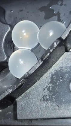

I had the same issue with some of my mags, mainly from my Bohan Ar16. The gels seemed to clump up right before feeding into the wheel, since the part right before the wheel was large enough to fit 2 gels, instead of 1. I fixed it by putting a bit of thick gorilla tape on the ramp (leading under the wheel) right before the gels get pulled into the wheel. This lessened the amount of space where they were being fed. I’ll screenshot where I put the tape.
Screenshot 2025-10-13 at 5.21.59 PM
(I had to use more than one layer)
