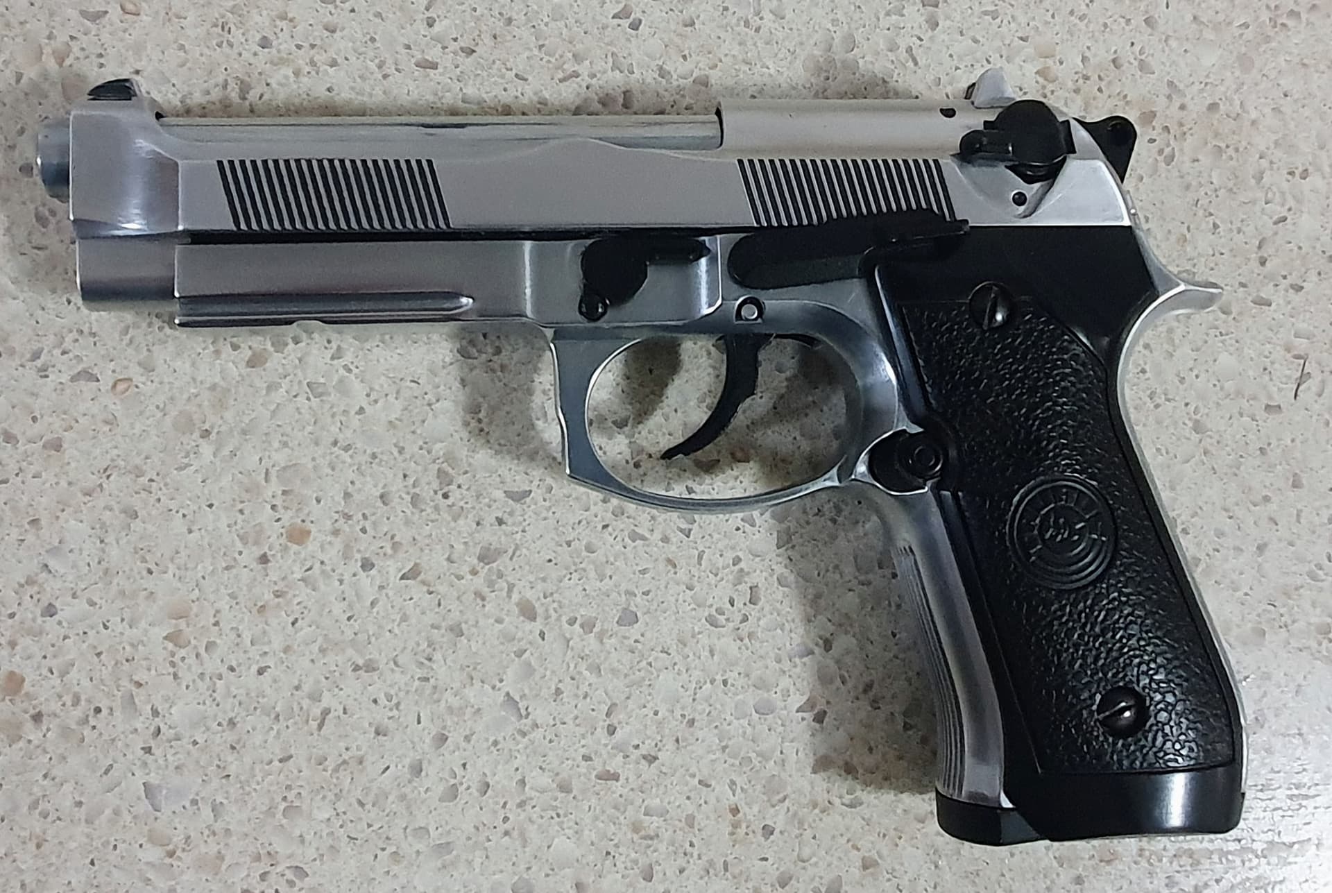

Anyone using WE Tech Beretta mags in a Double Bell Taurus? :thinking:
Despite sealing around the base o ring and changing fill valves the two DB mags I have for the Taurus will lose their gas overnight.
I’ve heard that WE Tech M92 mags are compatible and don’t leak like a sieve like the DB mags, but before I go looking for them and dumping $160+ on two mags it’d be good to know I’m not throwing my shekels away on something that won’t fix the problem. :person_shrugging:
