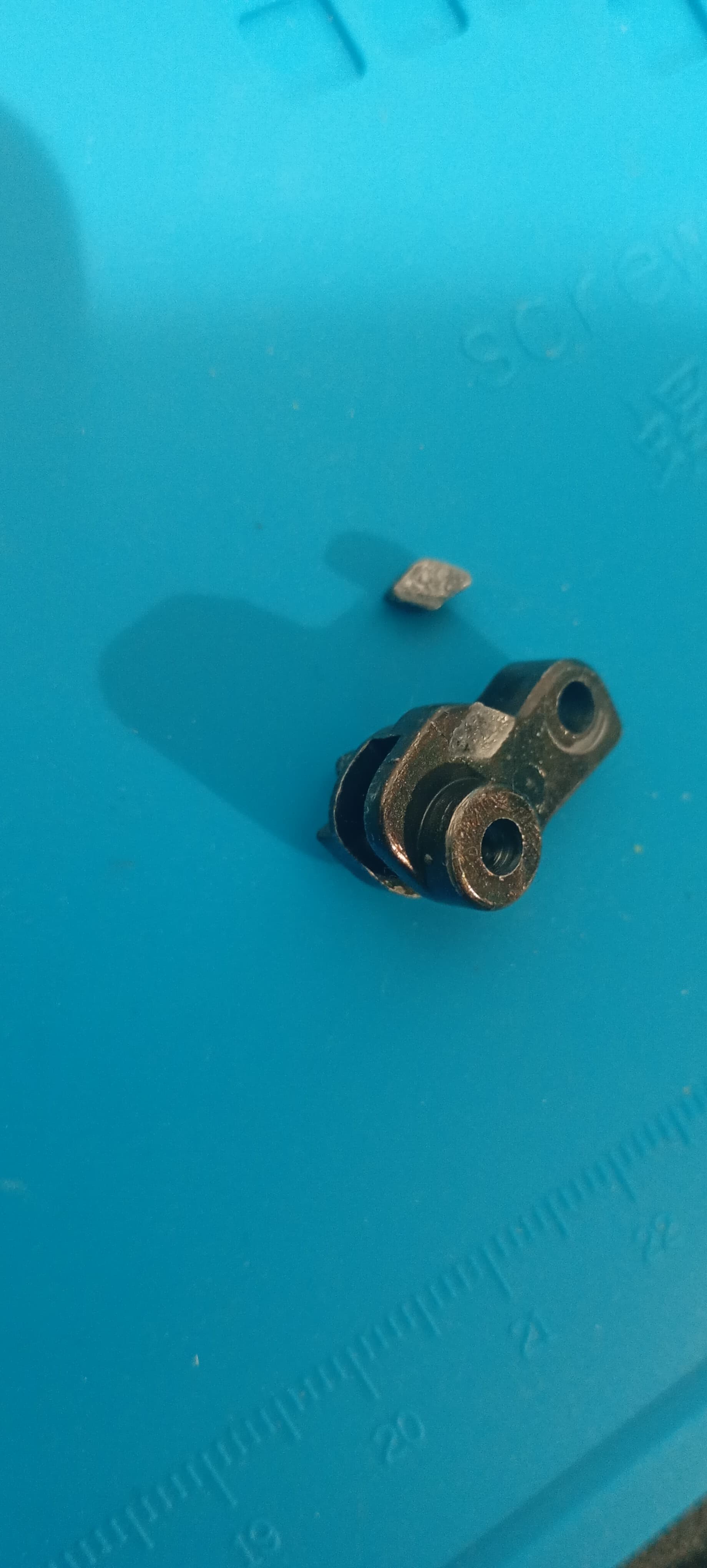

I just got one second hand. Hammer is stuck down. Where can I get replacement parts?. It’s not looking good. Everywhere is sold out
Get creative is your best bet. Unstick it :+1:
Your response was as useful as tits on a bull. I pulled it apart and a piece has snapped off . That bit was what was jamming it. So clearly need to find a replacement. But every sit is sold out.

iHobby imports all the DB stuff, luckily the import parts too as DB is well known for being a bit lacking in quality of internals.

Oh man. Really appreciate your help. Ordered and sorted. Thankyou so much.

In short, it isn’t the first double bell I have seen had to break something to be able to fix it. They are just hit and miss on quality and fitment.
Some are fine, some are hot turds. And everything in between.
I get PTSD every time I see one of their hicapas. As not all models use the same parts so replacing parts often led to more issues requiring further modifications and tinkering.
Most common issue on their glocks aside from leaks is the trigger, hammer, seer assembly just not working like it should.
