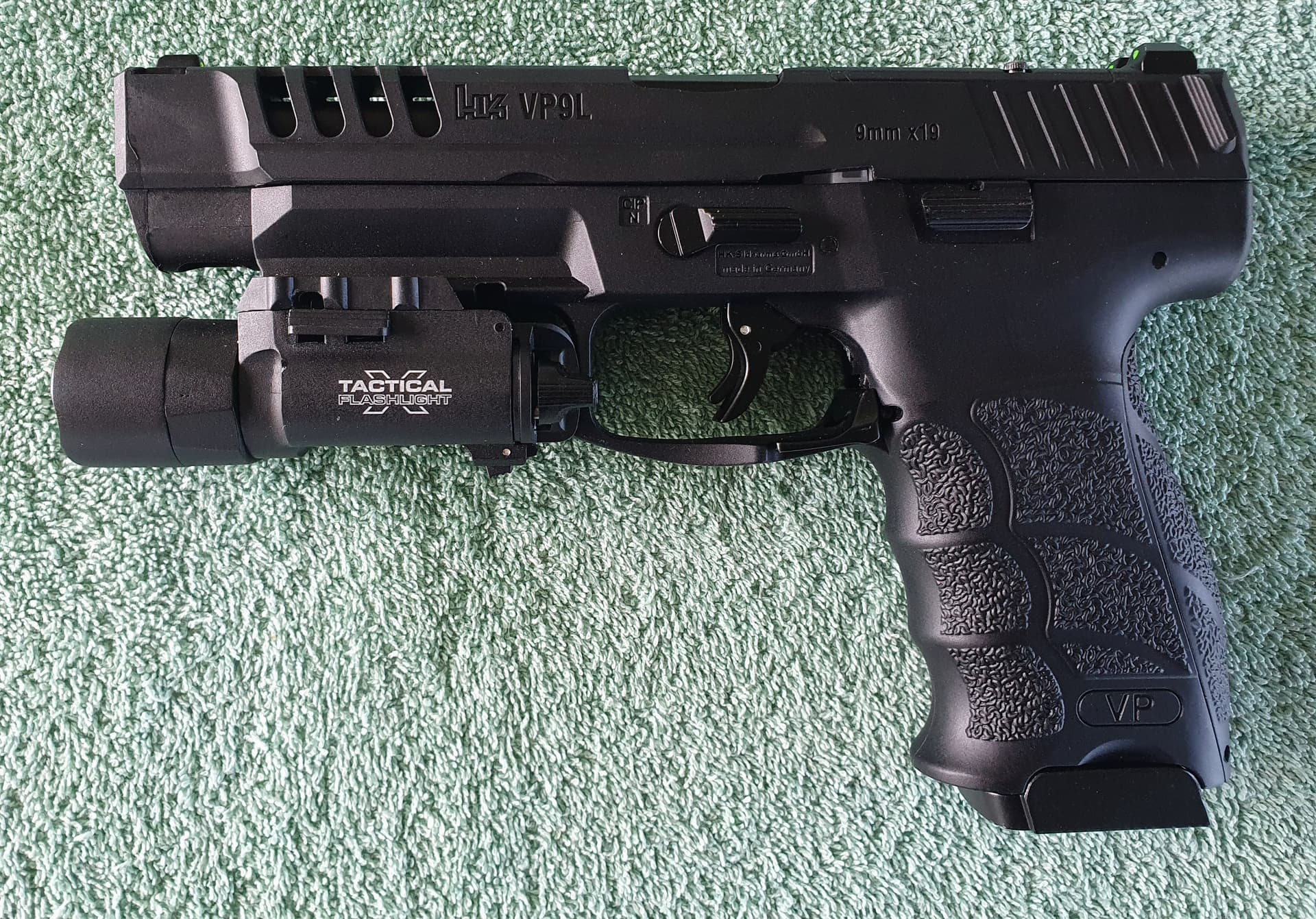

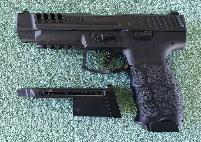

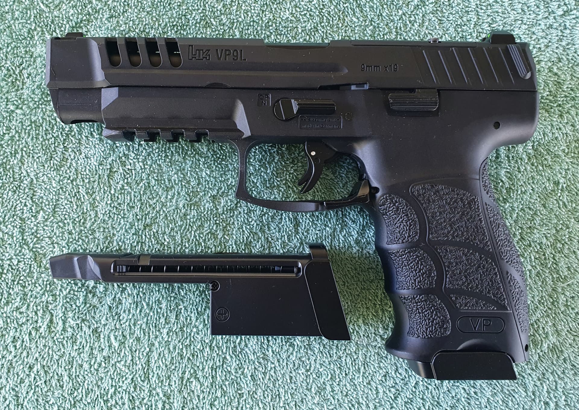

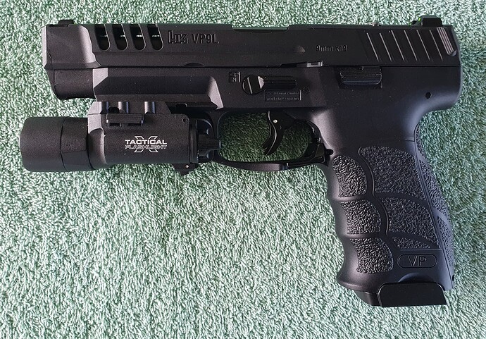

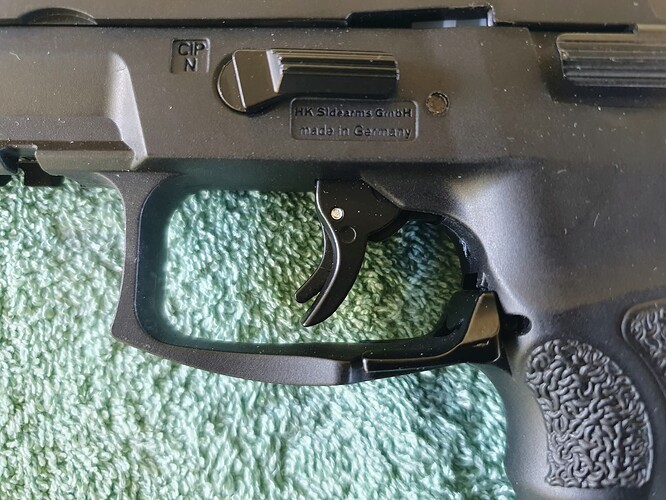

Very solid nylon build, no shell flex, metal parts here and there, good weight, especially with a torch attachment fitted.

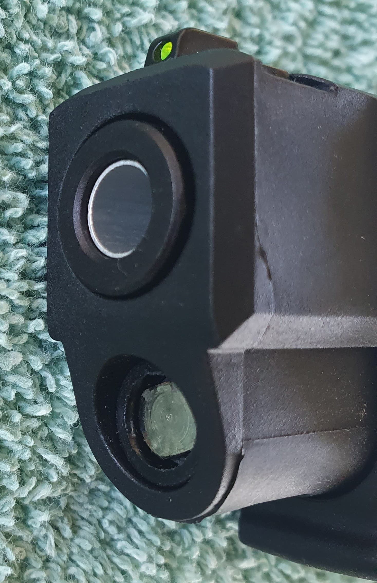

Metal outer barrel and inner barrel
Glock style trigger safety

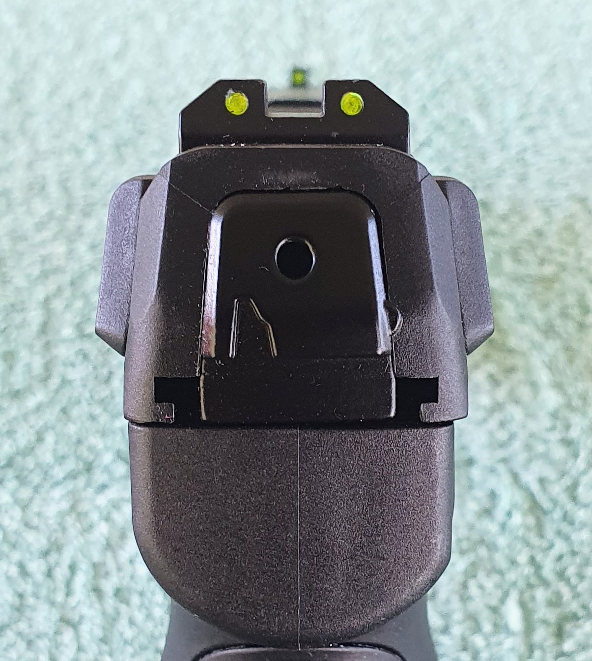

Faux fibre optic sights

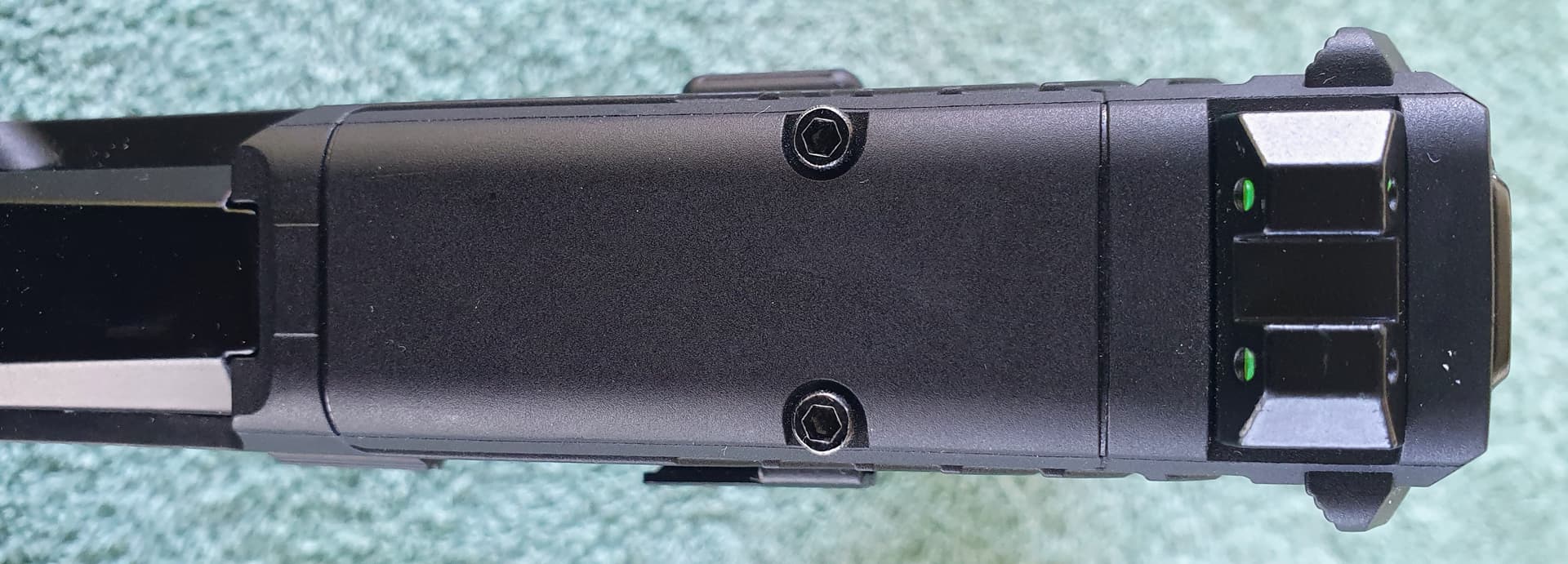

Removable cover for optics attachment

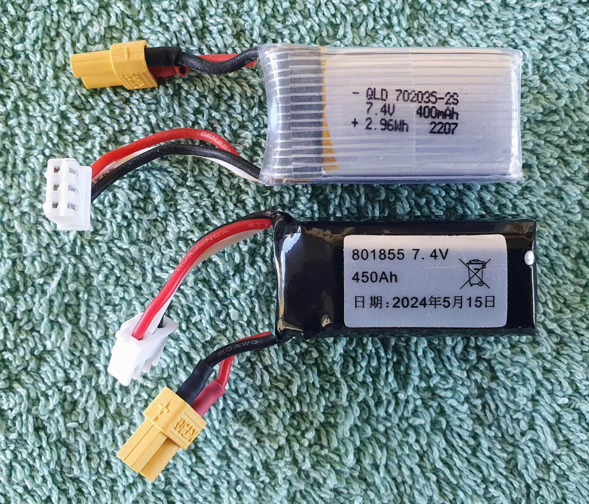

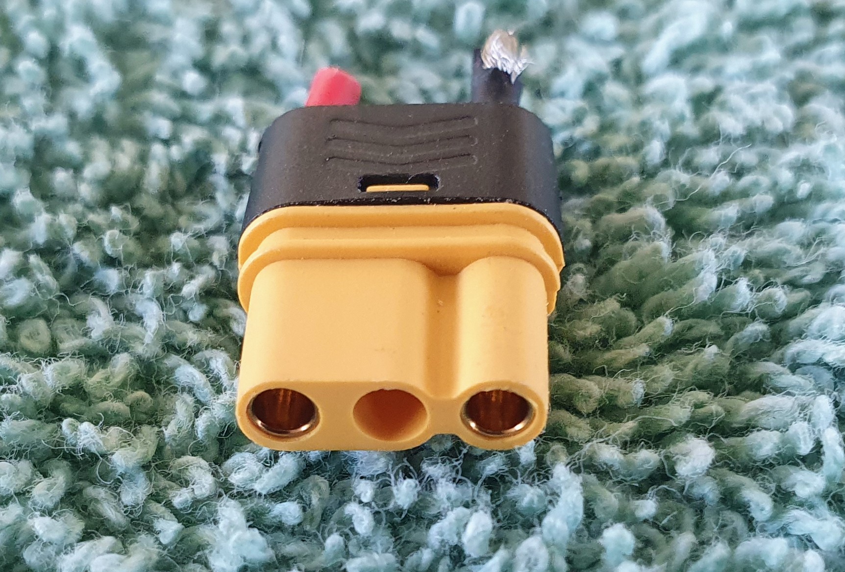

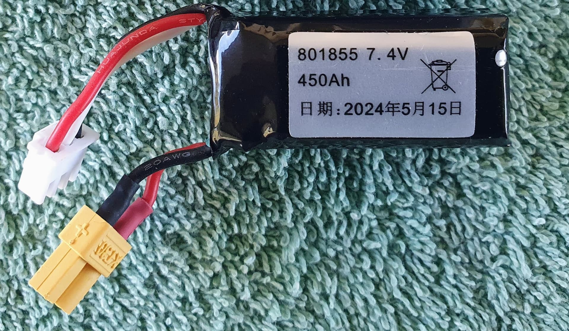

OEM battery is a tiny 7.4v lipo unit with a very different connector fitted, charging is via the balance connecror with the supplied USB charging cable, never the best option. I opted to swap over to XT30 so it could be properly balance charged using my Skymax charger.
The OEM connector
In the process I had a brain fart and shorted out the battery, cooking it and making it useless. Ooops, my bad.

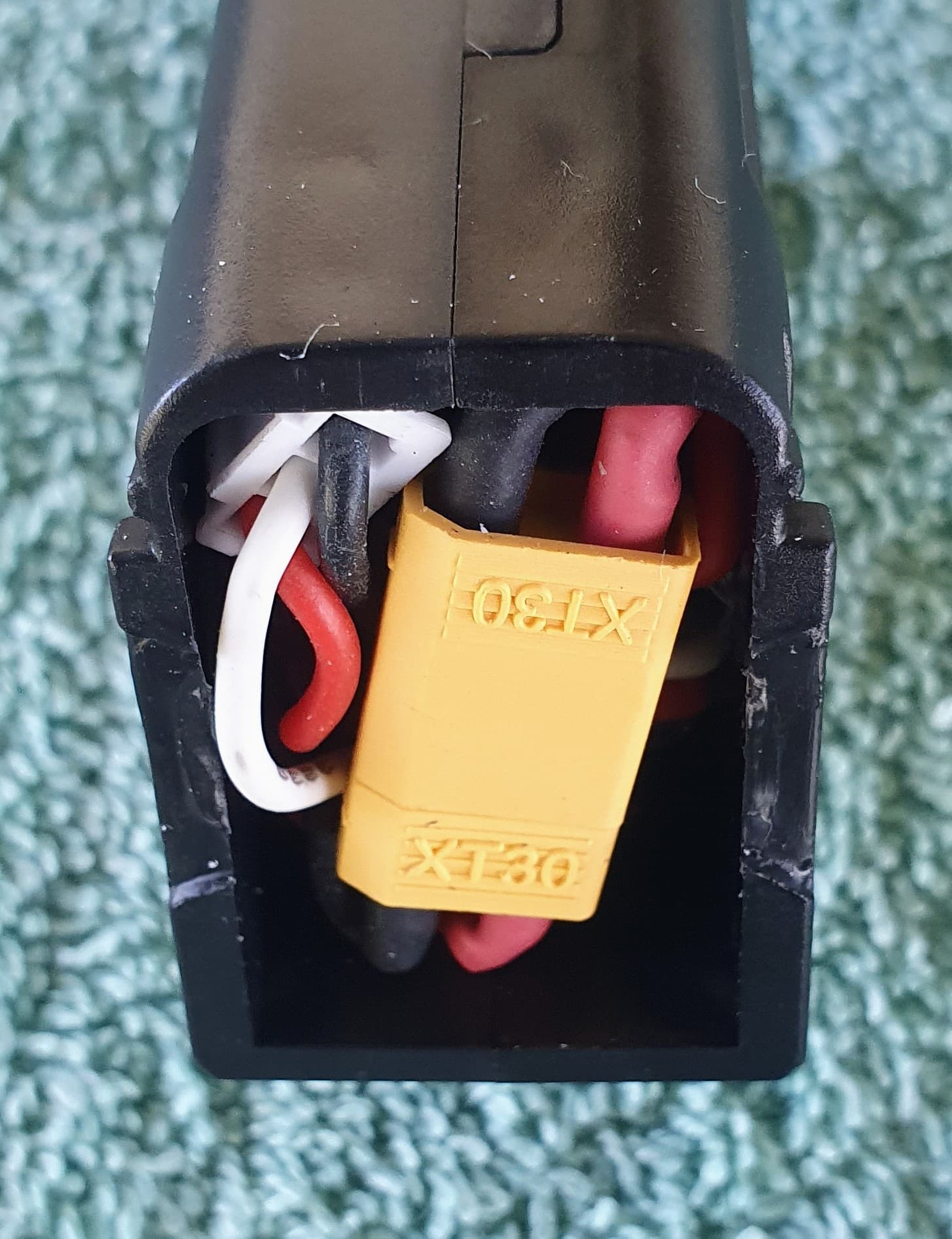

Spare magazines are readily available from iHobby, but not the case with batterries. As of now I still haven’t sourced replacements, however I found a couple of small (but slightly larger) 7.4v lipos that will fit the mag. Here’s a size comparison…
The battery tucks away neatly with zero room to spare, but definitely not as difficult or tight as the old 3DG Glock batteries were to fit. Cover goes back on with no problems.

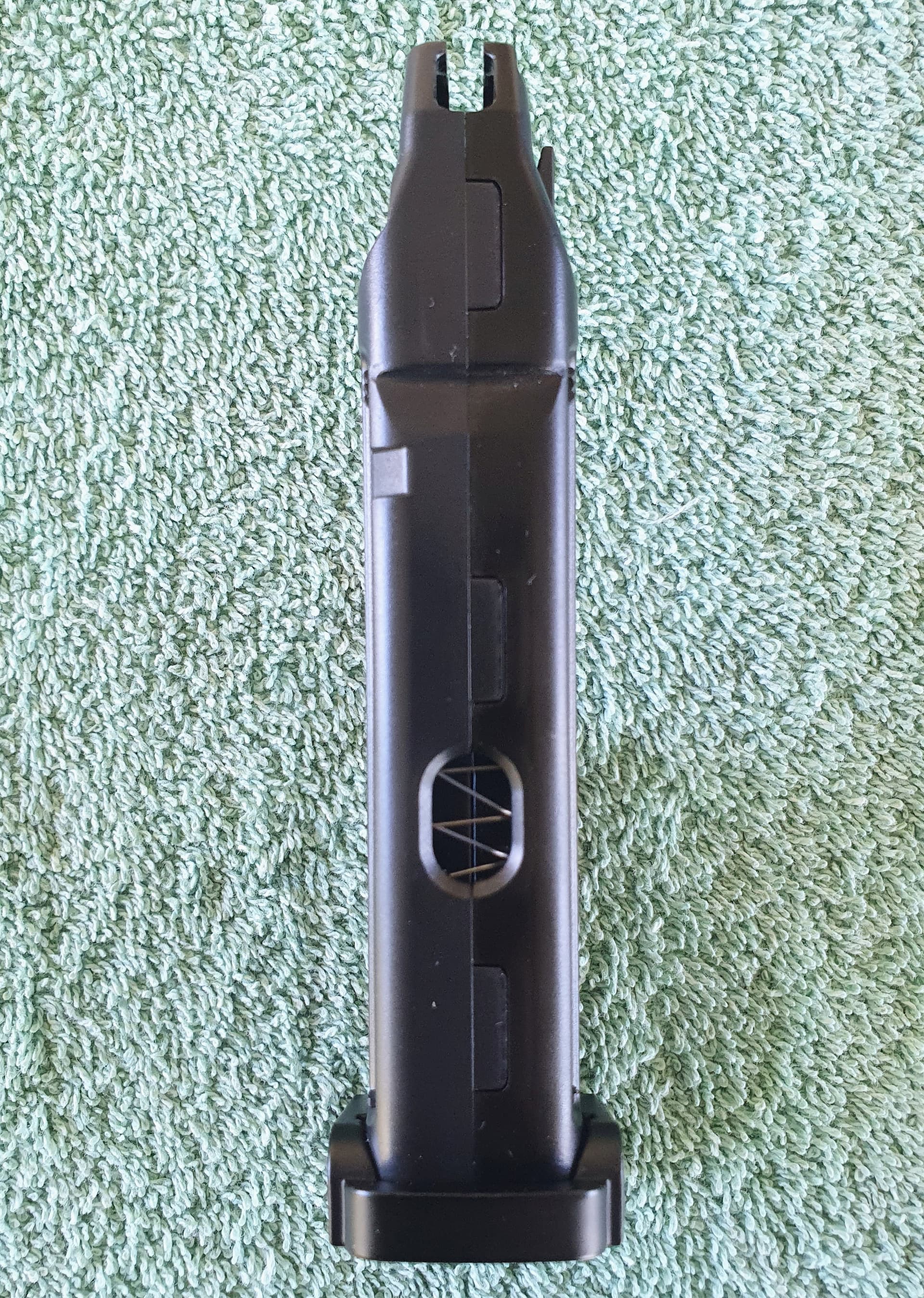

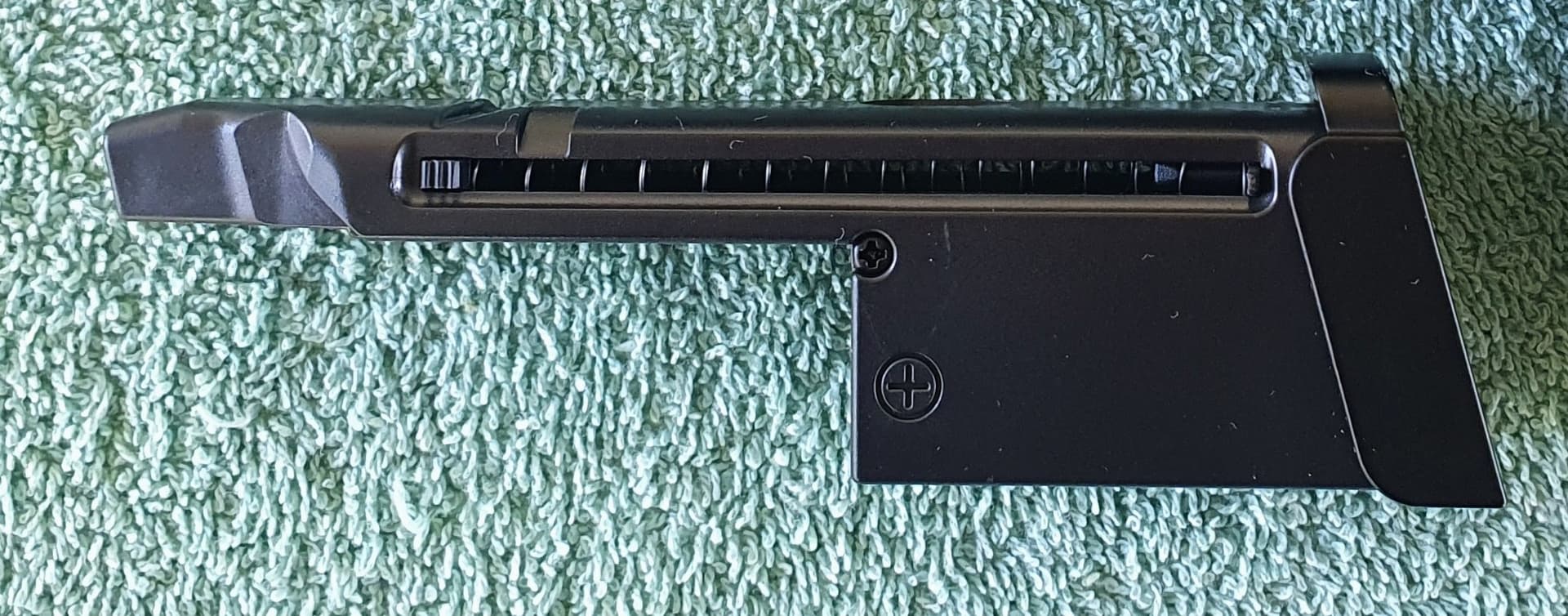

Similar to the 3DG Glock magazine, batteries fit as above, follower is spring loaded and gels are loaded through the aperture on the rear of the stack with a pistol speedloader. The mag holds about twenty gels in standard form.
The one issue I’ve found is that the follower isn’t long enough to completely empty the mag on slide lockback. Two to three gels are left in the mag and are rather difficult to remove. I added a rubber spacer to the follower on one mag, that one feeds all but the last gel then locks back. A quick slide release and trigger pull and the mag’s empty. It reduces the capacity by a couple of gels but it’s a worthwhile tradeoff.

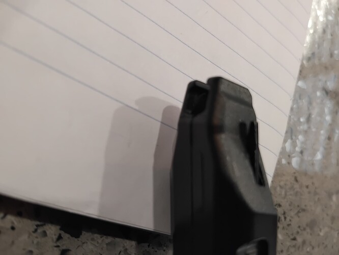

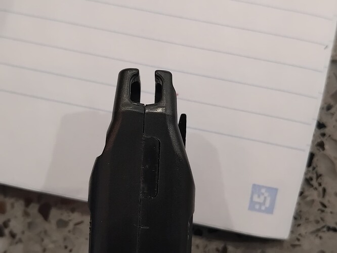

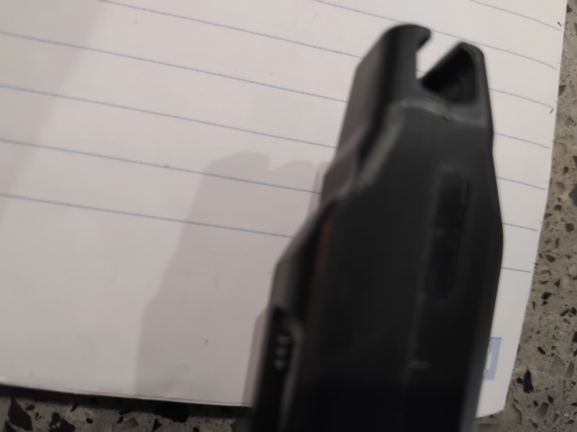

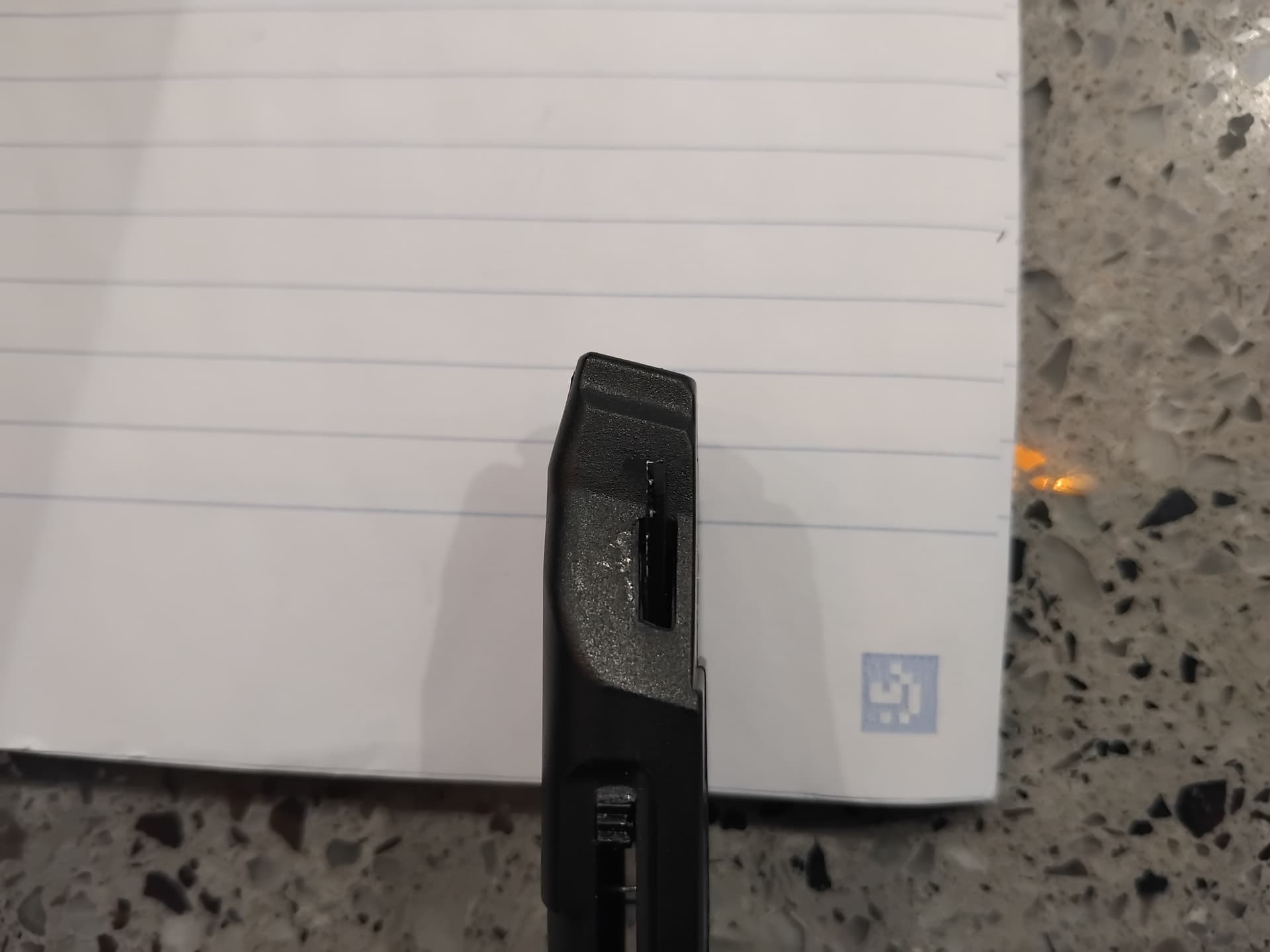

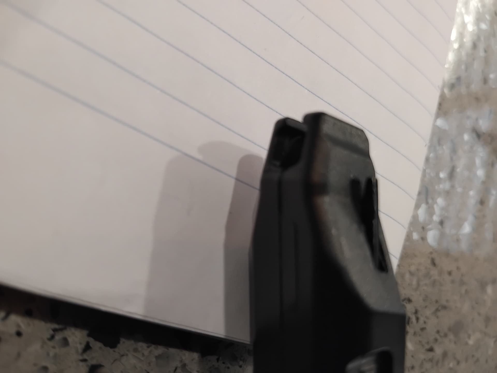

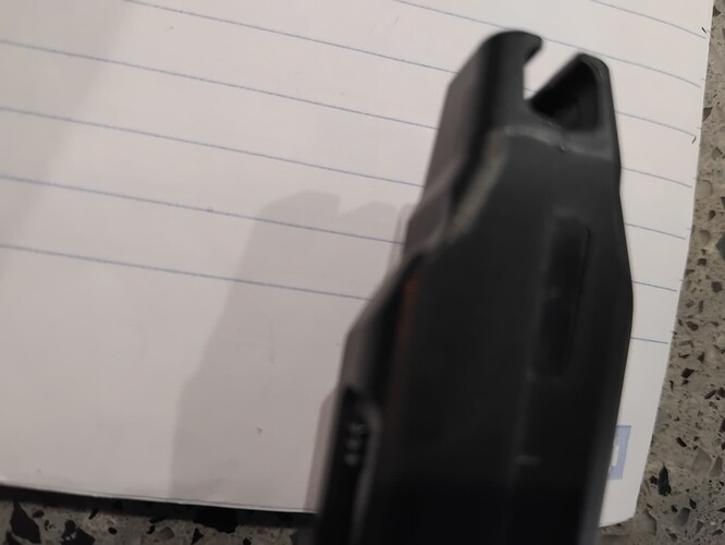

@BME If you get a chance, could you snap a quick photo of the mag lips on your P320 please and post them on here?
Just trying to sort out a few misfeeding issues with this VP9 and I suspect the mag lips are part of the problem. :person_shrugging:
Will do.
Later on, when im back home…appointment with mum now.
Should be back early afternoon…
Mag lips…
One piece moulded to 7.4mm gel.

Same mags… :rofl: I thought they might be.
Cheers for that, Beemer. :+1:
