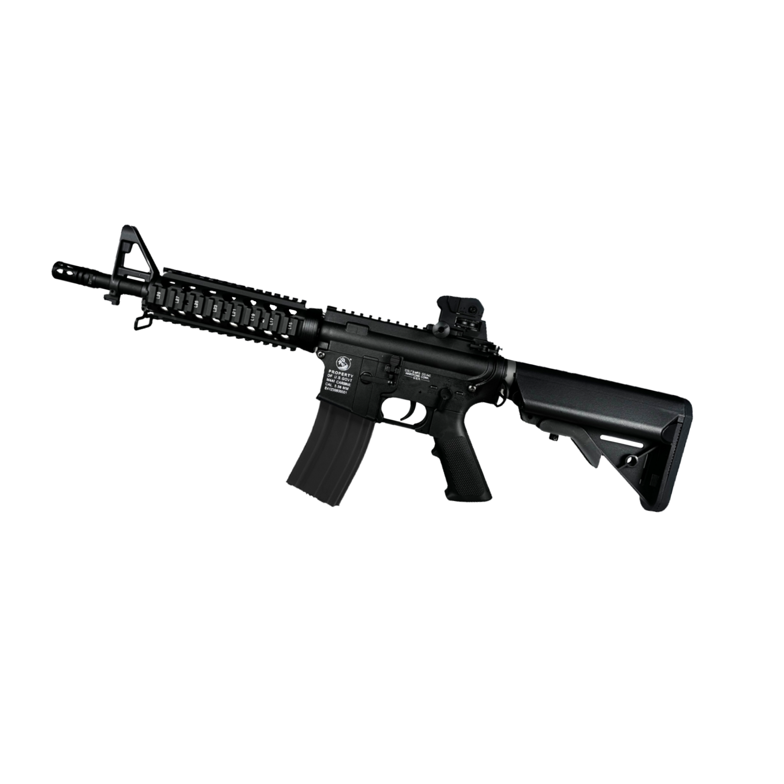

The Cyma scar is also a good option …high fps to be had, with minimal mods.
Reliable gearbox, spares available, nice n light for game days.

Highly recommend CYMA anything… solid blasters, decently built, not OTT pricewise either.
The CYMA blasters with metal V2 gearboxes I reckon are the pick of the bunch. I know Rok’s a big fan of 'em too. Average around 300FPS out of the box ( in my experience ) and last for ages. A few minimal upgrades and they’re up around 330-350FPS no problems.
For larger players the CYMA Sport M16A1 and M16A2 are a solid choice if you need a little more length of pull.

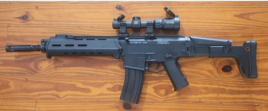

Don’t overlook some of the earlier gear too if you’re on a budget. A well sorted metal geared Jin Ming J10 ACR is a joy to skirmish with if you’re built like bigfoot. Nyon, sure… but rock solid. And not an A/R based jobbie.

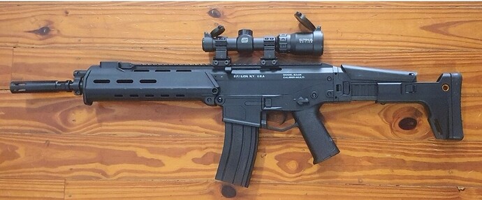

+1 on the ACR.
Very, very solid build…great beginner blaster.
The gearbox is very basic, and comes apart easily / simple to work on.
I’m running a M95 on mine, and its doing 300 fps no probs.
A M100 would be ok for the nylon box… im happy with the 300fps for low stress and longevity.
Affordable, too…
Just need to watch the chafing of the battery wires if you pull the ACR apart
Keep in mind it’s only a Gen 9 gearbox too… so unless you manage to find a MK Hybrid CNC gearbox secondhand you are kinda stuck with those limitations i.e. don’t go nuts on the piston spring. The Gen 9 boxes weren’t the most robust item and hsd a tendency to warp if you go shoving huge springs into them.
But keep it realistic and the ol’ ACRs are damn good for a newbie. Mine runs metal gears, upgraded airseal components and an M95 spring and easily hits between 310-325FPS on the chrono.
Look pretty damn cool too. :+1:

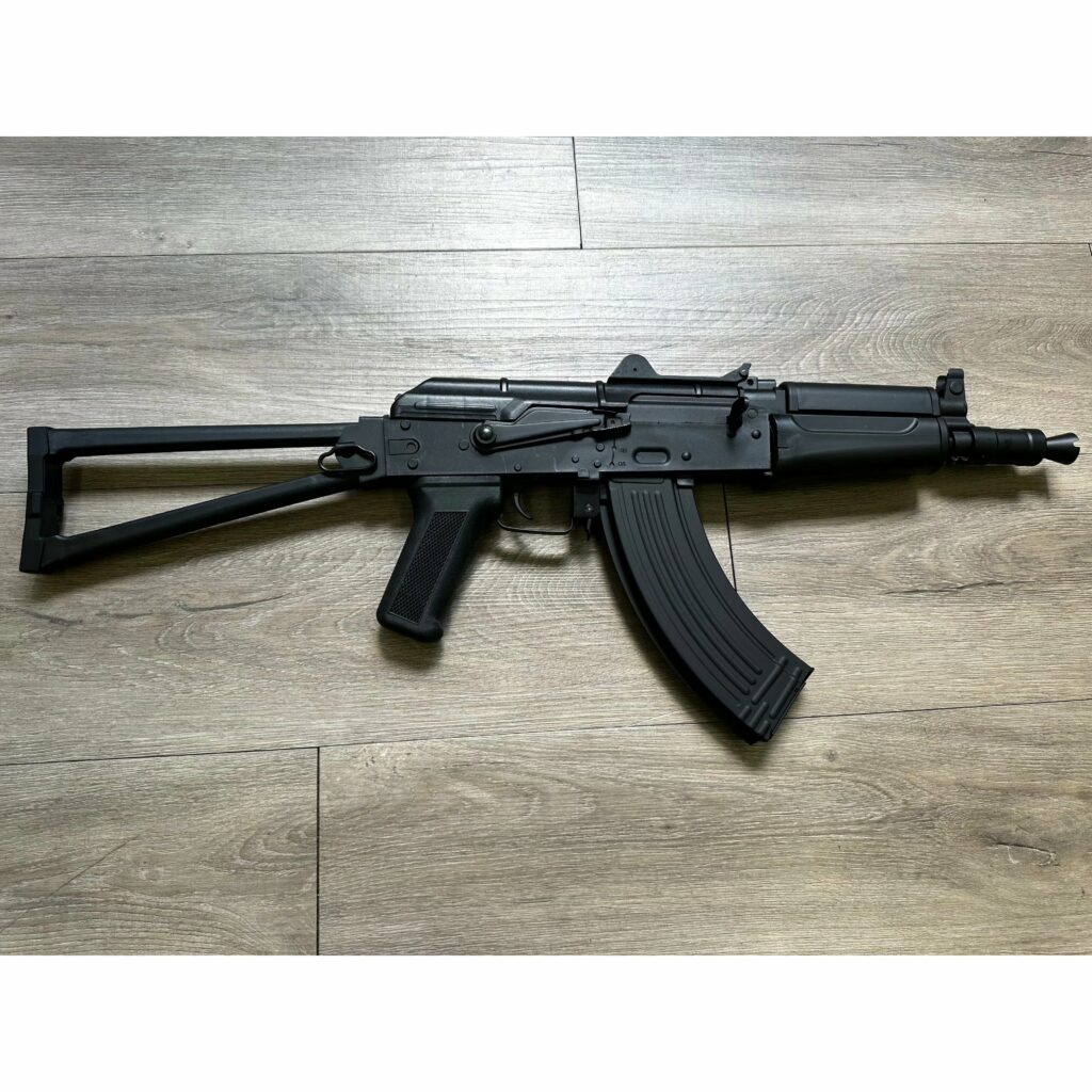

V2 only as well, don’t do fancy thing like MP5/AUG/AK etc.
