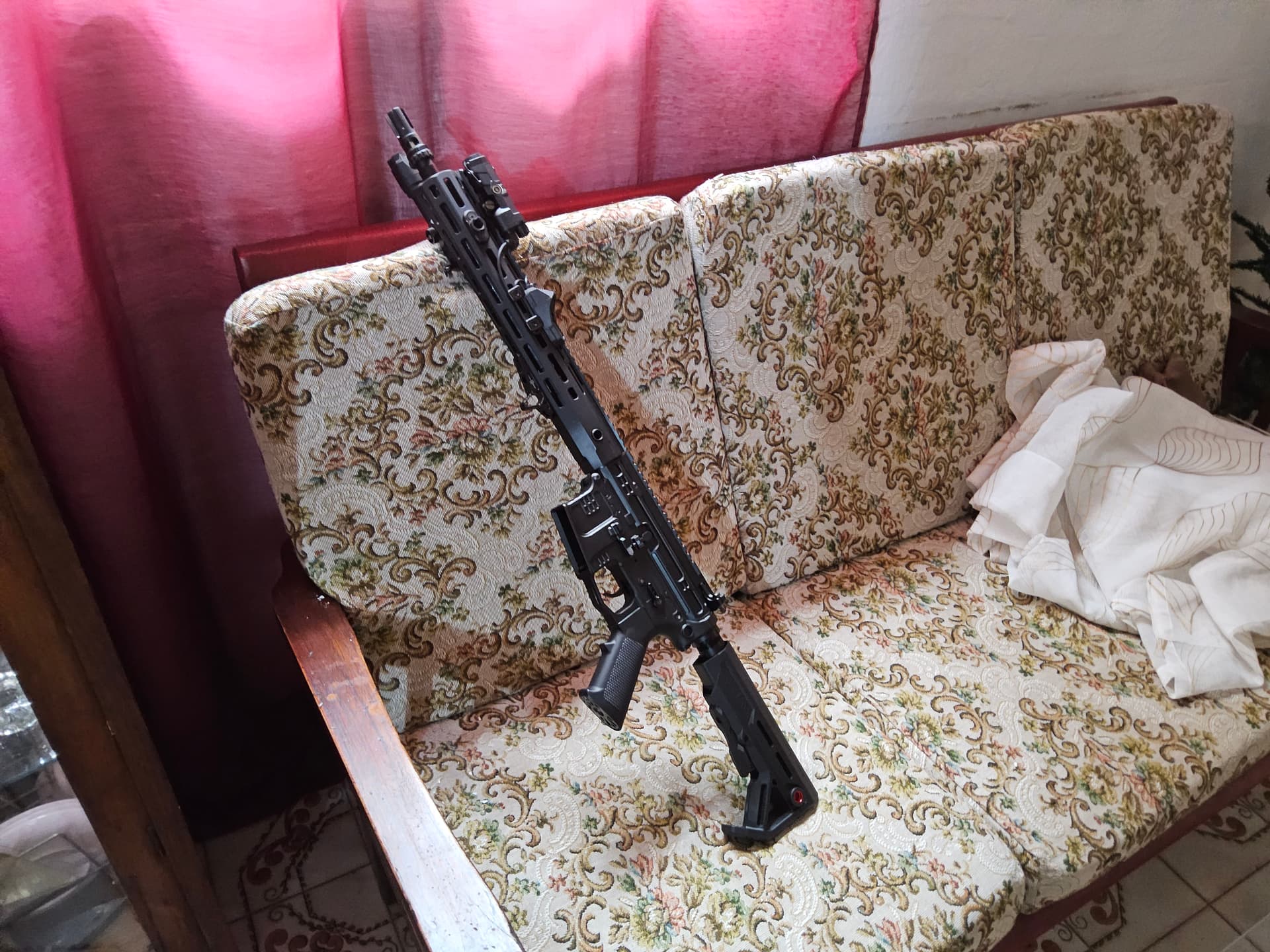

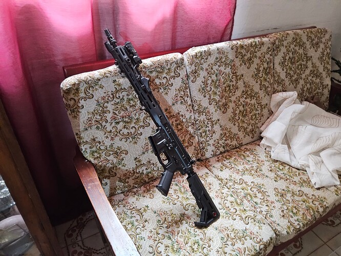

*hello guys hope everybody s well . Finally i finish building my gel blaster works well sound well but it do not fire the gel ball it keeps crunshing them i dont know what the problem is i put a thing that delay the return of the tappet still the same can ayone help me

Everything seems ok eoengagement , rate of fire al seems ok but the gel keeps crashing in the t piece i dont know why i check everything the problem petsist thevgears is 13 to 1 as you ve seen in the video all works well i see the crushing gel in the mag. well crushed i dont know why

There is no brand i build this by myself it is a nylon SLR receiver , a 13 to 1 shs gears and a chihai motor i bought al the parts and build it it took me some time to do it a lot of trial and error but what you ve seen is the final profuct just it wont shot that s why i ask i am myself new to gel blaster but ive watch many videos like cyber trigger. Low guidos nobody gel blaster and so many i learned by watching these videos i wanted to make one by myself i wanted it to look more realistic nylon receiver SLR ,metal handguard i bought every pieces to build it lts just i am not expert enough to make it shoot normally
i am also using a cnc 7075 metal gearbox

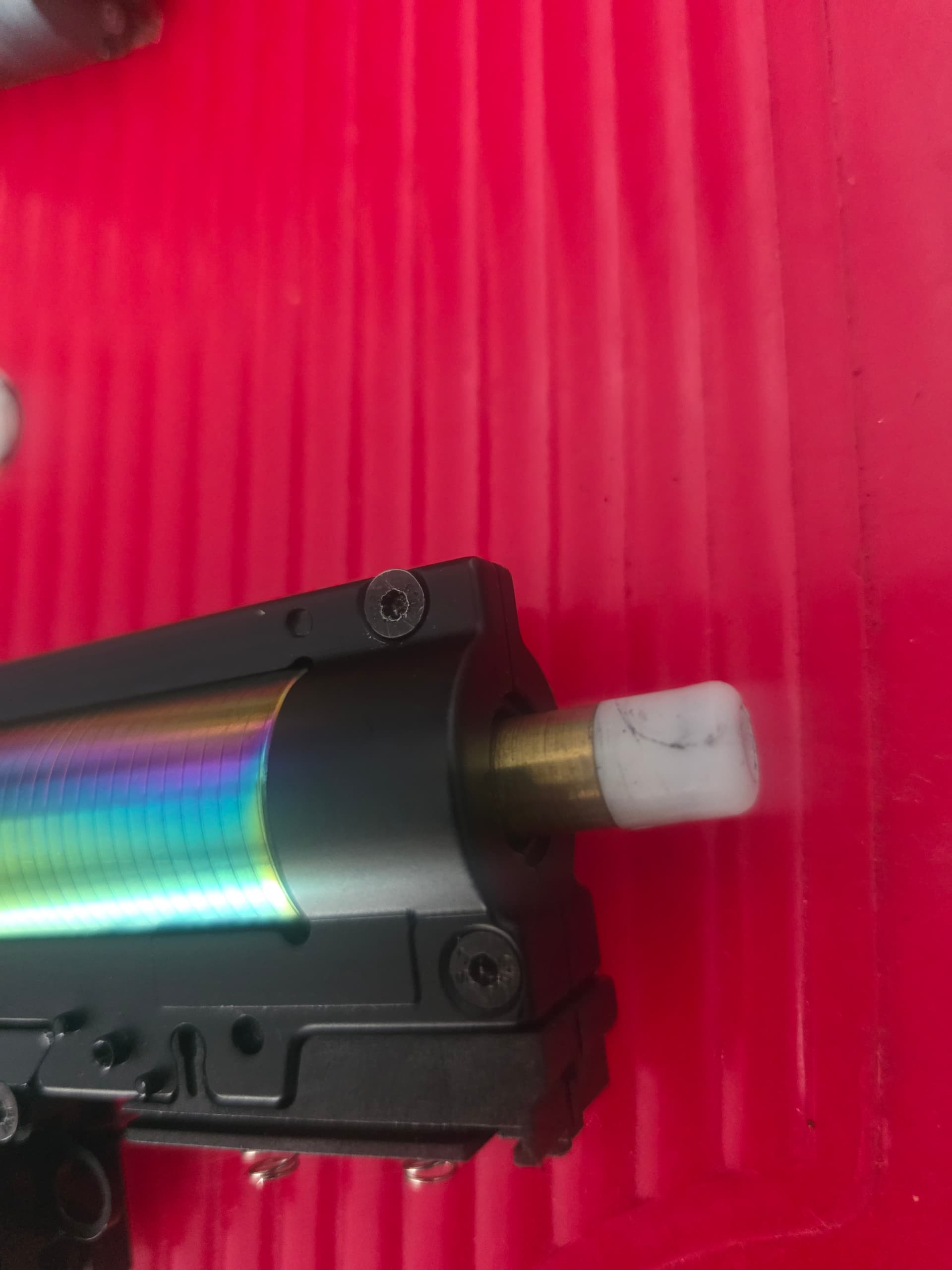

It could be a nozzle issue, there are many different nozzles, and t-pieces. And while some are compatible with other gearboxes and t-pieces, many times you need to use a particular nozzle/gearbox/tpiece combination.

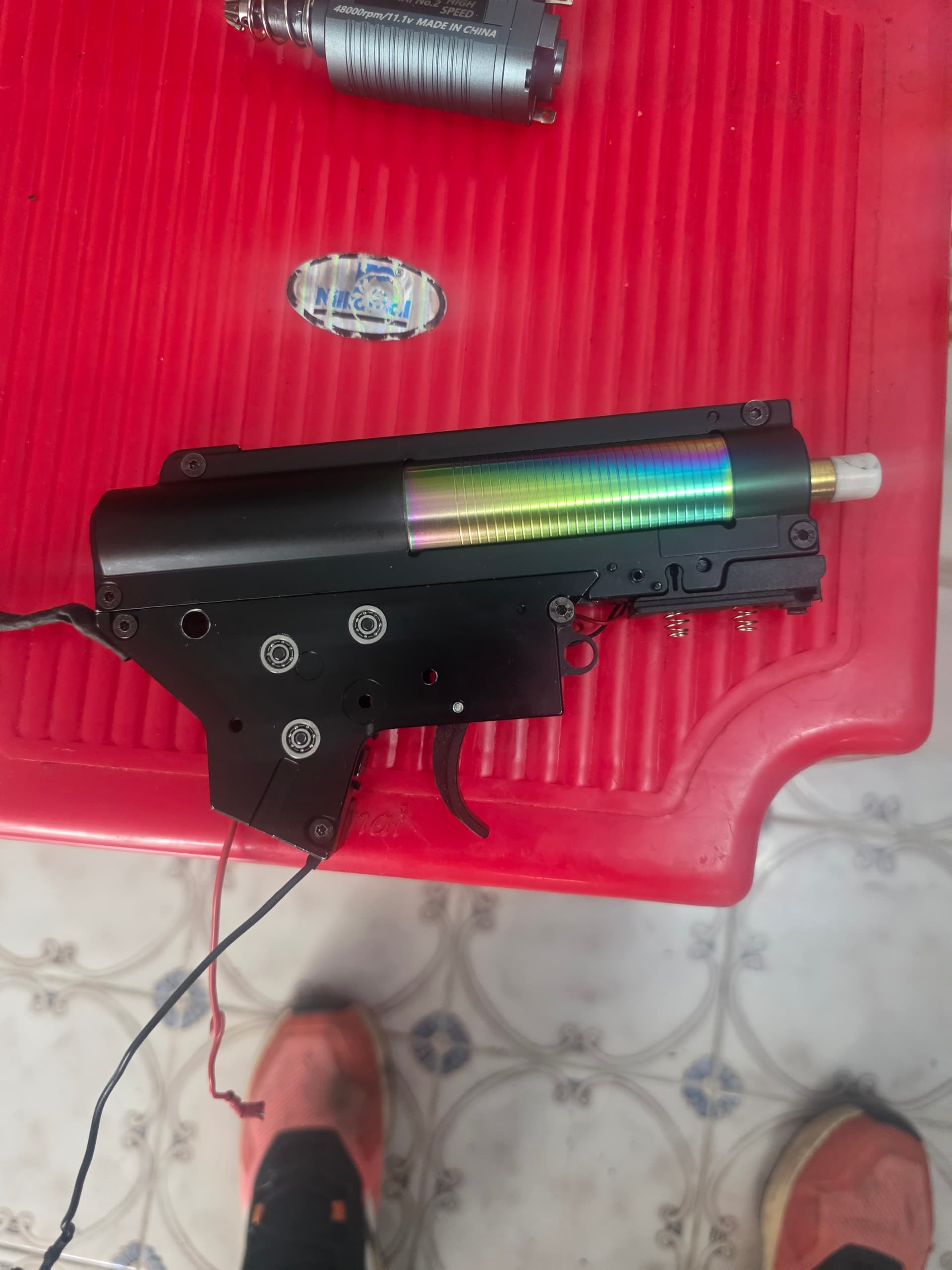

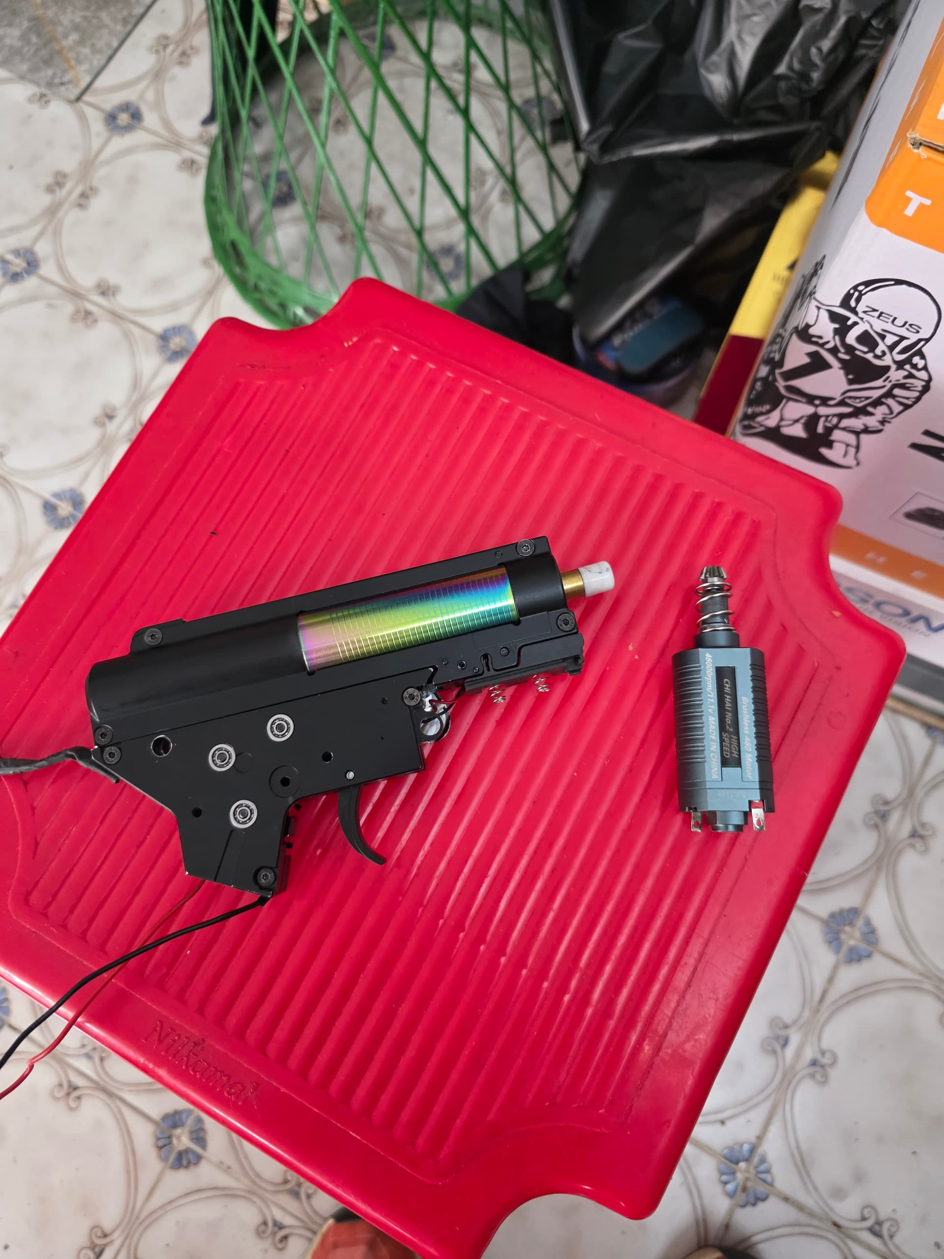

Can you upload some pictures of the gearbox and internals?

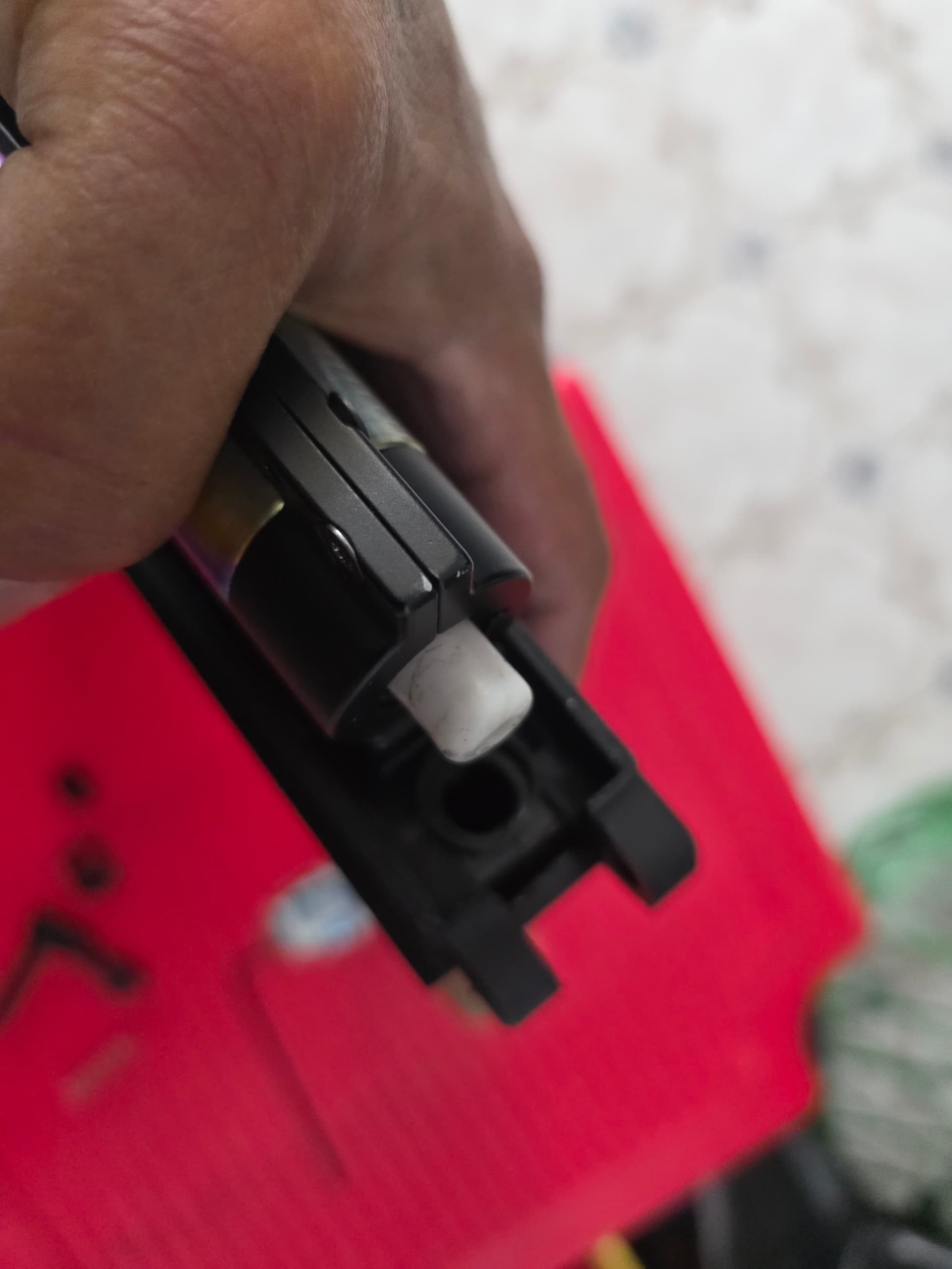

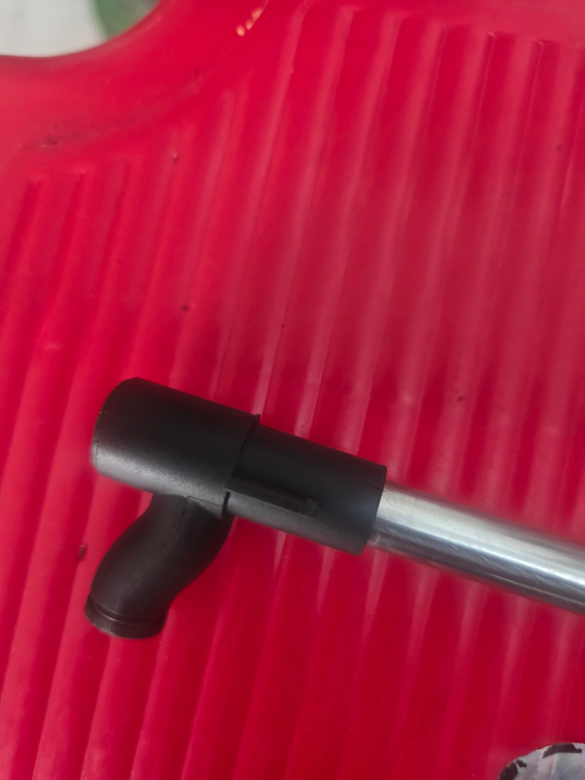

I reckon the gel are cheap chinese gel ball but i put photo of everything ok

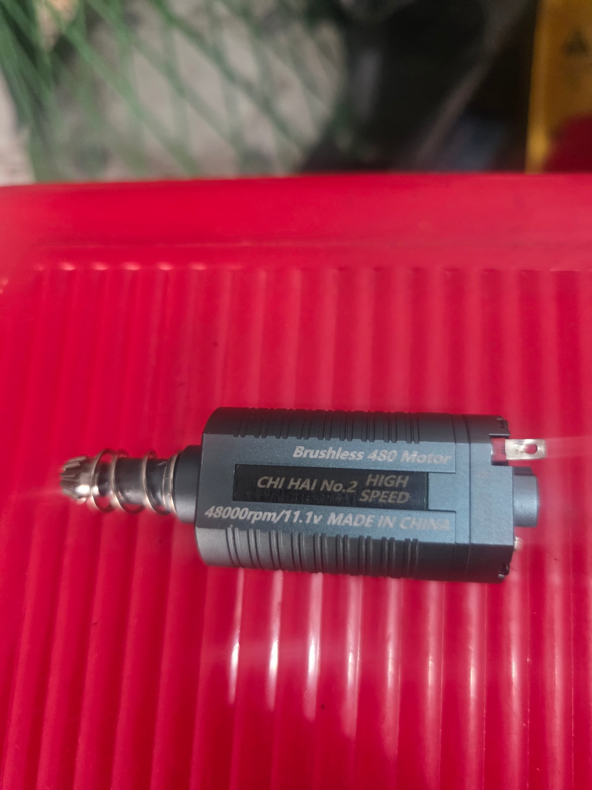

Now the mtir is a 480 chi hai motor 46000 rpm the gears are 13 to 1 the noozle is jing ming and the t piece is an slr one if you need more information just ask thanks
That motor with 13:1 on 11.1v is gonna be about 45rps, which is mental.
On a good 7.4v will be more around 30rps.
if you plan on using 11.1v, you will be wanting a lot of short stroking, and a M120 or bigger spring to avoid PME and so on… and you inner barrel will need to be quite short if you want any FPS consistency.
As for the nozzle and tpiece. JinMing nozzle with SLR t-piece is not compatible.
That style of gearbox normally just use LDT tappet, nozzle and t-piece and it will be good to go. You will want to trim the tappet plate to suit higher rps too, and make sure the nozzle moves very freely.
