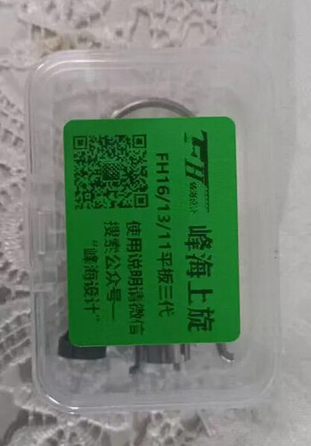

A couple weeks ago, I bought a barrel hopup from CyberTrigger and the label said “For User Instructions, please search for WeChat official account ‘Fenghai Design’”
I downloaded WeChat and messaged them but never got a reply back.
Does anyone know about them and the hopup instructions?
Looks like the LDT slim clones.
Slip on the inner barrel, they are usually a pretty tight fit.
To adjust, squeeze the end. The more squashed the end is the more hop applied.
They are pretty stiff so need a good squeeze with some effort, but they are also hard to go back to reduce the hop if you go too far so keep that in mind to not go to nuts on the squishing.
This one looks like it comes with two tongues to try, and looks a bit different to the LDT and clones of “slims”. to remove, use the wire tool to slide into the hopup holes and pull out.
I have used quite a few of the LDT and clones of these slim hopups. While they do work, don’t expect the best hop up but they are neat for ease of install and minimalist form that doesnt impact the aesthetics too much.
The Urban hopup is far better, but a bit thicker and longer, and a bit more effort to install.
