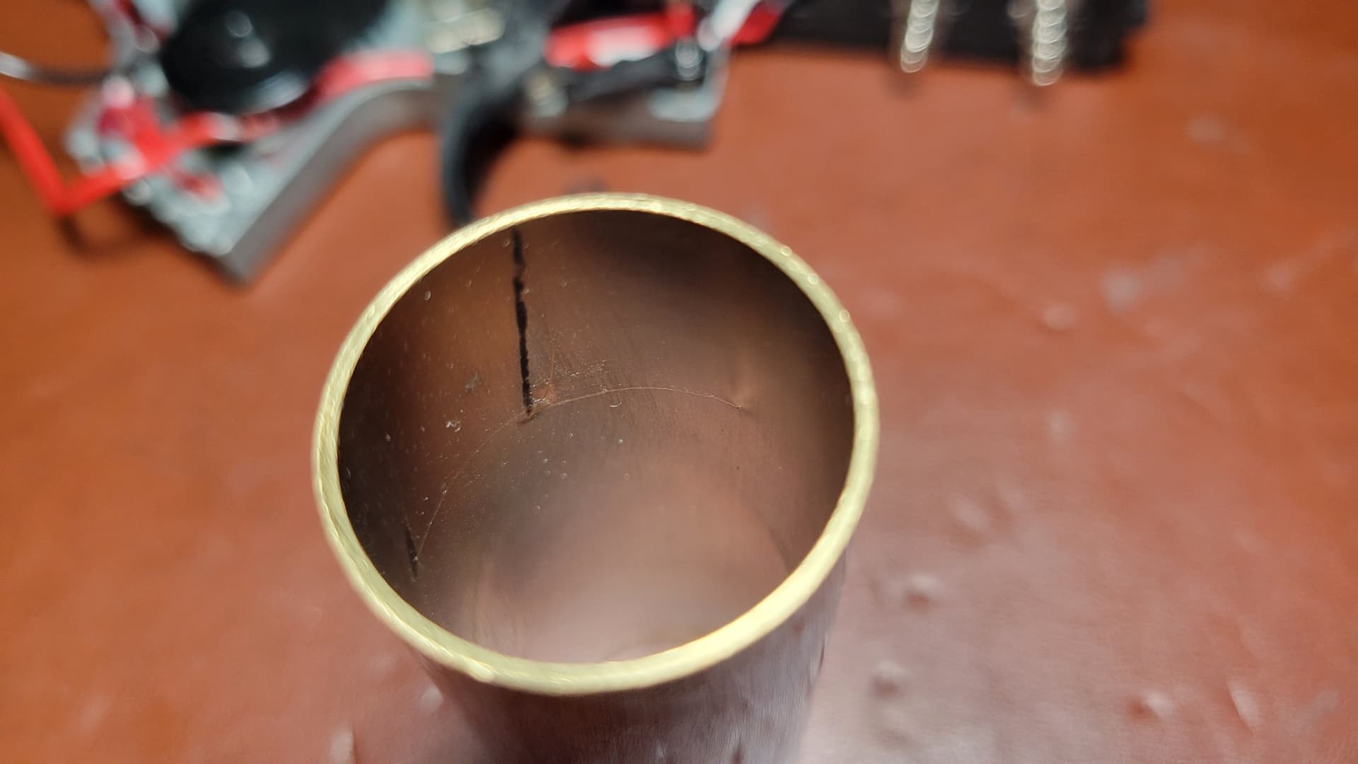

Looks like they have done a “wells”. Shorter cylinder and longer cylinder head to accommodate the extra tappet travel gel needs over those… “traditional” V2 gearboxes.
The old cylinder is 70mm, new one is indeed 72. I’ll take 2mm off over the weekend.
Friday fun one… :man_facepalming:
wtf is going on there, I said file not a 9" :joy:
The belt sander/disc sander combo may have been too aggressive :sweat_smile:
In all seriousness though I thought a piece of stainless would be fine. $30 Lesson learned!
Order that green og one, that will be the right size and save stuffing around :+1:
Got the green cylinder which fits no problems.

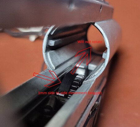

I’ve started with the new 18:1 gears and set the pinion to bevel gear mesh using the half shell method on Youtube.
After that the spur and sector gear went in, using the shims from the original gears. I’ve screwed the gearbox back together tightly and found that I cant spin the gears, but the sector gear has about 1mm of side to side movement.
I would have thought if there was so much side to side movement that they would rotate very freely, not bind up.
Appreciate any suggestions from here? I do have a set of shims on hand if needed.
No gears are ever exactly the same, and no gearboxes are either for that matter, if they were we wouldn’t need shims- but nothing is perfect, there are no specs and tolerance standards in this game!
Once you have set motor height, and shimmed the bevel gear, remove it from the equation.
I then do “parameter shimming” on each gear. Basically starting with the spur, then the sector (order doesn’t matter); add/remove shims until there is as little movement as possible side to side, but they spin freely. Only do one gear at a time.
Once the parameter shimming is done, re-install the bevel gear, and spur gear. screw together and check shimming between them, adjust until there is good teeth contact, but they don’t rub.
Now I leave a little more than “just enough to let light between the gears” like some do, because over time things can wear and move a little, and you don’t want them to rub.
bevel needs to be spot on, spur and sector around 70-80% teeth contact is fine.
Once bevel and spur are nice, move to the sector gear and repeat.
The best practice is to only change ONE variable each time you open and close the gearbox, that way you can backtrack, and identify what has changed.
Success!
It’s back together and seems to be working well. Between the forum members here, Low Guido and cyber triggers YouTube channel it was enough guidance to fumble my way through it.
