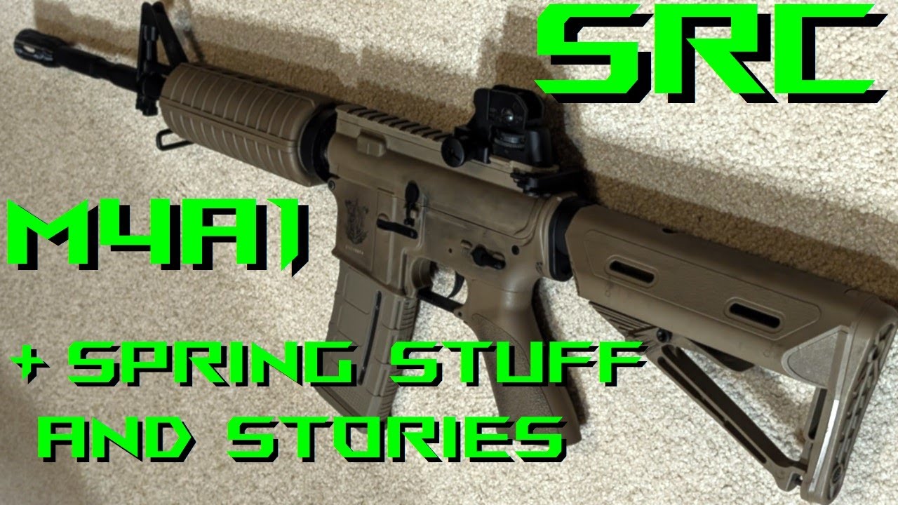

In the end I had to hand this one over to a professional. The Tamiya connector getting hot to the touch and the bevel/pinion gear making an awful noise after the gearbox repair needed checking
Rok was kind enough to 3D print a hopup for it so I spent about half hour testing the Rok Hop, compared it to an an Azreals 3D printed hellfire and an ihobby style hopup. The Rok Hop was the best of the three so it stayed on there and will do for the foreseeable future.
Played a 40 minute game and it ran really well, as mentioned in the video its a heavy bit of kit so I’m certainly starting to appreciate my smaller and lighter blasters.
This will be a backup / loaner from here on out and for that its perfect. Doing 330fps with good accuracy

And glad your happy with my hopup! At this point it has undergone many redesigns and tweaks, and I usually adapt the model to suit the amount of inner barrel protruding.
My 3d printing quality isn’t quite “commercial quality” but it does come in handy! Often remodelled to suit weird things!
And that blaster is amazingly heavy for a nylon blaster, I have full metal M4s that weigh in less by a good margin!
