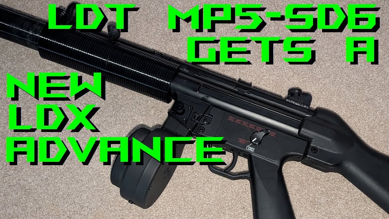

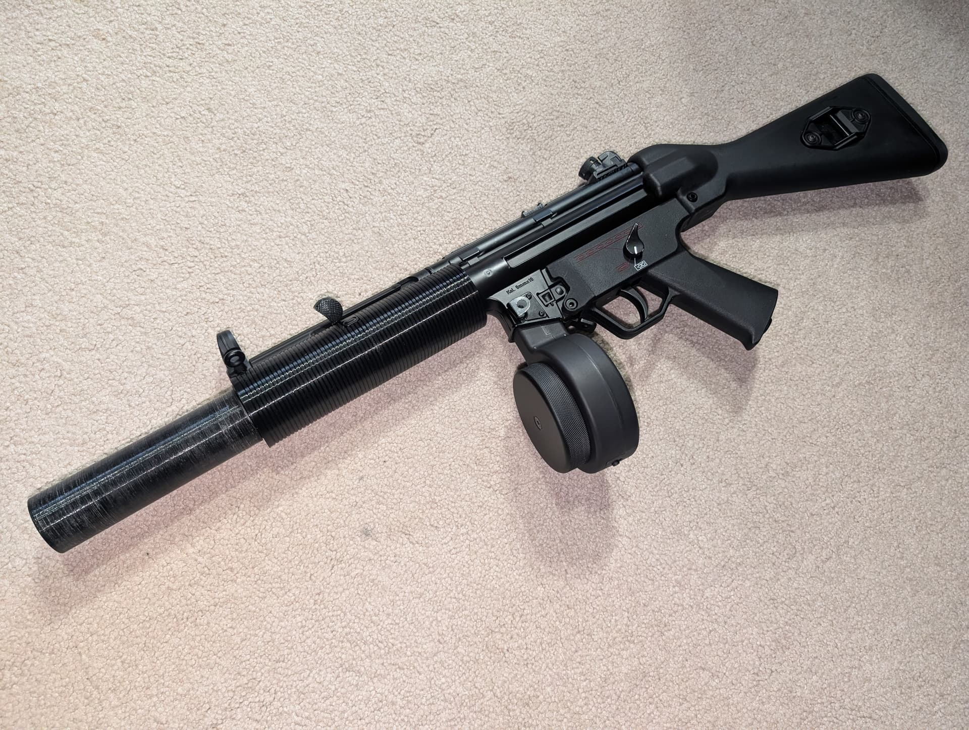

The LDT MP5-SD6 project is done… for now!
With the new assembled LDX Advanced, and 3d printed handguard and suppressor, and a T238 29k brushed motor it works well. Hopup hidden neatly in the end, and easily accessible by taking off the can.
Now for the fun. Stock spring is 260-280fps. Enough, but why not try the limits. I tried a variety of springs, up to M140 which pulled some well stupid fps . It worked and it lives! Only thing I changed, was the cylinder to a 90% to suit the 313mm barrel. Stock came with a 60% which didn’t suit so naturally I changed it. Other than that, the whole box is as it comes from LDT!
Settled on an M100 as that still got 340fps, probably settle down to 330fps with a bit of use.
Also used the new spring drum mag, which I am very happy with. Might need a second one.
Hold loads more gels than the traditional MP5 drum, and feeds flawlessly! And best of all there are no pieces, its one unit. You open the door, rotate the front, load gels and close the door, then let the front go and you good to go with around 280 gels.
Yes… there will be a video in time, though some is missing audio (F***ing microphone turning itself off!) but you’ll get what matters out of it and I will make it work.

You may have a photo.
Tried to sand the suppressor to give it a matter black look, 10 minutes in and gave up for the day need some more sandpaper!
Other than that happy with it atm

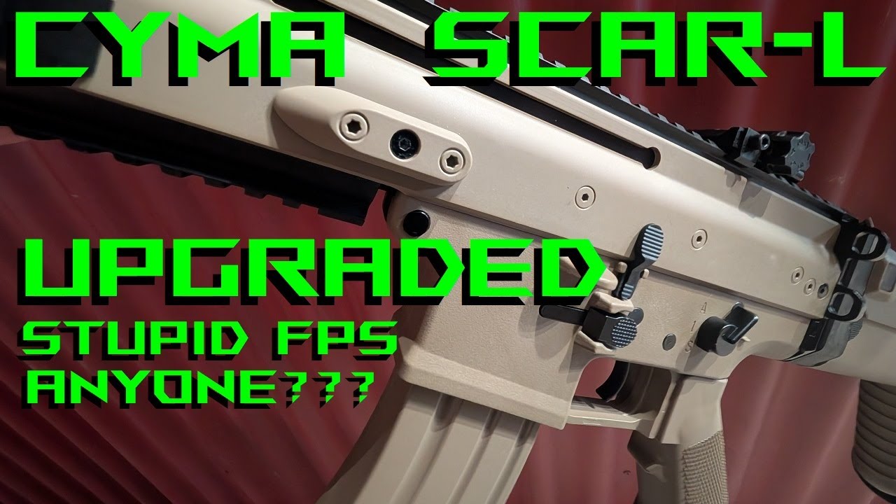

The SCAR was always scheduled for this week.

Reckon you’ll sell a few more Scars now.!!
Great performance for the $$…Why get a M110 HK417, to do 380 fps…?
Whoops, too late…!!
Just need to get a decent hop up onto this one…and see how much it hooks the gels…
Look forward to getting it back…!
funny how it did 275 stock…then 315 after spring upgrade…
then the drop in performance…
I suspect your right…it must be some lube/oil holding the seal initially…
That gets displaced after some use.
New Airseal fix is how they should be out of the factory…
Yes you may go through a few hop-ups taming the fps on it! Nature of high FPS unfortunately.
