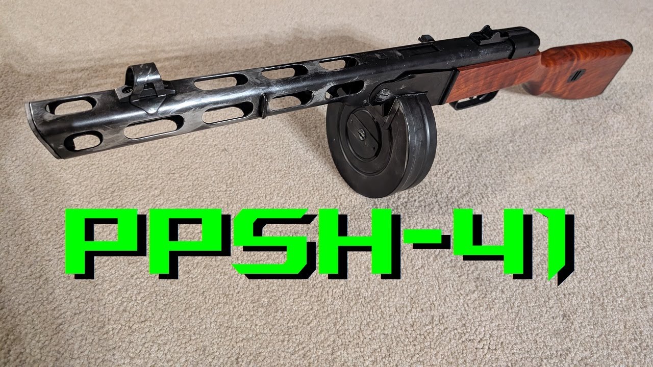

Anyone wanna see a video of @BME 's PP? :rofl:
So…
what you’re saying is…
“Grease is the word, is the word, is the word…
In the grooves, its not leaving…
Grease all the time, in every place,
Grease is the word…!”
Awesome vid, and great fix on the latch.
You should show that to Xforce…
When latches break, they can be sent your way, for a super epoxy repair…
At an approriate charge. Your repair design.
People will Need it. It wont work, without it…
You gotta seriously wonder, How they allowed such a tiny thin Plastic latch, to hold it all together. ??
Anyway, goes like a rip snorter now. 280- 290 fps is perfectly fine.
I agree, M90 equivalent it is, for a flimsy gearbox…
Any interest for you now, grabbing one second hand …??
Great result…!
Some Rub’n’buff reqd, for the Sten …
Soon T.M.
@Davbot71 …
i remember you had one of these…
If your latch ever breaks, you know who to see…
I was watching BME’s PP earlier, then I had a visitor… :rofl:
Interesting blaster, no words can describe better than a video or pics. :+1:
I burn a lot of wood Beemer, maybe I can help with the stock :rofl:
Definitely a nice replica and now a better performer without axle grease and other tweaks :+1:
