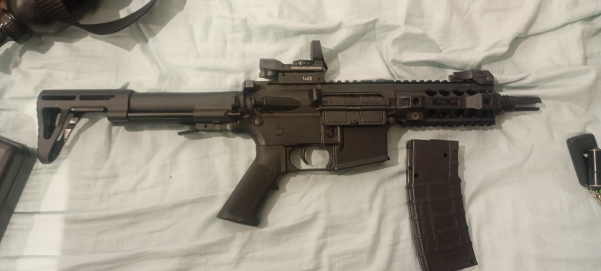

Given "hand-me down" m4 cqb. What manufacturer?
And what should I do to maintenance wise?
What upgrades are a necessity?

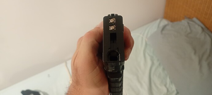

It doesn’t shoot the gels. They come up the mag. Then they fall out when I remove mag. So getting jammed somewhere. Trying to find decent video to explain these things.
I think it is a "wells m4 cqb ".
Imthe mag works but no gels are coming out it could be oversized gels, or a broken tappet plate or return spring. (one of the many “wells things” that can happen"
Check if air pulses out the barrel, and look up the tpieces to see if the nozzle is moving

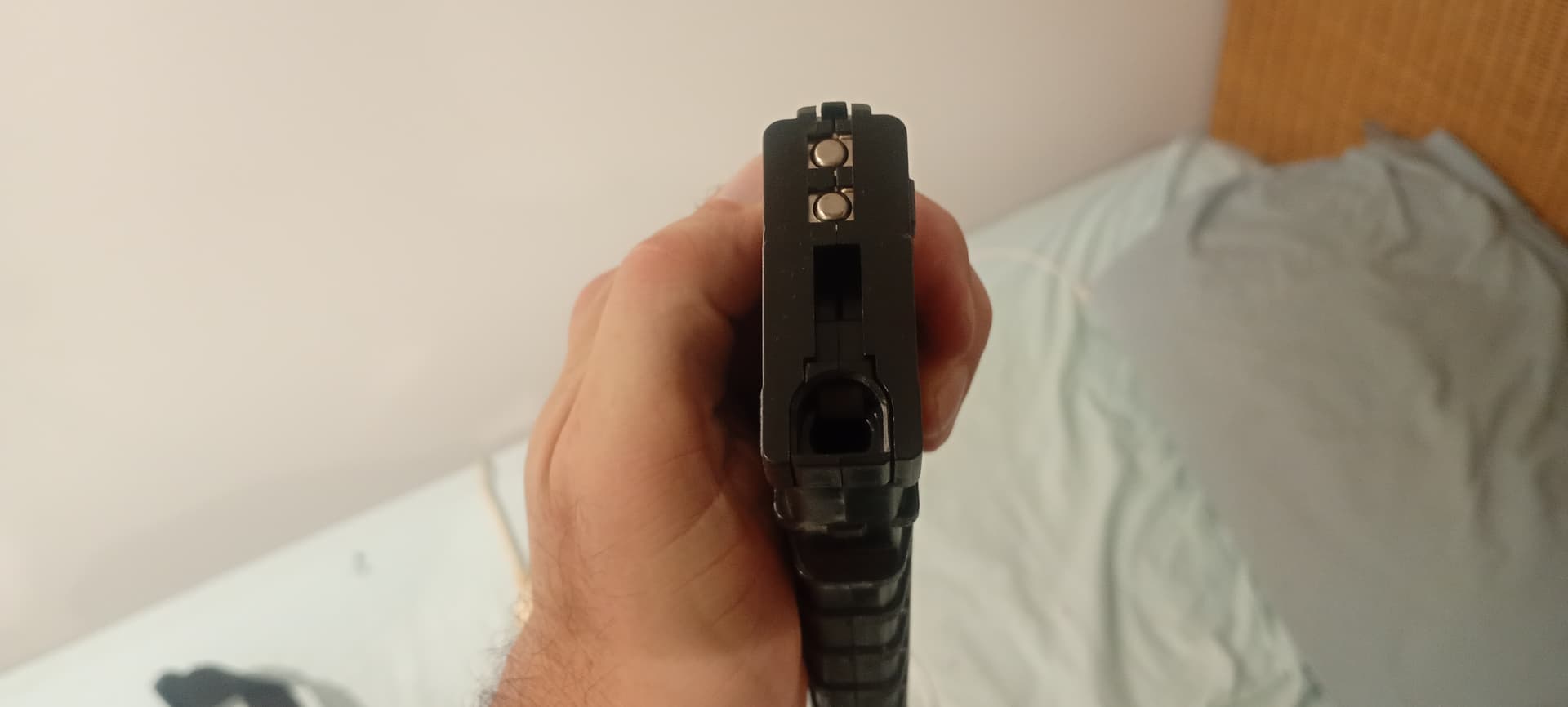

Nozzle moves. No air comes out barrel. If I tap trigger I hear a metal “clunking” sound
Gel size ! I pulled it apart . Cleaned , and understood how it works, put it back together…
Then I stuffed a 7mm hard foam bb down barrel with barrel cleaning stick Instead of 7.3mm gel . Pew. If flew out. Haven’t tested the mag yet. I’m growing some 7mm gels. Don’t want to fill mag with foam bbs .

Mmm looks very Wells things to me. Sorry late to the party but Rok already covered the possibles.

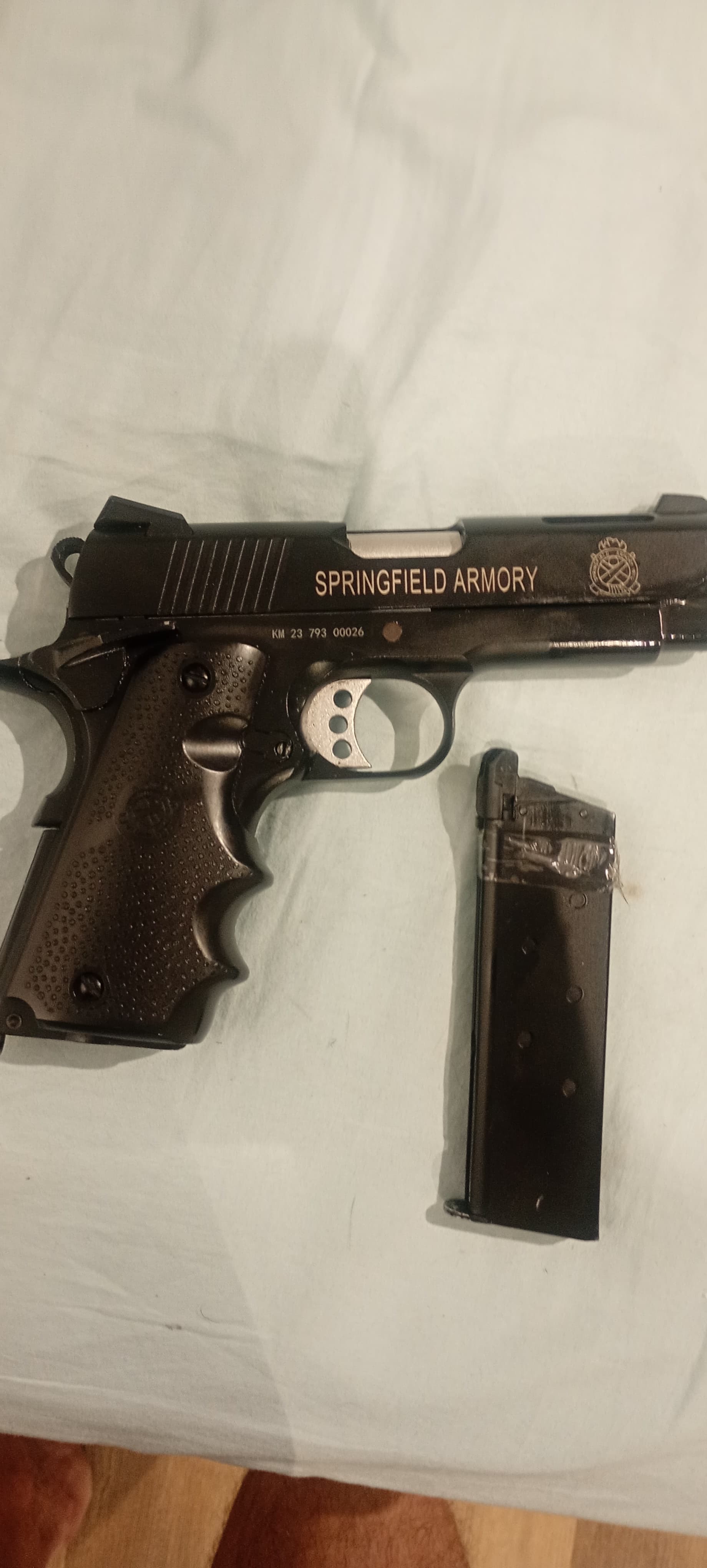

Though that Springfield is the most solid and well built gel pistol I’ve held . But… It has broken mag so never fired it. Lol. Ordered mag because no stores in far north qld anymore.

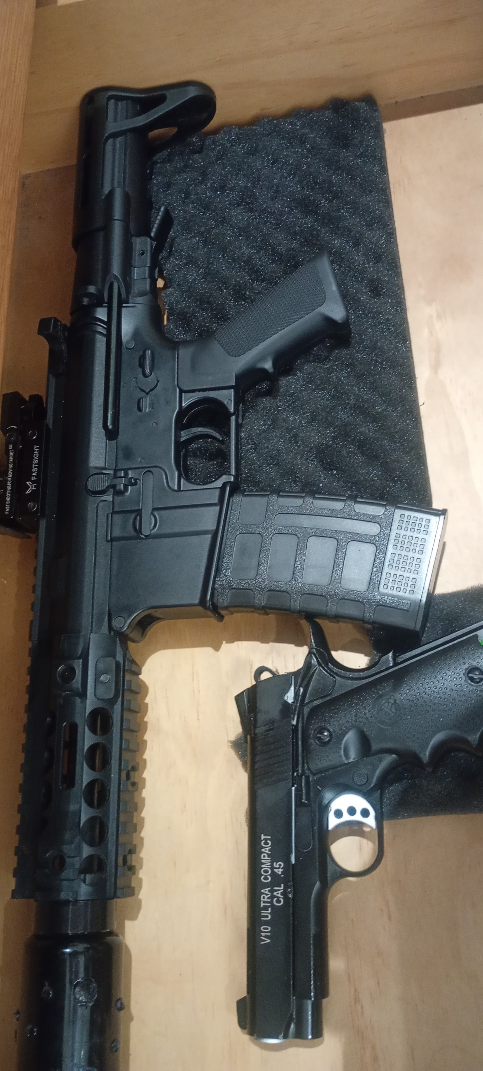

I zoomed in, I can’t tell but looks like a Wells dressed up by the crack heads at a retailer I won’t mention that threatened to kill me :rofl:
Doesn’t bother me, I said bring it ya pussy. Fkn druggos. :rofl:
Anyway when @RokSolid gets some time he knows them better than me and might be able to point you in the right direction.
If I finally own something worthy. Yes. I’ll melt all these down. And make a target out of the molten shit pile. A shrine to my introduction to gel blasters.
Bahhahah. Yeah. I was bored so I made a silencer out of a vitamin pill bottle. It’s off now. It wasn’t going to be taken out in public. I tried to cut out the shame in that pic. Well spotted

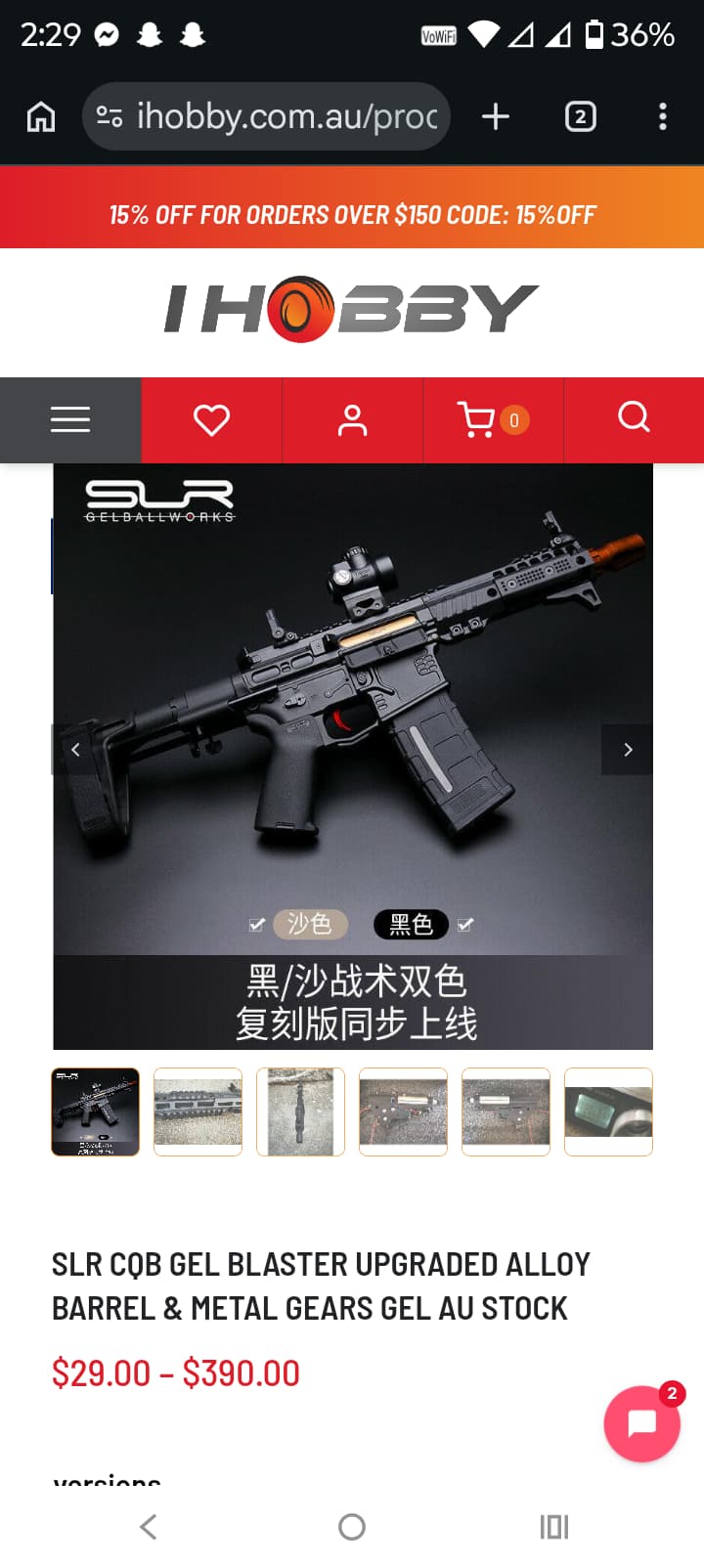

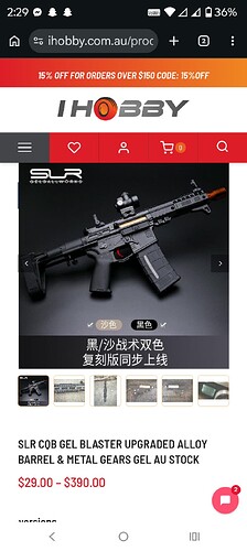

All good friend, why I pointed that particular one out. Reliable online ship to you, retailer been good for a long time.
$150 to your door. They are the go to for a few years now.
I see there is a Wells lower down for $200. They are good but take work.
Is that what you want, get an M4 then we’ll see about the 1911. I’m not experienced in those particular blasters but there was mag trouble I read.
Yeah rok mentioned slr. Looking at them. What’s the best gel gun you’ve owned? I know you’re all probably tired of my stupid comments. Like I said. No one up here that I can talk to about this. “Or tell me how bad my silencer look”. I needed that. :smile:
