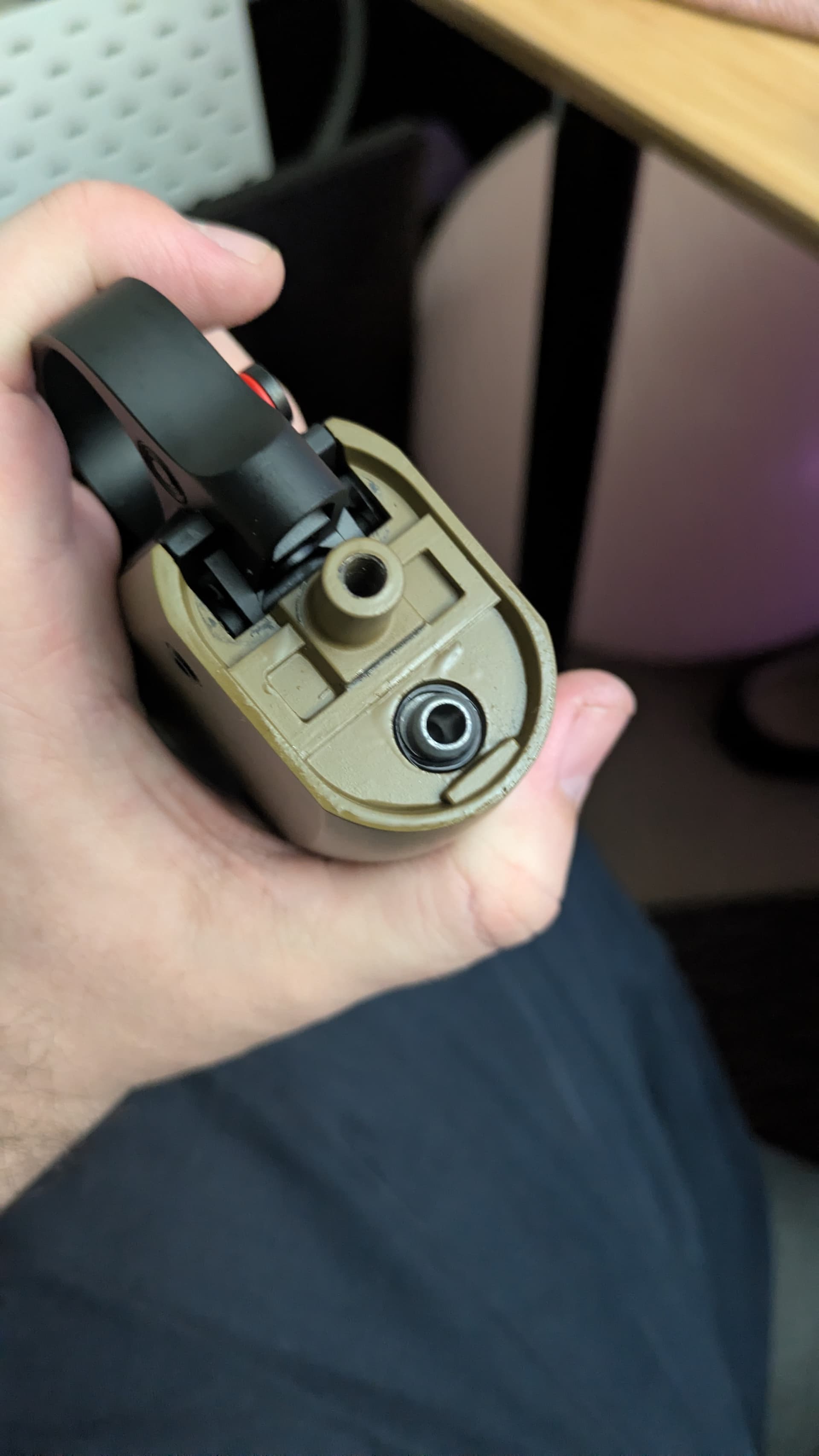

Huzzah!! I was able to fix my shotties leak. Lucky for me it was just the o-ring between the buffer tube and receiver where they connect thru.
Apart from the o-ring being rather thin, I think it slipped down between the intake and receiver and just wasn’t sealing properly, so I replaced it with a much thicker o-ring that fills the gap more so shouldn’t be able to escape.
All I had to do was taken the buffer tube off and the stock/grip piece and it was under there.
Holds gas and no hisses so I’m happy, sooo glad the leak wasn’t deeper :face_in_clouds:
Must be golden eagle things!! Mine had a slow leak, which was fixed the first few times by just tightening the gip screw, since I have the pistol grip with no stock version gas goes in the pistol grip on mine. Why would you make the main part you hold that also holds gas secure?!?!?
After a few re-tightening of the screw to fix the leak, I have to replace the o-ring.
Currently it will hold gas for a few weeks, but has such a slow leak that it will be empty over time.
There’s a single bolt holding the grip and stock adaptor thing on and that’s the piece that interfaces with that o-ring, you need one of those domed Allen keys to get it too cause it’s on an angle, them the buffer tube reservoir threads into that like how it does on real AR15s and that’s got an o-ring on the thread and gets sandwiches between the body and threaded ring…
I know the design is like 10yo at this stage but surely there was a better way to do it.
