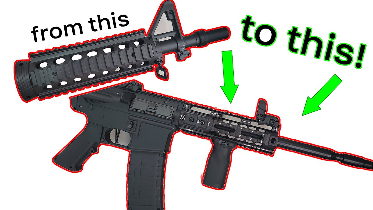

As @DocBob mentioned, some tricks need to be done. Would your gen 8 blaster similar to this one? Similar adapter may work on your one.
I used exactly the same handguard adapters on my Gen8 builds to add alloy handguards and outer barrels.
Do NOT attach them as shown in the above video
. Because the Gen8 is a clamshell Receiver, if you try and fit this adapter with the grub screws lined up central in the vertical position, they will simply bottom out exactly where the two halves of your receiver join together, which the grub screws will only split the two sides apart at the seams and not hold the adapter in place at all ![]()
I recommend turning the adapter 90° so that the grub screw holes are aligned to clamp down against both side of the receiver shell instead.
I recommend using longer grub screws on the adapter and drilling two shallow holes in the sides of the receiver halves itself for them to lock into more firmly……… only shallow enough to allow the longer grub screws to recess into, whilst still maintaining enough meat under the holes to allow the screws to still clamp down against the sides of the receiver.
This is the very best method that I found to ensure that the handguard and the adapter were as solid and secure as possible, which cannot be done if you follow this video tutorial or any other instructions that tell you to mount these with the grub screws in the vertical position.
For added strength, I would also drill and tap two extra grub screws on the adapter to give even more locking performance, but that’s not absolutely necessary…… only me being pedantic about my work! ![]()
