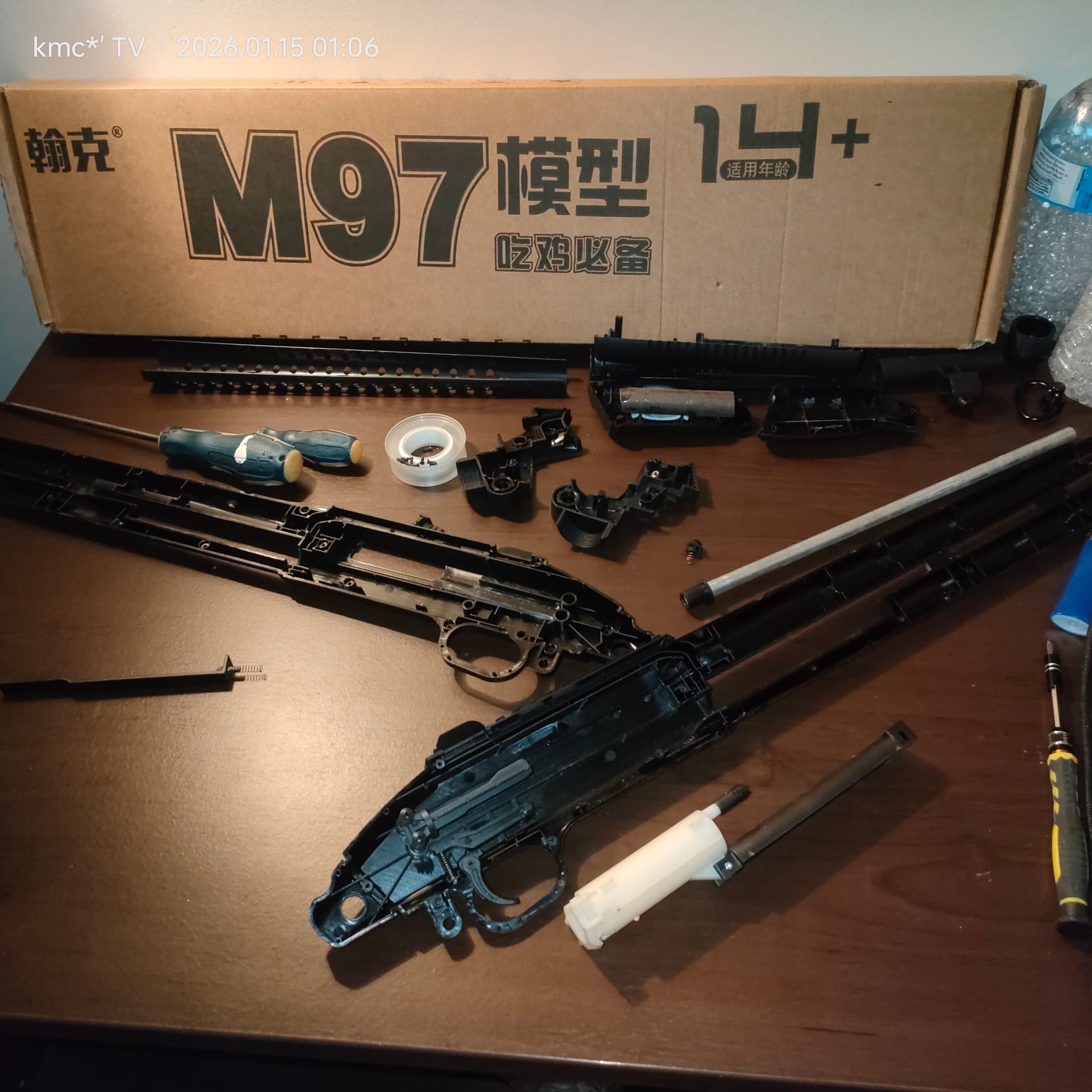

I started trying to pull mine apart to upgrade the spring a few months ago but couldn’t get it to split apart, I was worried I was going to break it and didn’t have my pry tools on me to open it up properly without breaking it so I gave up. felt like it it was glued almost
whats the best way to get it apart?
Remove the grip and pump handle, take out all the screws, take off the barrel cap and start pulling the two halves apart from the barrel end. You definitely don’t need to force it, comes apart very easily. There’s a link to LG’s teardown at the bottom of the OP. :point_up_2:
Sounds like you may have missed a screw somewhere if yours was being difficult.
Sounds like the barrel may not be seated properly in the collar or maybe you’ve got some flashing around it. :man_shrugging:

Especially, dont forget to remove the upper barrel shroud.
There are 2 screws in there…it wont come apart if they are still there…

Here goes nothing
Edit: threw an m100 in it… didn’t do something right and it’s jarred up first pump
Think I know what it was but cbf’d pulling it back apart tonight. I think I put the fake shell eject port the wrong way up and it’s catching on something. Should be an easy fix but too many screws to undo again lol
Dammit

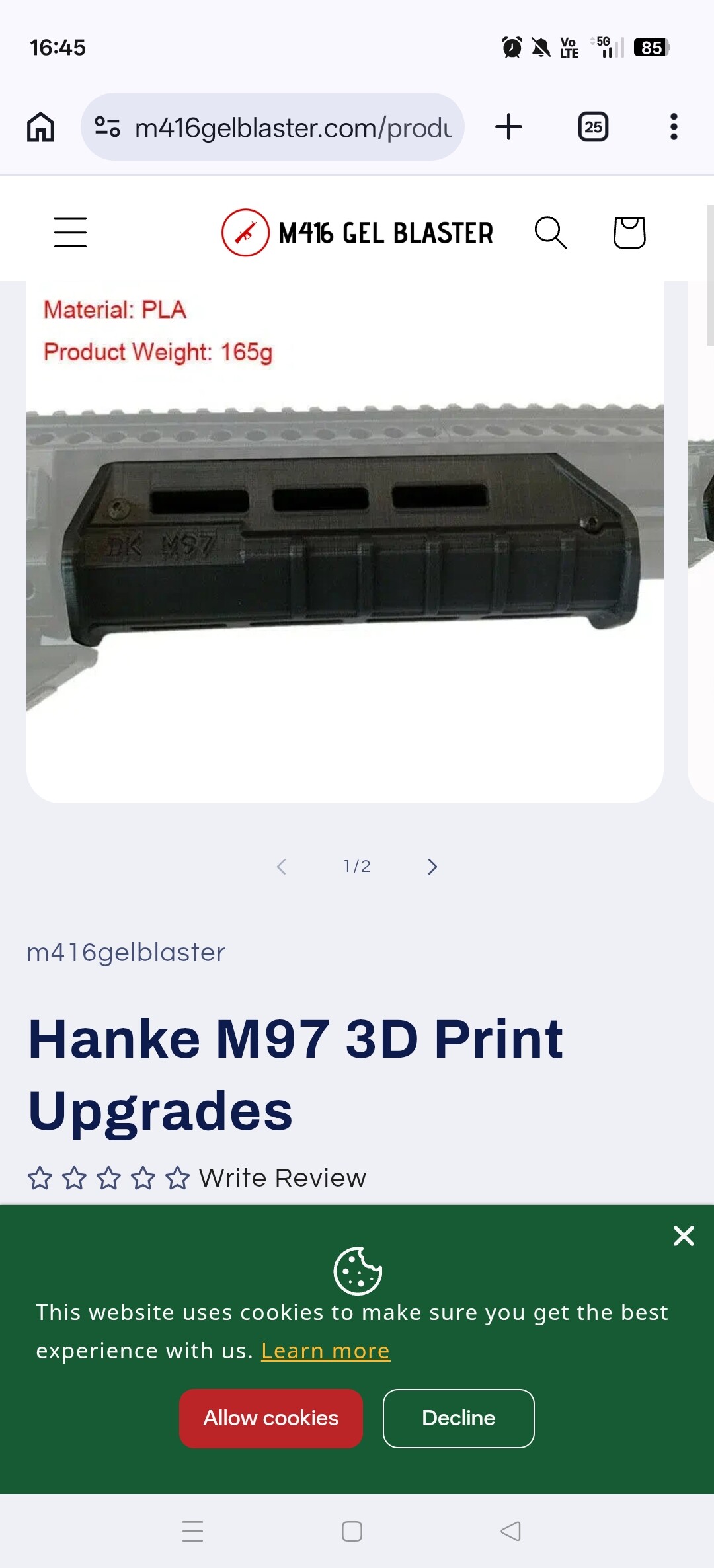

Does anyone know if this replaces the pump or if it goes over the top of the original?
Cheers
Replace, I’m sure…
The original was a few screws, and easy to remove.
Yeah friendly thought the same, Just wanted to be sure before purchasing as the screw posts are buggered on mine so if it went over the top it wouldn’t be very secure
Thanks for the info
