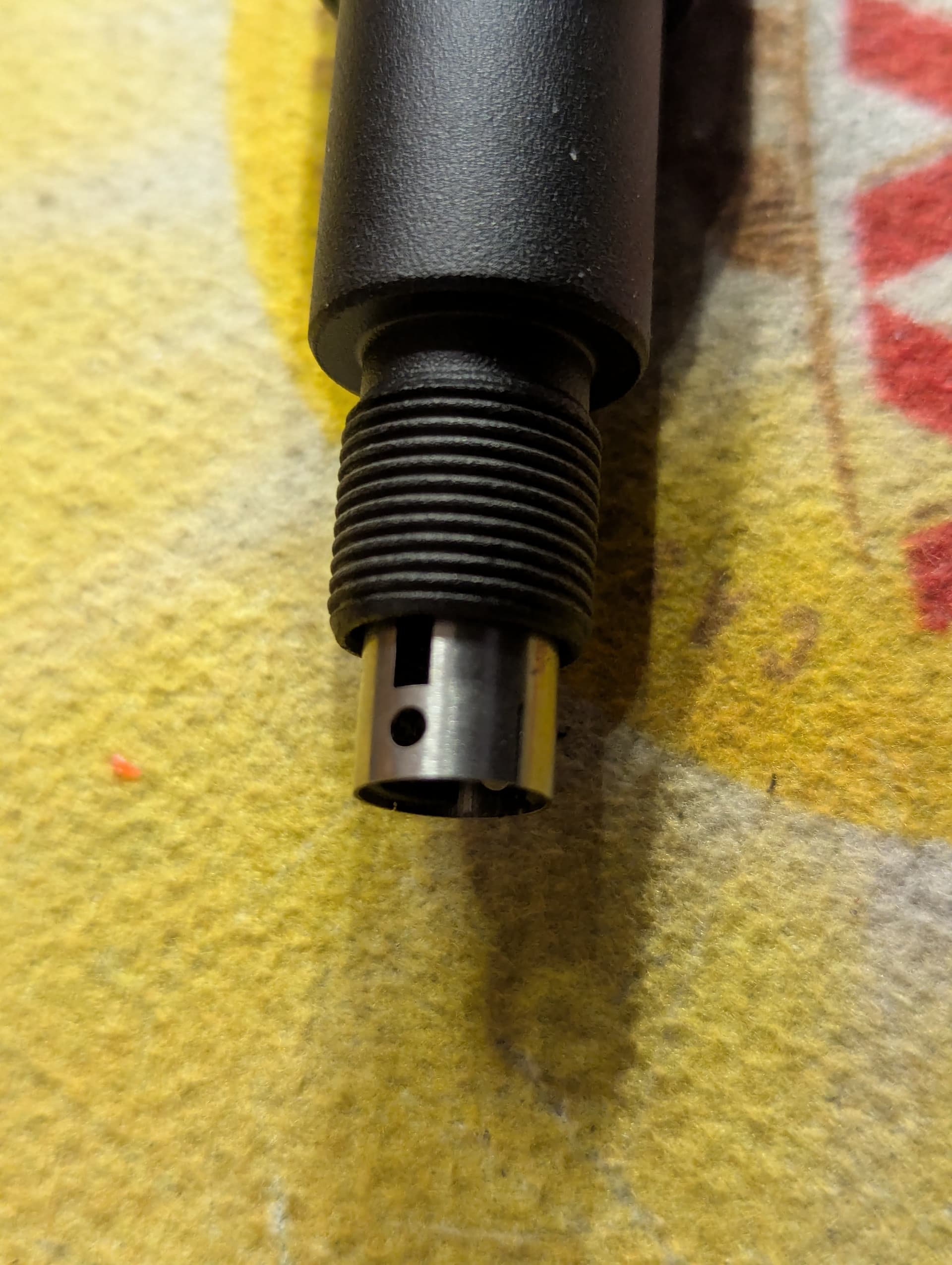

As for the volume, removing 55mm of inner barrel, cleaning it as best I could, and super strength epoxy was squeezed into the tpiece crack, which I may have caused on removing it from the blaster despite being stressfullyl careful about it,the resign BME applied at least kept it in one piece and the crack was only barely visible, but enough I had to leave it better than I found it.
I did add an ldt slim hopup from AKgelblaster, which is set to poke out the outer barrel just enough so removing the muzzle leaves room to adjust. But keeps with the classic beastly aesthetic!

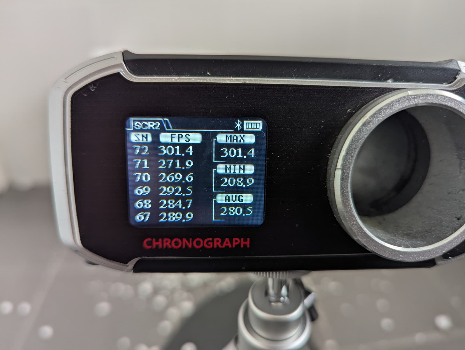

End result. It feeds, and does it mash styrofoam?
You bet!
There will be a video soon, and it won’t be a short one. Fun was had and it is always cool to work on something different.
