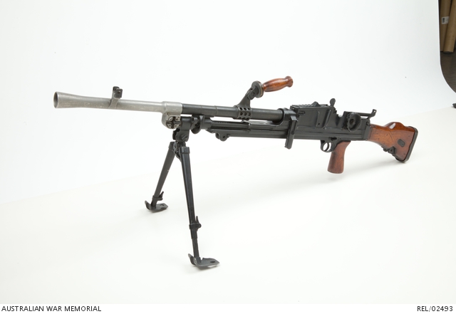

This is the proper Bren model that’s so well known.
A very different beast but can easily see where they stole this design from!

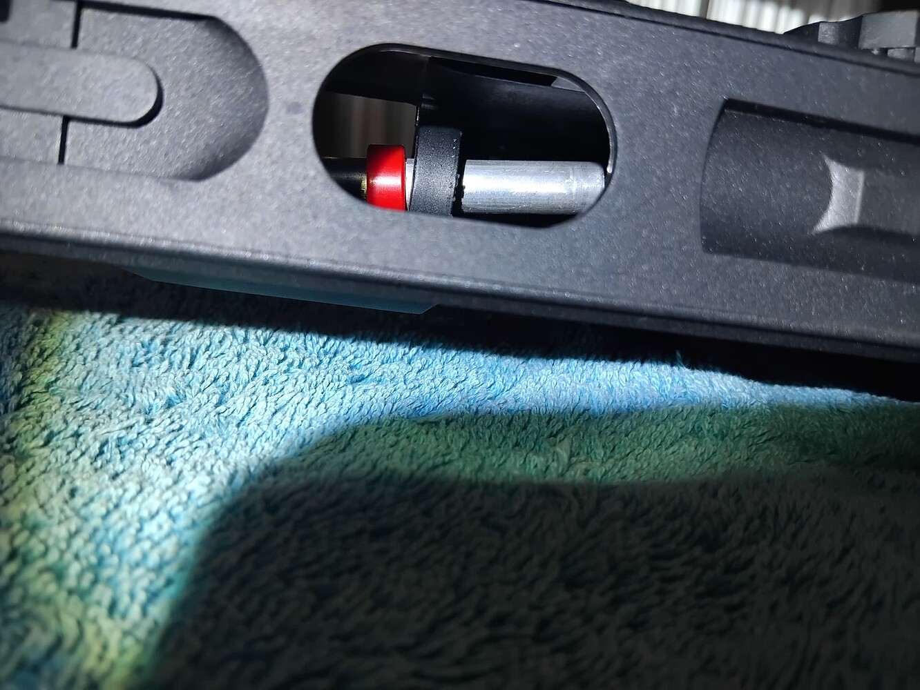

@DocBob @BME Hey guys i brought a ZB26 from GBU and it has arrived no red piece on the inner barrel, the GBU guys said it is fine and they don’t have the red thing anymore. Anyway i am wonder if i can just use some tape- Duct tape instead of glue as i cannot be bothered doing such a permanent solution, will this work?
As per my previous photo, the orange ring is a locator.
It’s a loose friction fit, to hold the barrel in place.
Honestly, OOTB performance is pathetic…
And part of that is the nonexistent seal, with the barrel into the tpiece.
So, yes, you could wind tape around in loops, to build up a friction fit locator…
But that will do zero for the air seal.
If you can live with low fps…fine…if not…pull it apart.
Also worth mentioning the t piece is super fragile…I’d be reinforcing it with resin from the get go.

I see, with the tpiece i meant to use duct tape around t-piece and barrel connection to air seal it as a low effort solution?
The barrel fitting and sealing in the tpiece is a minor air loss compared to the piston o-ring.
And be VERY delicate with the tpiece. There are no replacements, no second chances. If it cracks you will need to repair it. And the design of how it goes together does not lend itself well to a low risk of breaking it.
If confident in teching… it would be best to install the tpiece to the barrel outside of the blaster, then rebuild the entire blaster starting with the barrel assembly, the installing the gearbox last.
I wouldn’t say it is hard but it is different to most blasters, it is cripplingly under volumed. So the o-ring and tpiece seal is half the challenge, see my post back a little for the rest.
