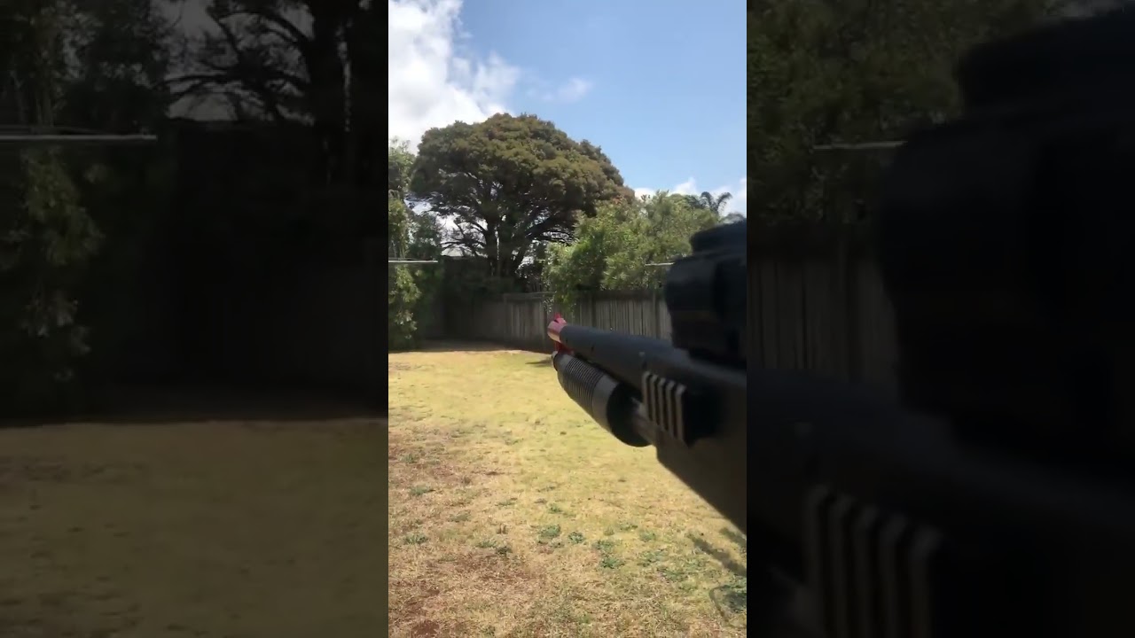

So I did this a little while ago. But I had an old m97 that I bought when they came out. At the start some fired 2-3 gels. But then they got “fixed” to fire one. I wanted to have a shotty that wasn’t a gas based shell as they can be a pain to maintain and expensive. So I decided to rip out half the internals. Design and remake it so it can shoot a proper amount of gels.
So after a couple weeks and some changes. My m07 now can shoot up to 11 gels per action. All spring powered to so all you need is gels and the blaster.
A couple quick notes. A hop up can be put on if I wanted to increase its accuracy and range. As it is it’s about 15-20m. For a shorty that’s all you need tbh. I need to get a back holster for it.
I’m also working on installing a black light strip so I can use glows in it for indoor or cqb games

that’s sick… some glow action in the shottys will be dope… looked pretty accurate for the most part of the video…
