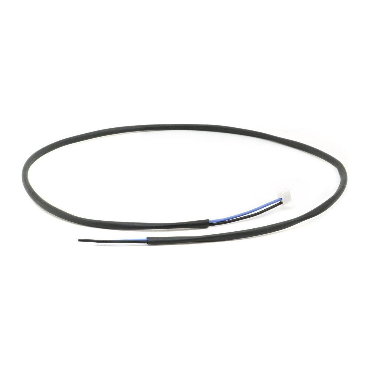

How do you run the magazine’s but with the kythera as there’s no electricity? I’m super curious only thing that stops me getting one can’t find any info online.
You have to run a battery for it.
need to run a battery only small one
mag wire and terminals it connects to the MCU board
