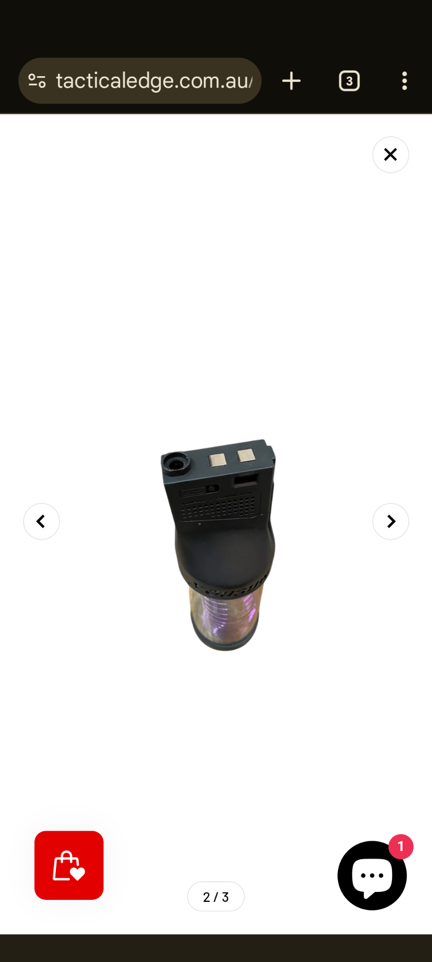

Update: I found a spring powered mag in my country. But there is a problem, the mag is high catch and I’m working on a low catch receiver. Does anyone know how do I make it click in my receiver? This is the only spring powered mag that is available.

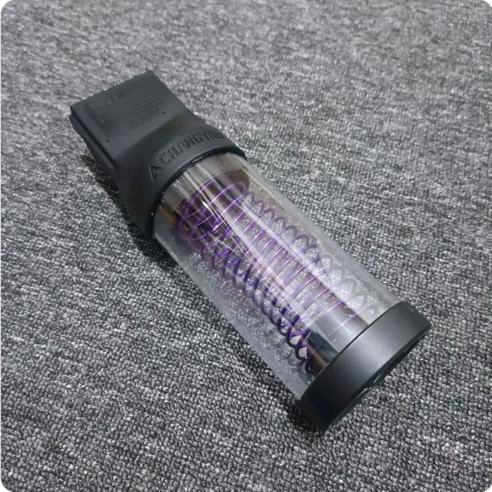

The spring powered mag is a Yousun/Chuangyan Bottle Mag.
99% sure that’s got a motor in it like those LDT spring mags that have the feed wheel at the top…
Yeah it’s a powered mag
All the spring does is push the gels into the feed wheel, in this case a worm gear, to give consistent feeding and feeds even if the blaster is upside down or sideways.

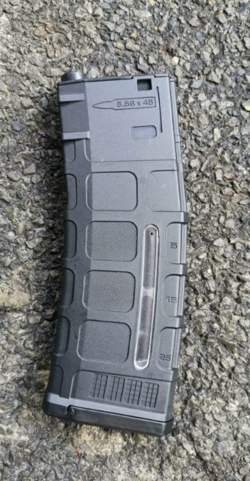

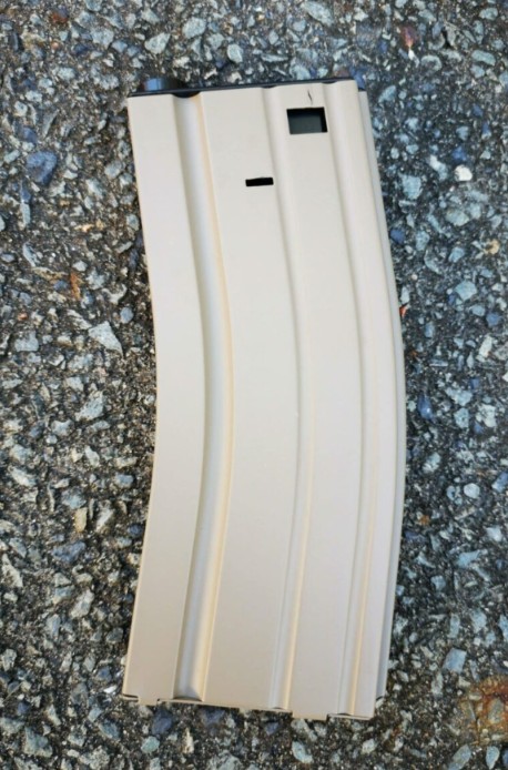

At work atm but…

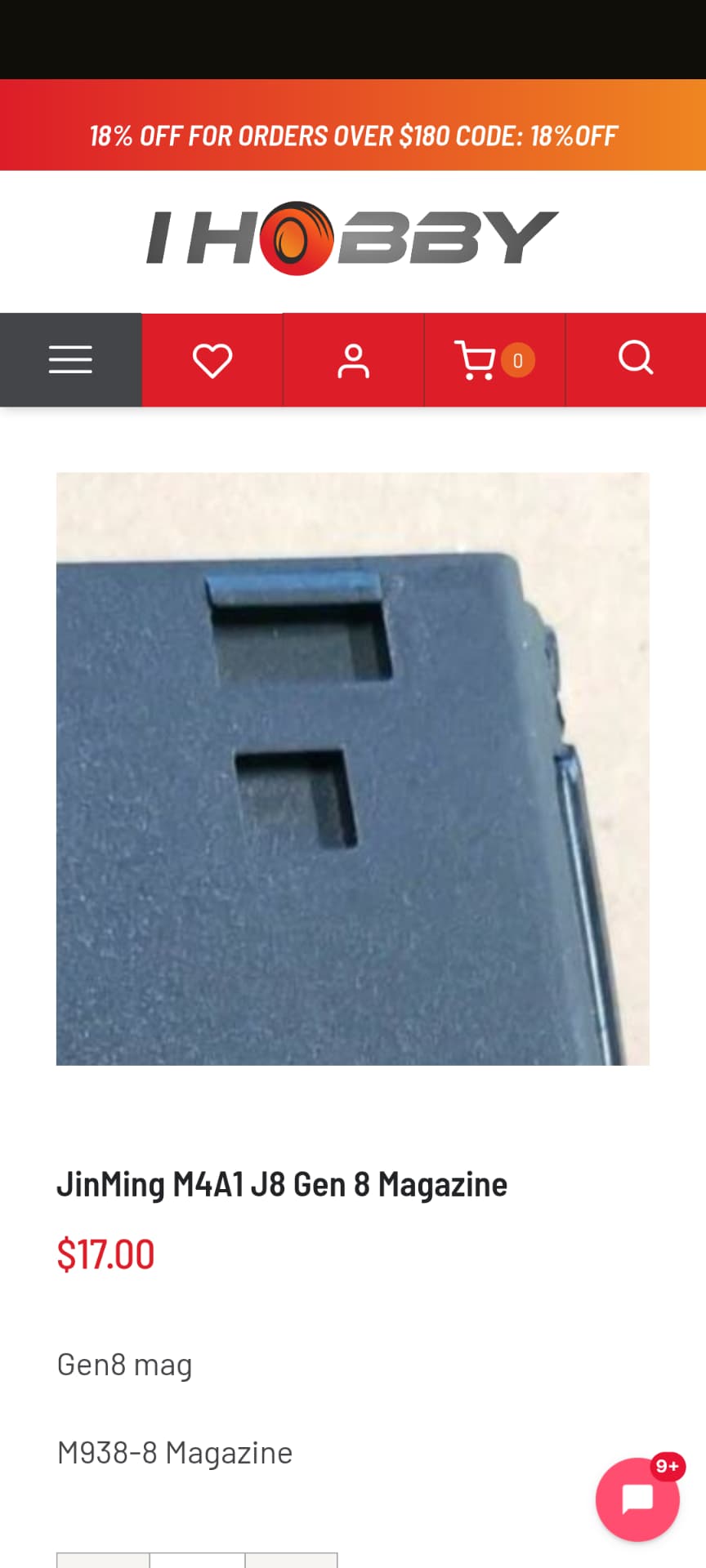

This is a cyma mag
And this is a JinMing mag, Gen8 standard
See how the cutout on the top right is at different heights. Basically to get the mag to fit in the other blaster you’d need to cut the corresponding hole into the mag.
Some mags like this other JinMing gen8 have both cutouts…

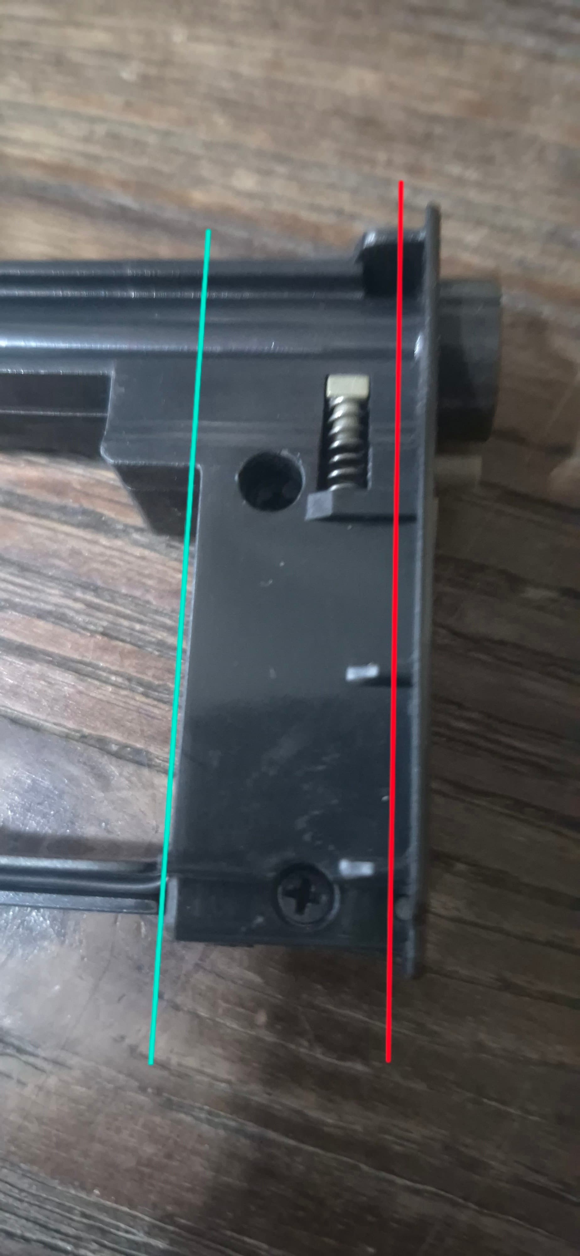

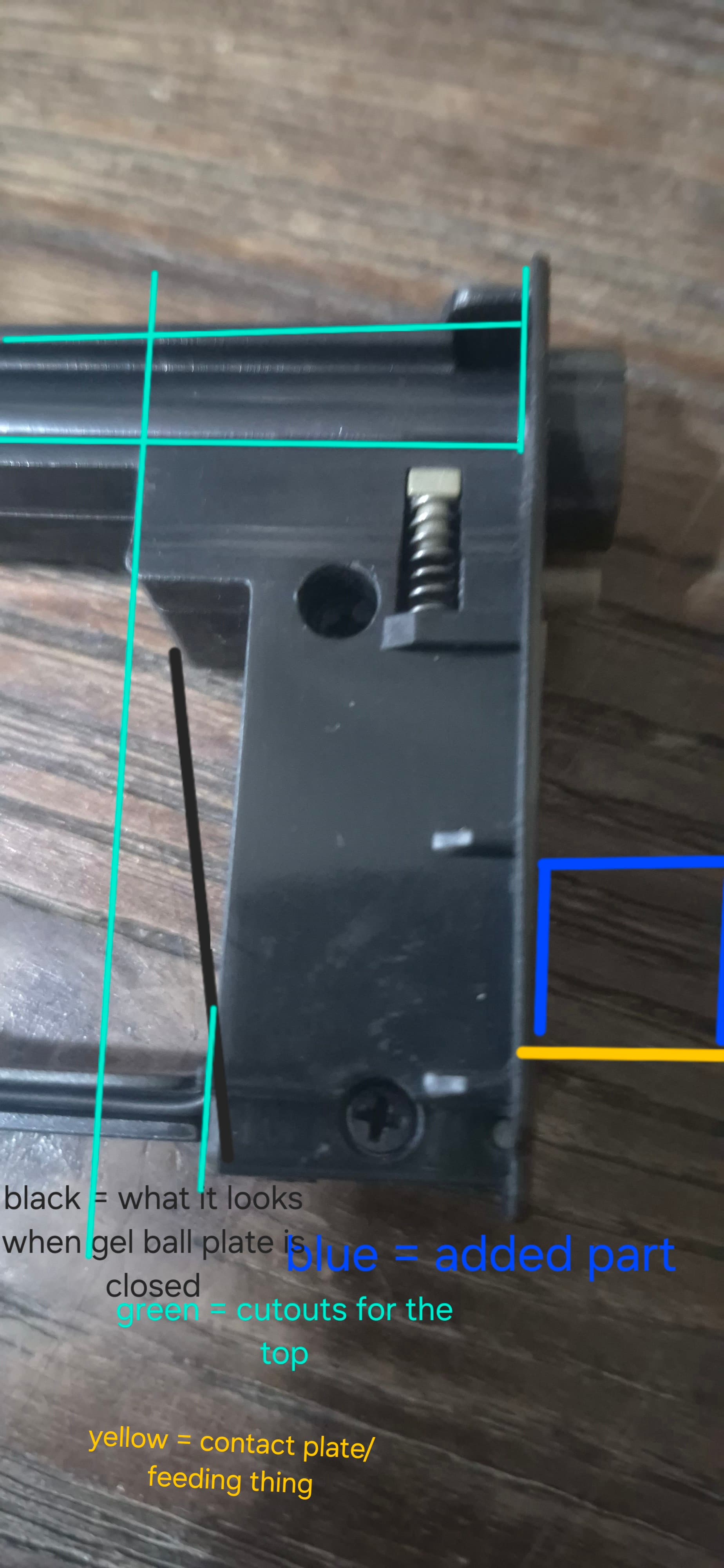

An update to this: I found out that my CYMA M4 mag is 2cm wide inside, and also the area near the contact plates are about 1.5cm wide. So should I buy a 1.5cm wide spring then cutting the bottom part or try to cut the top magazine with interfering the gel release button (basically cutting the mag and only leaving the top part then superglueing it to the mag shell).
So so I cut the green one or the red one?
Well the green will retain the stopper, that little pin sticking out that stops gels falling out when not in a blaster. In saying that, it probably won’t work or feed properly anyway, Azraels Armoury had tried to develop a mag like that with no success, even after putting quite a bit of money into it too from what I hear.
If you’re set on spring powered mags something like what they use for gbb is really your only option currently, a single tube with a long spring and a follower.

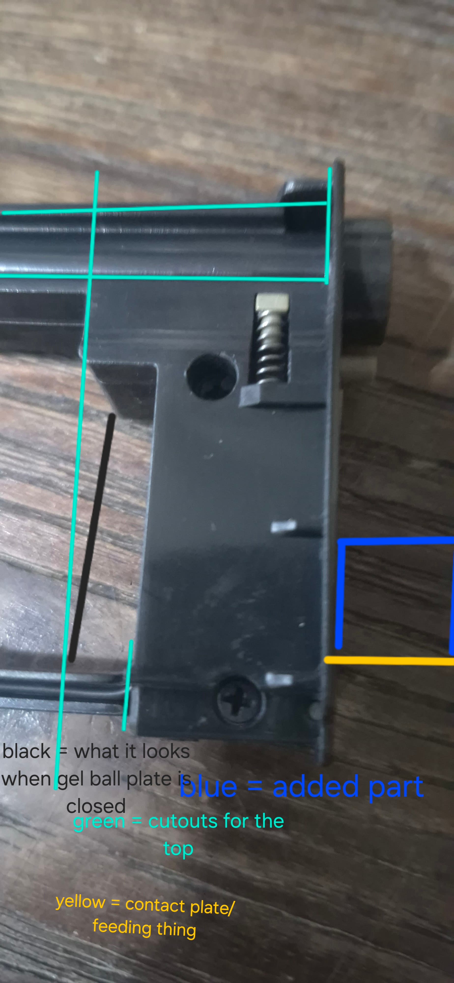

I haven’t bought any new parts for this project yet. I’ve done designing the cutouts for the magazine. The design leaves about 3-5 gel balls still in the mag tho.
Design (black = what it is supposed to look like when yellow is closed)
A redesign because the last one may leave some gels stuck other than the tube
