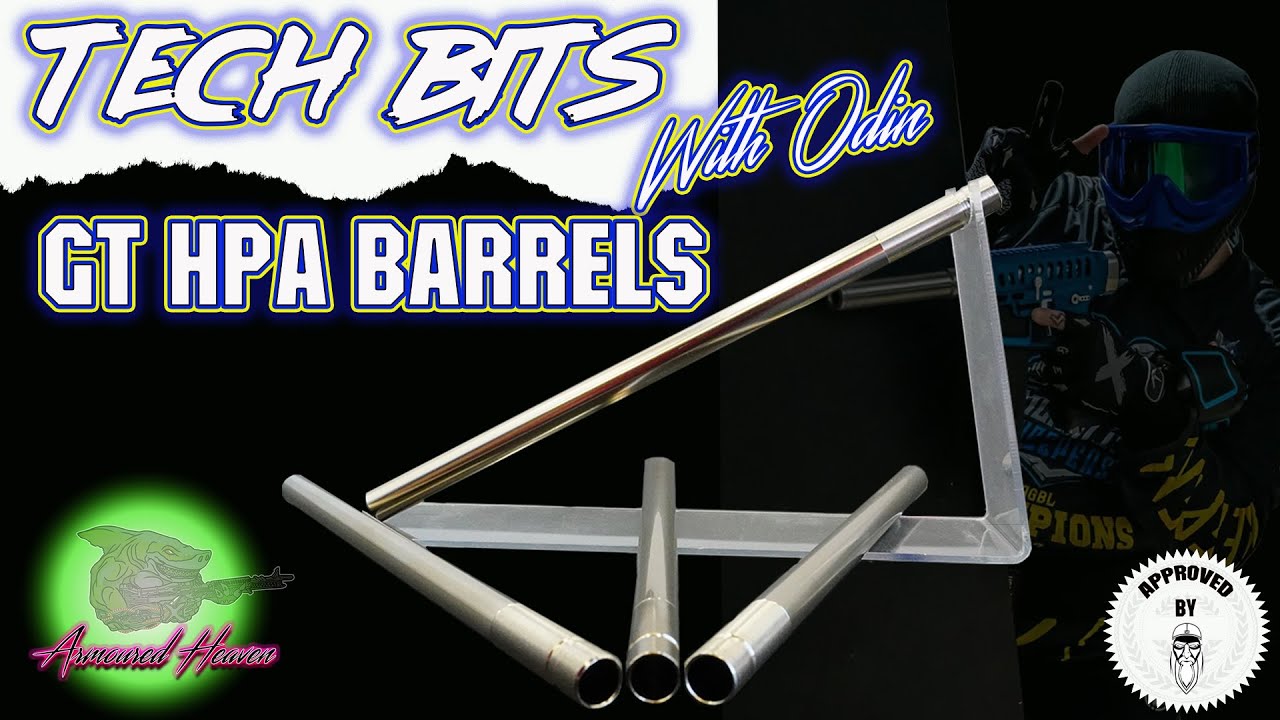

Just when I think I have made up my mind on 7.5mm stainless for my barrel I find this
Teflon infused nickel plating on a copper HPA barrel.
Supposed to be slippery as possible and super accurate.
Stock seems to be intermittent and not sure if 500mm is available, have sent them a message and will advise the outcome.
Sounds like witchcraft but if I can get accuracy out to 50 meters I’d sell my soul (or at least sacrifice a goat) ![]()
