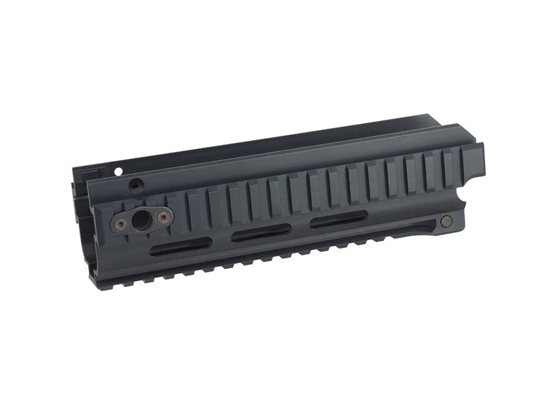

If anyone wanted one of those Remington handguards for an ACR Ausgel have some on sale for like $40, although its the plastic one it says

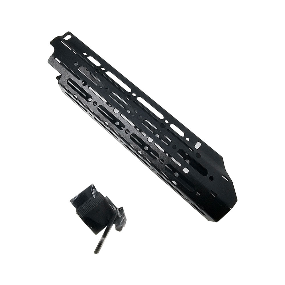

@DChapo nice handguard… shame it’s not metal but that would drive the price up. . Lucky I like the Masada style handguard on an ACR. ![]()
SIXmm have a few ACR parts, an alloy RIS handguard for Masada AEG… might fit.
