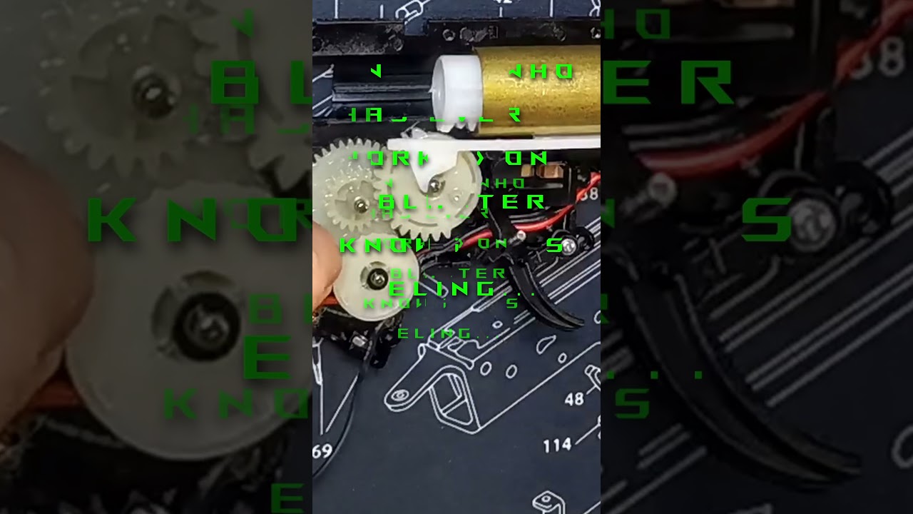

Anyone who has worked on a blaster knows these feels…
A little part/preview of the video from initial ACR/R upgrades
