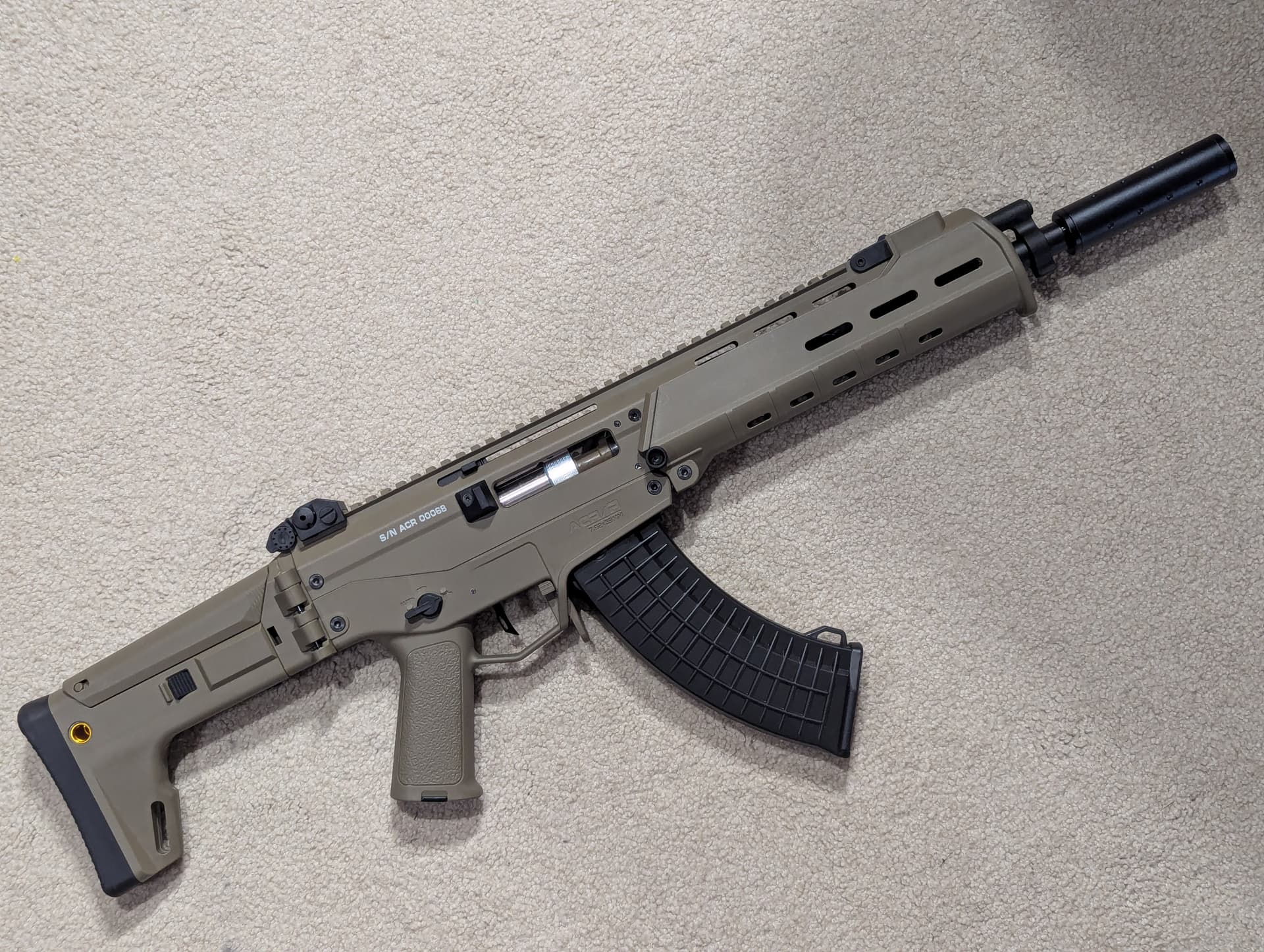

Final touch to the ACR.
Angled foregrip on the Masada Magpul handguard.
Love the angled grips. They suit me and look good!
I epoxied a 14mm ccw to 19mm tube adaptor to my ACR metal barrel. Leave that to set while I play with the gearbox and get it fitted.
Was it only the ACR-R available in 7.62?
Kinda wished I had kept my couple of old ones just for something different to hang on the wall with the other different models. :sunglasses:
Available in 7.62 x 39
Cheers, yeah they definitely have a better look than the run of the mill 5.56 that is so commonplace.
I prefer the 7.62 version.

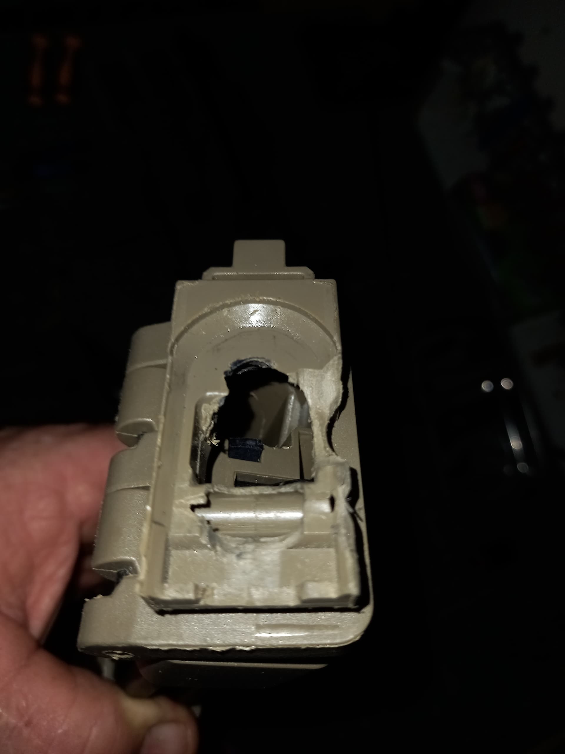

Got the brushless 25k t238 fitted, filed out the gearbox screw holes in the motor area and the wiring holes… and shimmed 12:1 gears…
Now to rewire it to the front… tomorrow :joy:
You need to hog out some of the nylon around the front handguard pin so you don’t pinch the wires. Also found that separating and gluing the wiring to the edges of the receiver helped to stop the wiring getting caught under the t-piece.
(gearbox isn’t screwed together in the pic
I have front wired a few m4s before. Easier in the gearbox, harder in the receiver!
I enjoy making wiring, but won’t lie I am prepared to use plenty of “working words” for this one!

Have fun trying to change the spring with just removing the upper and stock. There’s still some meat at the back of the receiver
Might be an ACR/R with an MK box thing… I have already tried and it works well. Once the upper is off, rear pin out and stock slides out no worries.
Where the real caveat is… the upper is attached to the wires, now requires removing 2 pins and 4 screws to remove the entire barrel assembly to free the wires!
