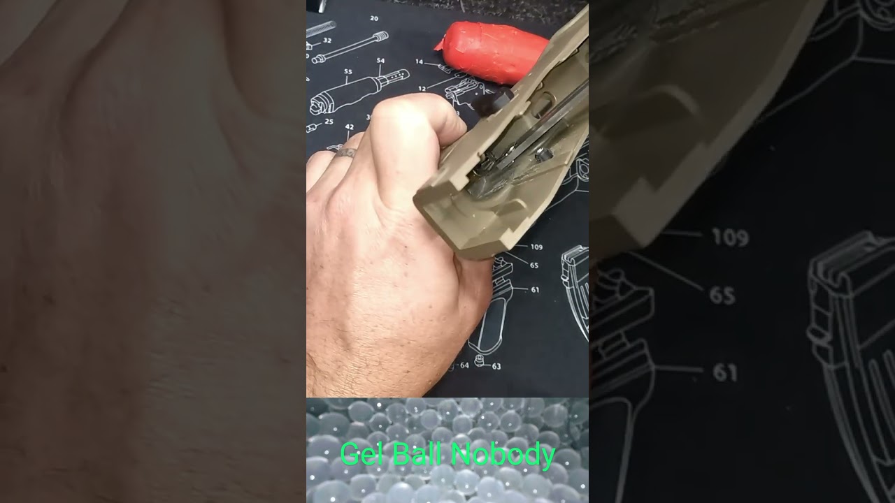

Been subscribed to your channel since the early days mate, but have NEVER had a YouTube Shorts video appear on my feed until just now!

Well I guess I like to party because this came up on mine :rofl:

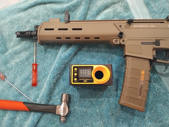

ACR/R is done. Rewired it but didn’t bother with a connector between upper and lower, nothing I had was small and convenient with decent amp carry etc it isn’t that hard to punch two pins and a few screws if I want the gearbox out.
Main reason would be to change the spring anyway, which I can do by punching three body pins and lifting the stock!
Video will come… also made good progress with the new blaster, though needs one more open up to change a nozzle, cylinder head and tpiece… decisions have been made!
First full pull-apart and rebuild.

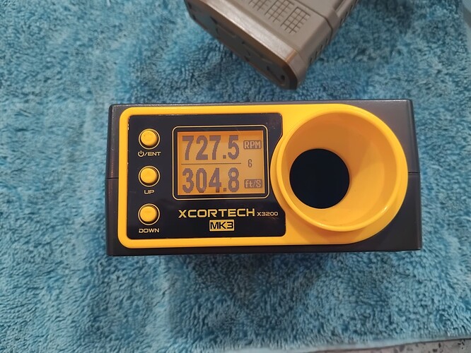

The ACR got the metal barrel upgrade, new O-ring and M95 spring.
Got the old plastic barrel out with the hot water trick. epoxied a new 7.5 mm xforce barrel in. Same length as old barrel, i didn’t want a longer one.
Old Oring was buggered, 6 yrs old, no surprises there.
Plenty of gear grease on the gearbox shell, that got recycled and reapplied.
Air seal was crap originally, new oring was an improvement, but nowhere near airtight.
Still, i just kept all the old piston, cylinder head, tapper plate etc…this was just a quick upgrade.
Quite a few spinner screws re assembling the gearbox, they must have been over tightened at the factory.
Thanks to @Friendly_Fire for the super-glue/screw reattaching trick, it should hold together for awhile yet.
I figured out the rear stock / door trick…after it caught me out.
It wont go on later, attach the stock when putting the gearbox back in the receiver.
I had to pull the box apart again anyway, anti reverse latch wasnt holding properly as i was getting some backwards running after finishing a burst, and one or two dribbling out…
Anyway, alls well that ends well…
Pretty decent for a M95…now about that front barrel wobble…

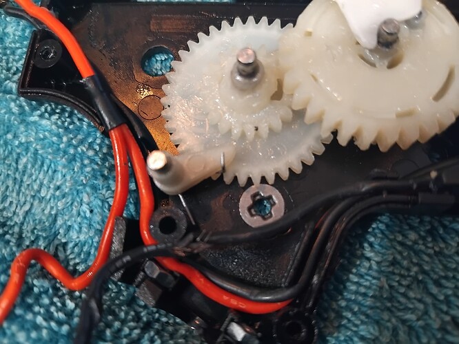

Any easy way, to repair chewed wires in the gearbox??
Some bare wire exposed on the black wire…

As for the wire… Heat shrink if it fits… or replaced the offending wire and terminals is the best but the most work.
If you don’t mind leaving it overnight… some liquid electrical tape is a good fix… messy to use and sometimes you do get the results needed the first time but it does work. Not cheap stuff though. It’s actually cheaper to buy wire, terminals, and heatshrink and do it properly.

Those damaged wires… as RokSolid said, heatshrink.
One good way to guarantee it doesn’t happen again is to dremel a slot into the gearbox shell so the wires can tuck into it well away from the pinion. Maybe a dab of hot glue to secure. War Interest boxes suffer from the same problem… same fix for them too.

With the heatshrink repair…
Can you slice it down one side to open it, push it over the frayed wire, and then successfully shrink it on.?
i.e. cut off a small section, say 1cm long…then slice it lengthways down one side.
That would enable placing over the affected wire, without feeding from the top or bottom. Then shrinking.
Does that work.?
