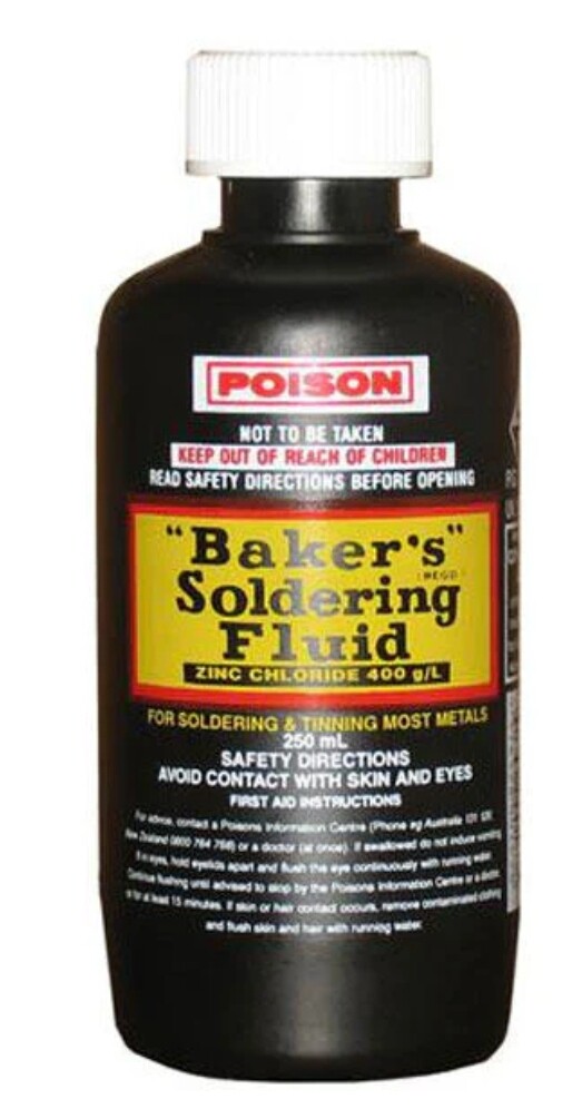

Get some of that Liquid electrical tape if you can’t be arsed soldering.
Dead easy if you use this stuff…
Hard if you don’t.
