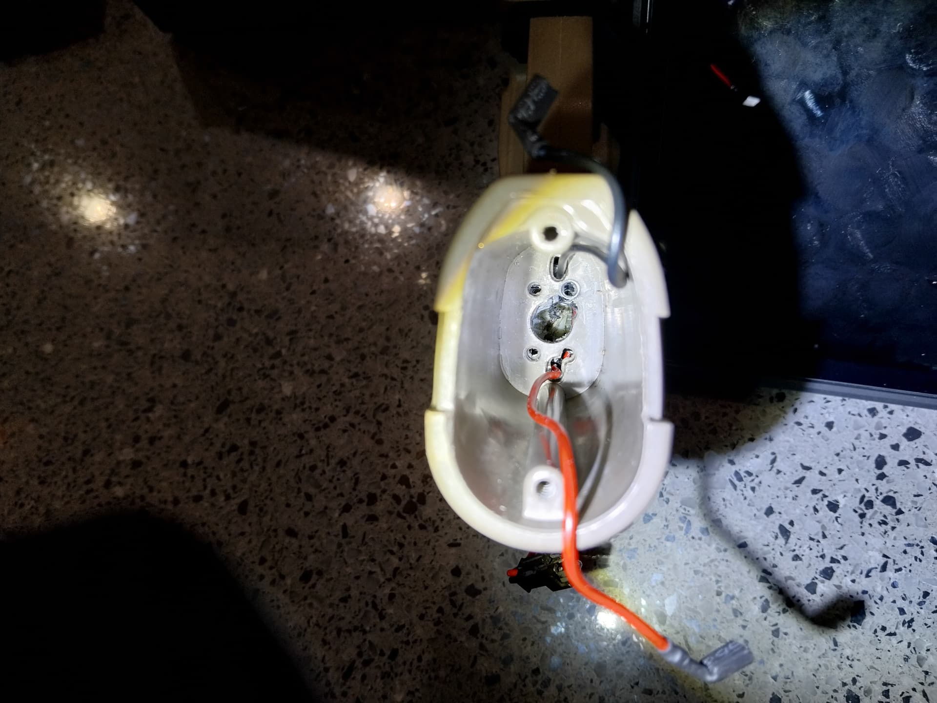

Just as I was heating up the soldering iron, I had a look inside, with my headlamp.
I could just see the now exposed bottom screw, in the gearbox.
I was just able to hold just enough pressure on it, with a needle nose pliers, to get it to turn…
So, gearbox now out.
Grip is still useable, and with a new/ transplant gearbox, you would still be able to use all 4 holes.

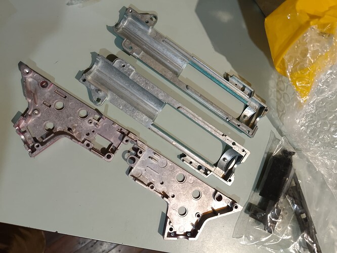

Found a shitonne of other random parts just in the 2 boxes I have in the spare room, out of hundreds that I have in the storage unit, but this might be of some interest for another project as well?
Brand new unopened Alloy MP5 threaded buttstock adaptor.
Have several “blanking” adaptors along with a few one’s that have a QD attachment end cap as well instead of the standard stock mount.
Just the ticket for that custom HQI MP5K Build. ![]()

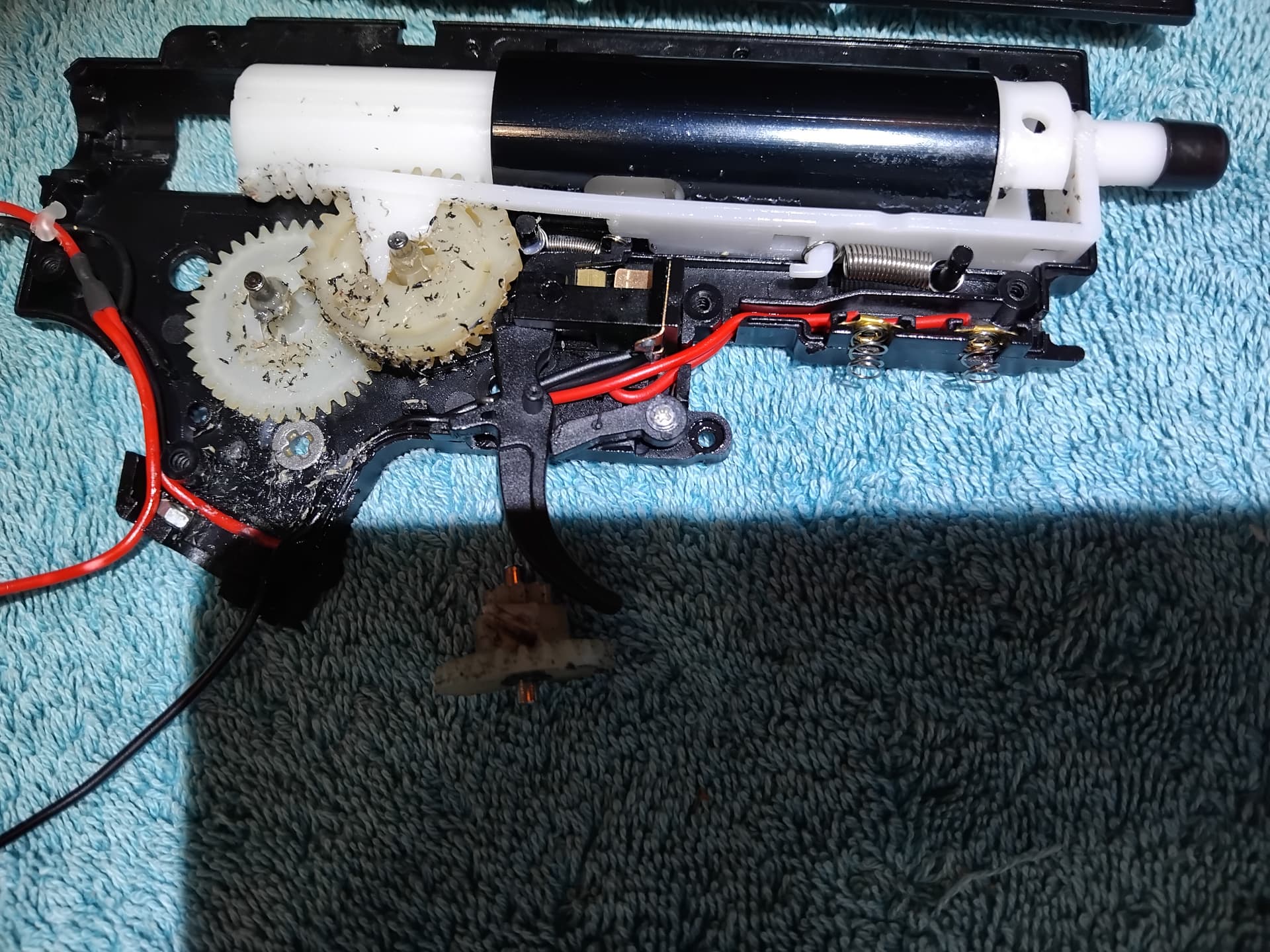

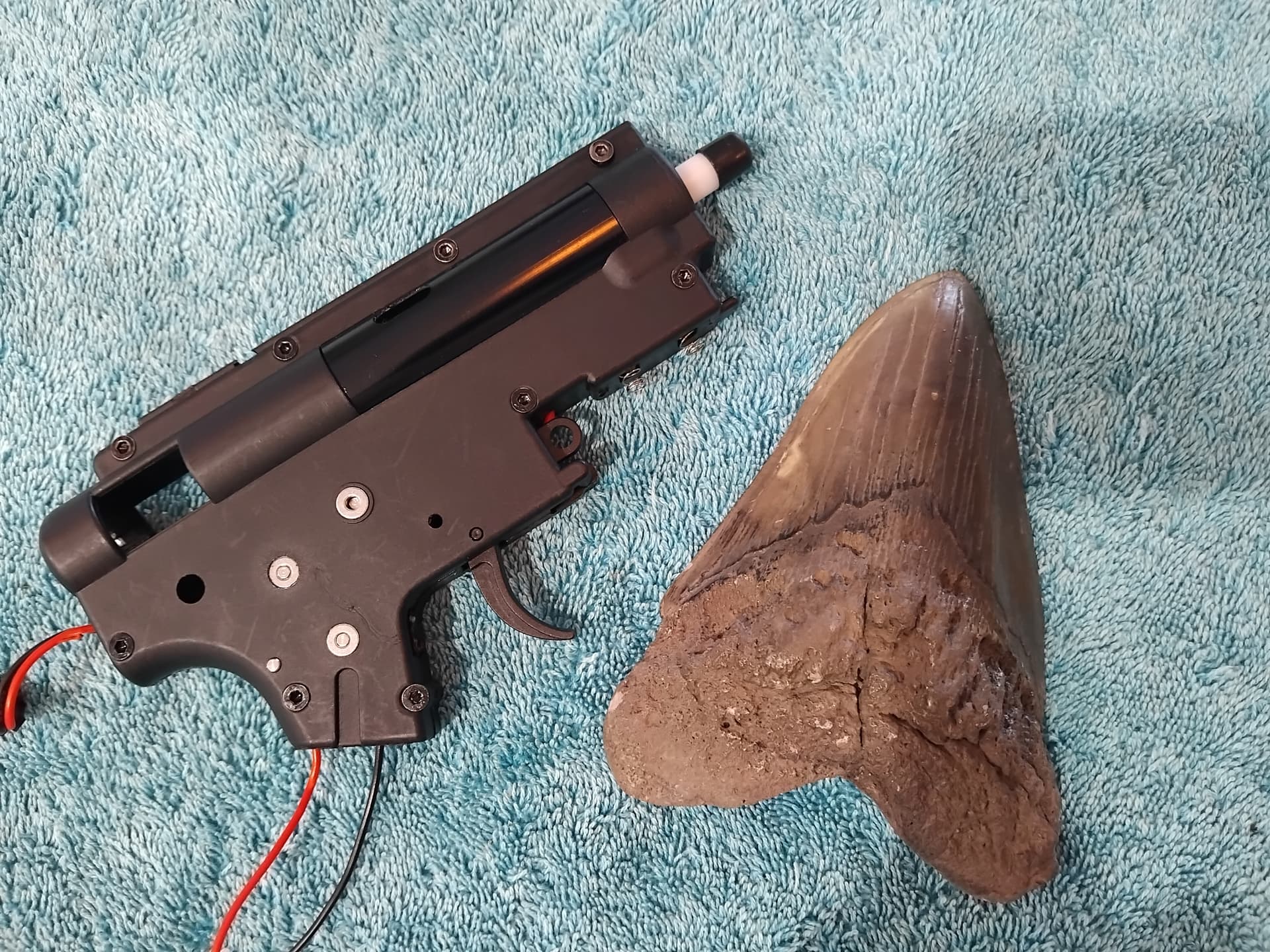

Ok…autopsy time…
Finally got THE GEARBOX out…!!
And opened it up for a look.

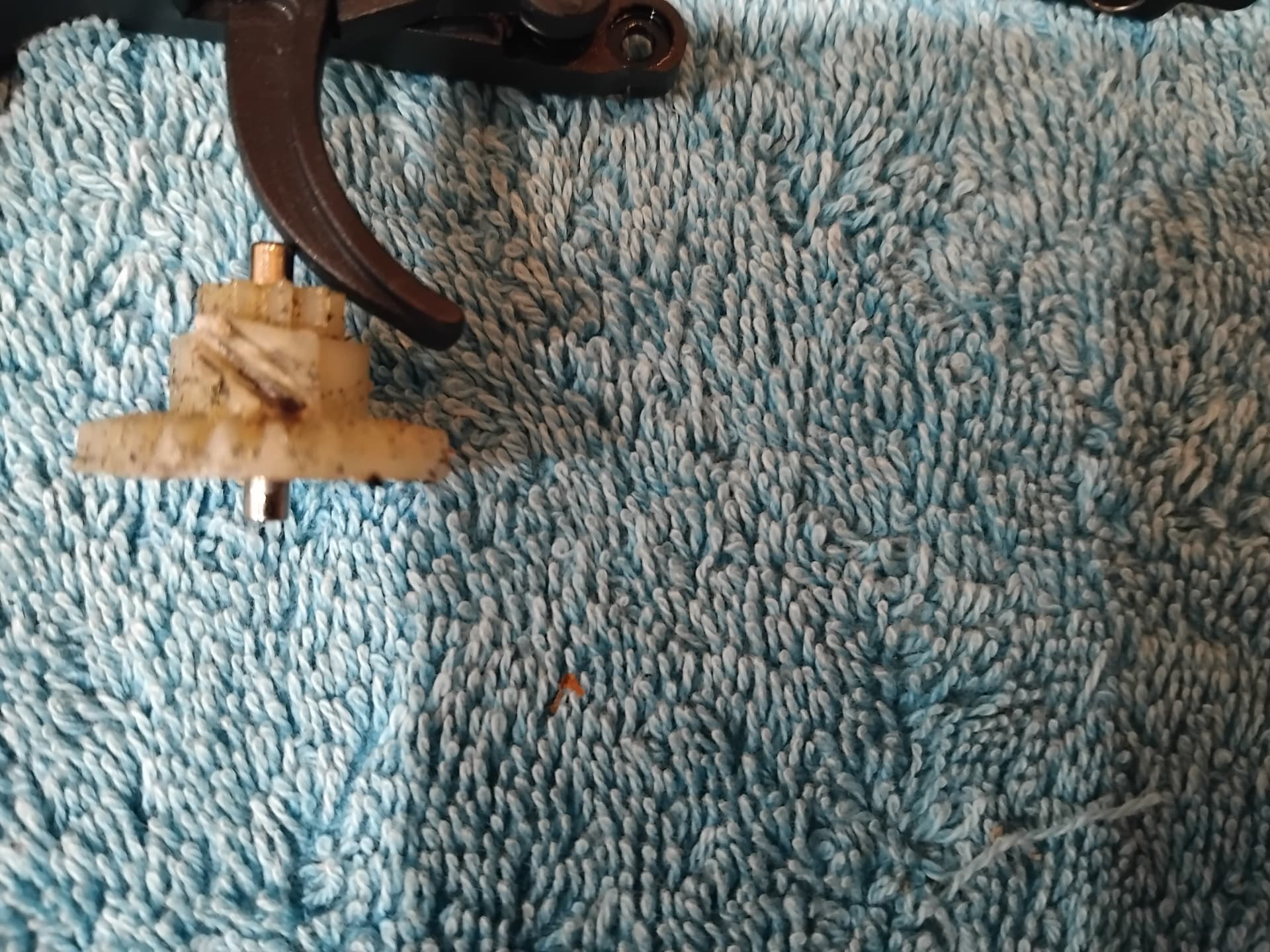

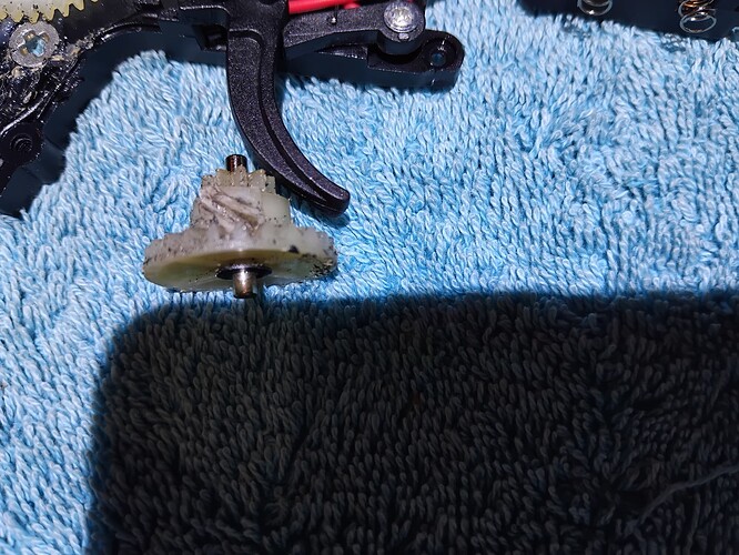

I screwed up the nylon gears, getting it out, but no biggy.
Cheap to replace nylon gears, hence why i whacked it with a hammer…
I guess these rate as " great condition, never been abused" , on the 2nd hand market.?.?!!
Pulling the rest of the gearbox apart, its obvious where all the drilling debris went…
The BAD news: crap everywhere…it needs a complete pull down and clean up.
The stock cylinder head is crap…sooo loose, it always pops out. airseal shite.
The GOOD news: wiring not massacred…barely was touched. New gears, clean up, new cylinder head…a functioning gearbox…with only 3 screws for the motor.
As i said, if nothing else, this would be an ideal teardown practise motor.

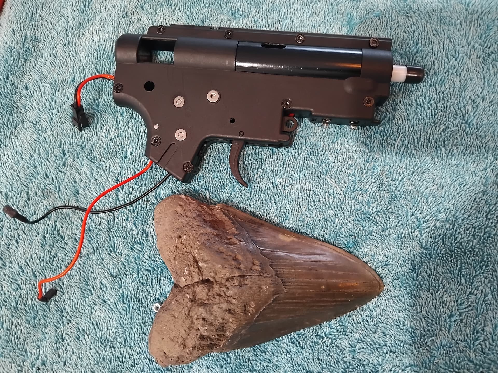

i was cleaning up, and found my genuine Megalodon tooth…
Just need to find its stand now…
Comparo size, next to a gearbox…
Most powerful bite force, of any animal that ever lived.
Swallow a human whole no problems.
Likewise, a small car.
I would love to be able to go back in time, and behold one of these behemoths…need a bloody big submarine though!!
Meg tooth…vs great white tooth…

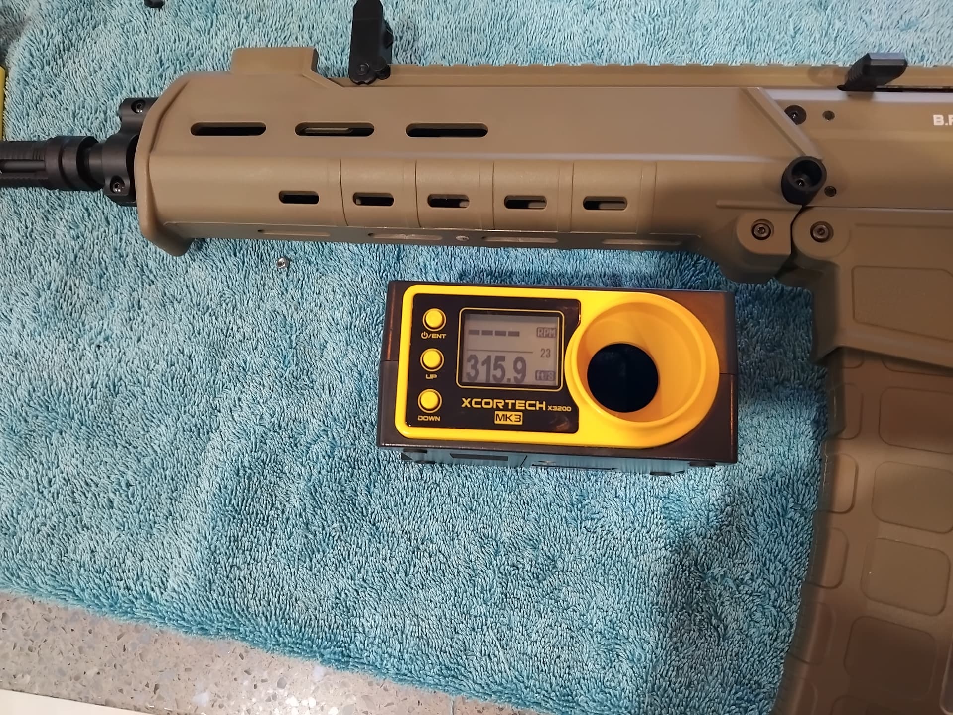

For what its worth, ihobby whites go really well with the xforce 7.5mm barrel…
The ones with the blue packet.
These are harder gas gels, dont blow up as the occasional pinky does, and dont curve off as much as the pinkies can. Being harder, they must deform less.
All this, from a M95 spring.
Lowest around 290, highest 320 i’d say average around 305 fps.

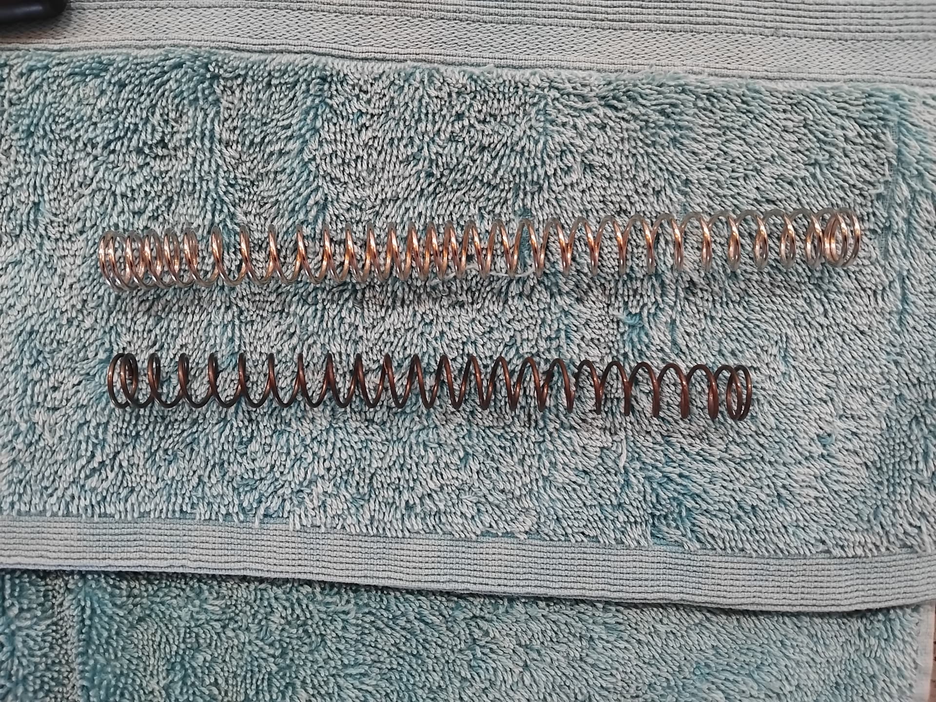

I was considering putting a M100 spring in…but the spring is a fair bit longer.
I tried fitting it into the test gearbox…it did fit, but felt Really Tight.
It would definitely shorten the gearbox’s life, until it goes bang.
For what…330+, out of a nylon box?
Metal box territory.
M95 is fine, for longevity and adequate performance…
M100 spring length, vs m95 length…

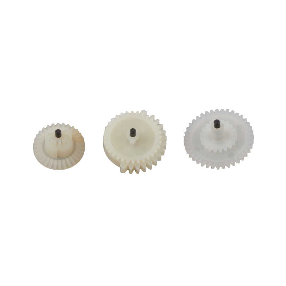

Do the Wells v2 nylon gears, fit in a standard v2 box?
Or at least the bevel gear.?
Thats the one i whacked.
Ausgel dont have any standard v2 nylon gears left.
I was going to say I found these, would they be good for it?
should do…
but xforce has these in stock…
