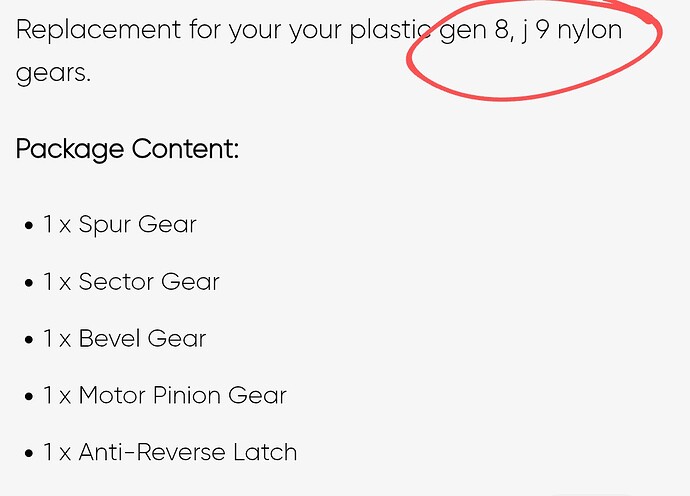

Just to be clear, the gearbox in an ACR J10 is just a Gen 9 box with an additional mag terminal plate built into the receiver. Gen 8 & Gen 9 share the same gearset. :thinking:
If you’ve been looking specifically for Gen 9 gears, might be why you can’t find any. Most sellers just list them as Gen 8 and assume you’re aware of the Gen 9 compatibility.

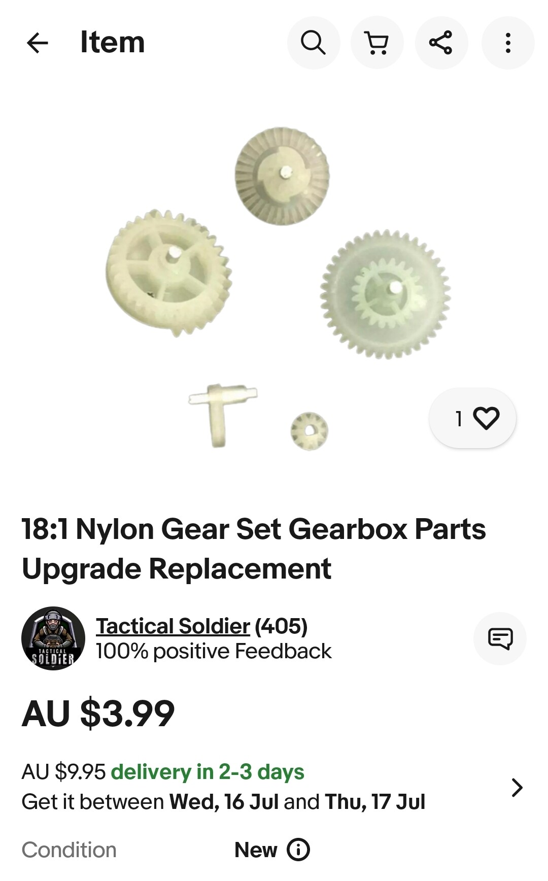

Lifted from the X-Force listing for Gen 8 nylon gearsets :
X-Force is also showing a stock level of 67 at Meadowbrook, so I don’t know why they’d tell you they have none. Here’s the link if you want to.pay $20 :

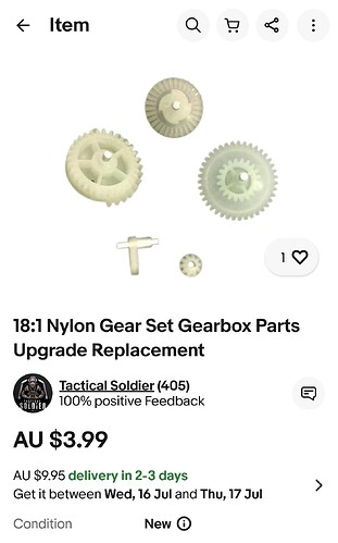

Or you can get them on ebay from a seller in Yatala for $4… buy five sets for the same price as X-Force stock. :roll_eyes:
https://ebay.us/m/WSYJgO

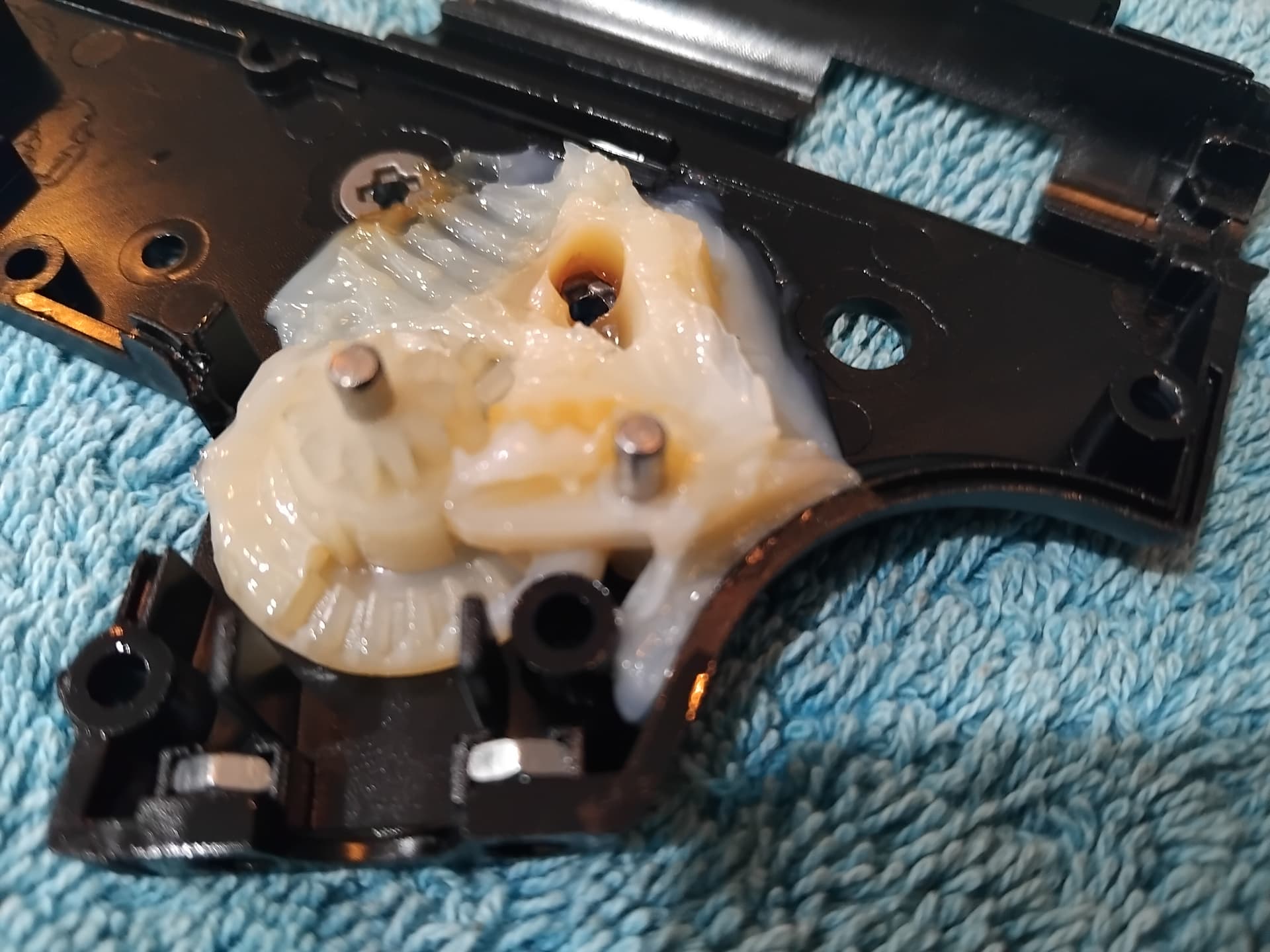

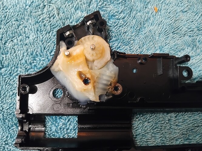

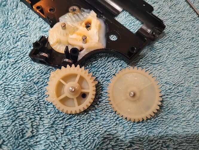

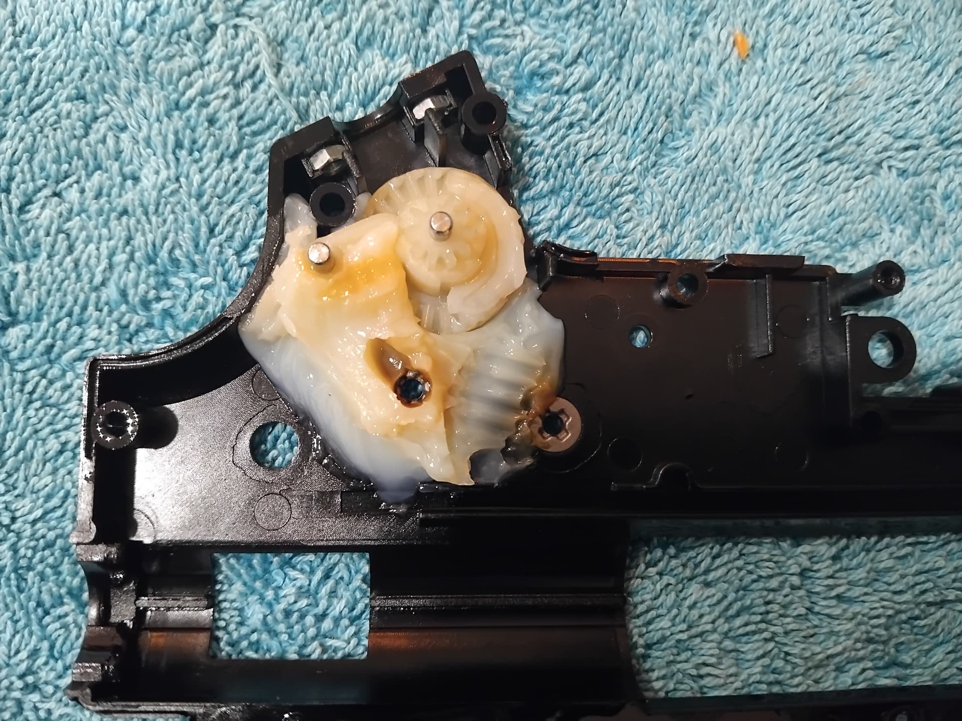

Got a new ACR gearbox, from xforce.
Pulled it apart, to change the o-ring.
Jinming assembly lesson #101.
Apply PLENTY of grease…for adequate lubrication…
In spite of all that, the gears remain bone dry…
go figure… :rofl: :rofl: :upside_down_face:
What the actual fuck? :rofl:
Looks like Wong and his mates at the Jin Ming factory had a bit of a circle jerk while they were assembling that one.
I’d be wearing rubber gloves. :laughing:

Narrator of documentary speaks
Here in this non descript factory we see a huge vat, where they are making enough grease to fully grease, 3 ACR gearboxes…
I don’t wanna know, what that white material is composed of…
