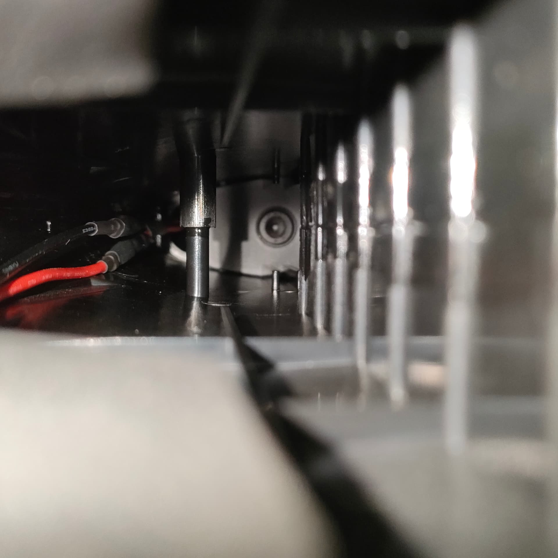

Hey any one ready this that may know.
I just got mine out of the box today and immediately noticed the stock has loosened itself and now wobbles and has about 2-3mm movement roughly…
I only used it once just after I got it and it wasn’t like that last time I used it, no one else has touched it. So it’s strange. Don’t think it was josselled or bumped whilst in the box nor from my use
I can’t see anywhere to easily tighten it up on the exterior, I’m assuming there’s somewhere to tighten it up from the inside?
Obviously opening it up to tighten would be the best solution but I’ve read these all had some play in the stock apparently much like the real steel.
So would finding something to use as a spacer to slot in it be a better solution?
If you take the two screws out of the backplate and take it off the stock you’ll see the screw that actually holds the stock onto the back of the receiver about two thirds of the way down. That’s the one you need to tighten, you’ll get zero wobble. Caught me out too, I have a JG M16A1. :person_shrugging:
Why JG didn’t go with the one big long bolt through from the back of the stock like CYMA did with their M16A1s is a Chinese mystery.
From an engineering standpiont, JGs setup should be stronger… but we’re only talking gel blasters here, so… :rofl:

Finally got around to investigating, it’s an Allen key screw,
:poop::poop::poop:
Hopefully I have one the will reach but otherwise it’s off to Bunnings I go
Grab Beemer to buy ya suasages while you’re at it haha
You’ll be an expert soon, metric and imperial Bondhus allen keys, JIS screwdriver sets.
What else can we get :thinking: oh of course 9" Makita :rofl: :+1:
Yeah I don’t know why they put the stock on that way… leverage and mechanical advantage I guess… but CYMA stocks stay solid with one big long convenient screw. :person_shrugging:
If you don’t feel like springing for a set of Bondhus long series ball drivers ( they ain’t cheap ) you should be able to get it with a long 1/4" socket extension and the right size hex bit.
That’s what I use. :+1:
