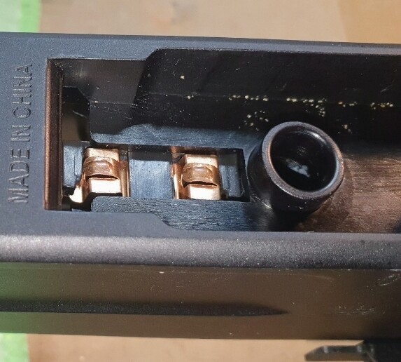

Did they change the terminals from spring to those plates on the stock blasters at some stage? Swear I have a j12 gearbox at home somewhere that came with those non-spring terminals
Some of the later J11s had these terminals, and definitely all of the J12s.
They’re still not a perfect solution, a bit prone to bending out of contact but a huge improvement on the janky springs. If only they were made of quality spring steel. ![]()
Even the early J12s have spring terminals. Mine still does, just have to be a little mindful of them when putting the mag in. Seen so many J11 and J12s with munted terminal springs over the years.
Same here, all my early J12’S had spring terminals, and they just loved getting bent outta shape with the rocking mag design, especially the front spring always needing constant “reshaping”.
Okay, my bad… I’ll stand corrected on the J12 mag terminals. ![]()

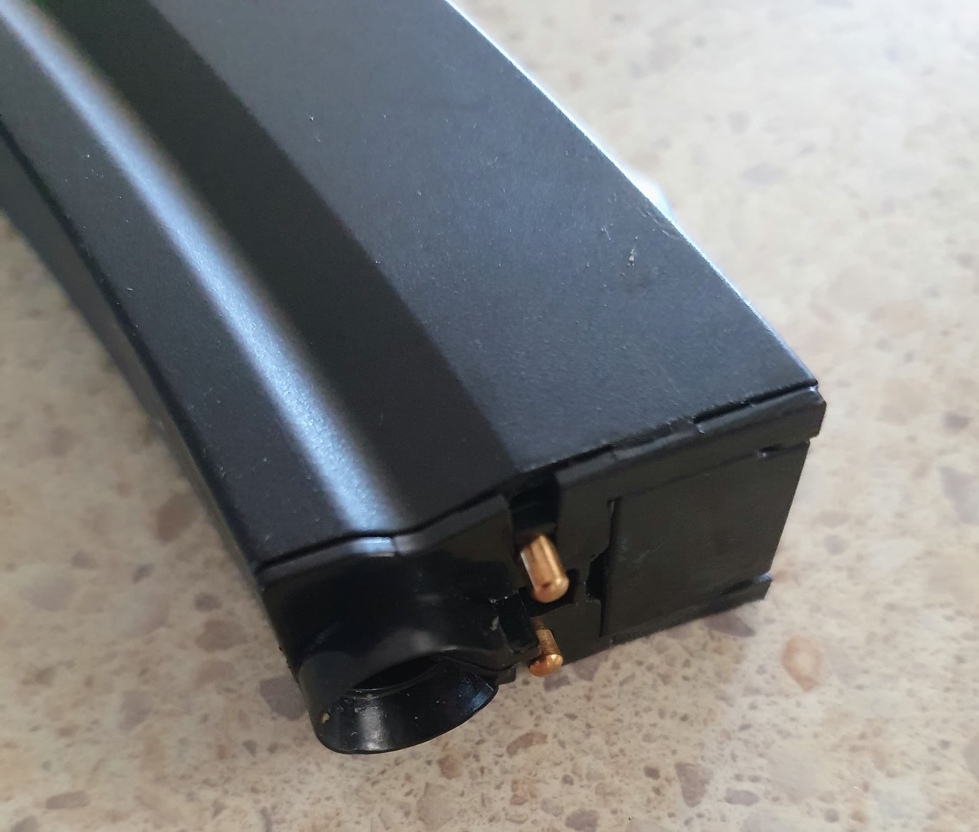

Might have a go at replacing the terminals on the mag itself with spring loaded brass pins and replacing the blaster terminals with flat plates, kind of like the Jin Ming MP5s.
Being located at the front of the AK mag might be problematic but you know what I say about “no guts, no glory”. ![]()
