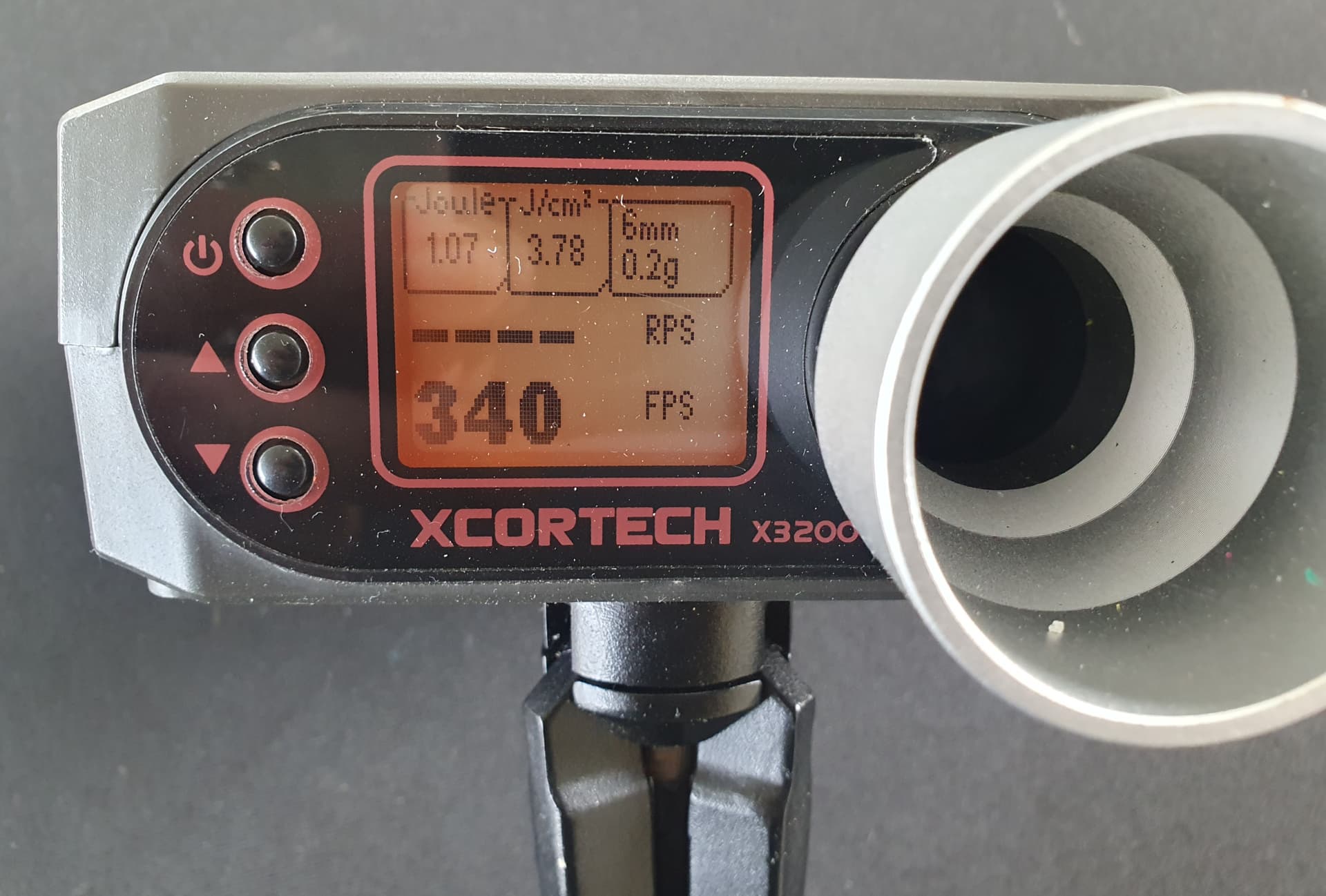

Swapped out the pison spring for an M100 this morning… with Armourtech greens.
Looks like I’ll be swapping it out again tomorrow for a smaller spring. 290’s the target FPS. :rofl:
That longer barrel bonus fps! M90 would probably still be just over 300, but I’d run with it :+1:

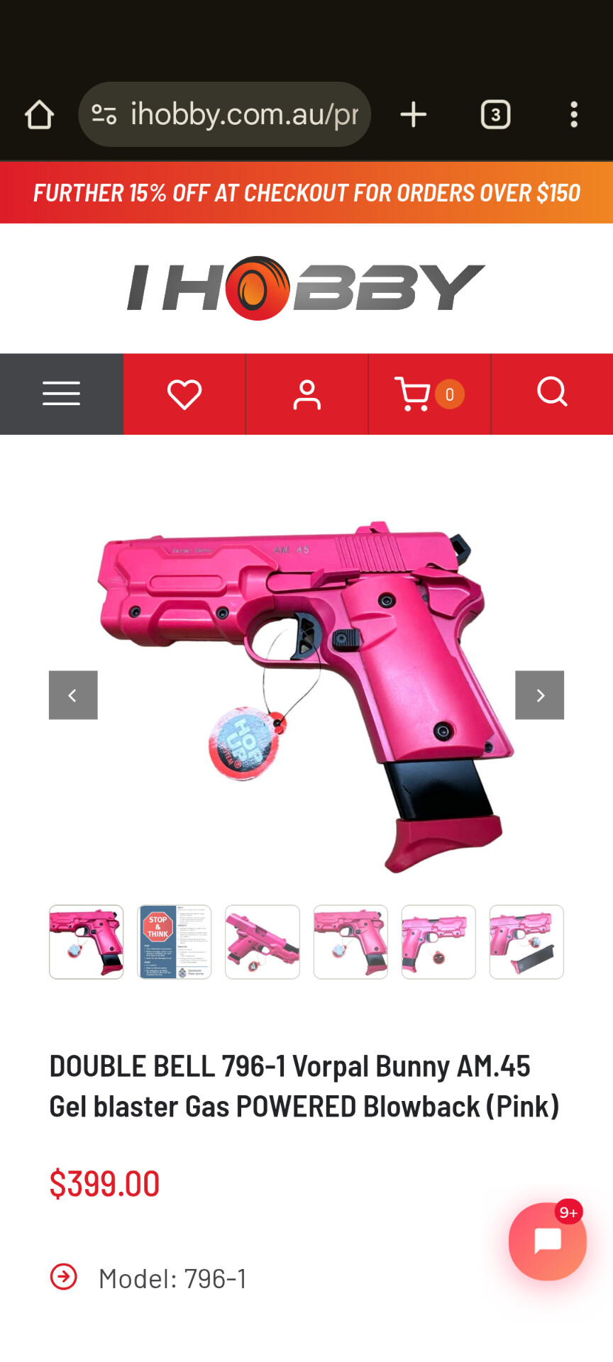

One of those Vorpal Bunny’s? think they were just a shell over a 1911 or Hicapa.
That’s the one… :+1:yeah, it’s got 1911 on the case label.
Need Polaroids to look at it. :rofl:
