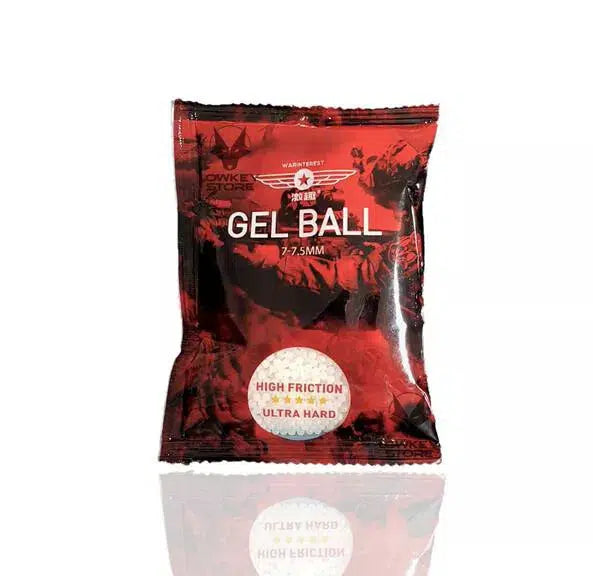

I’d highly suspect that the gels you’re putting through it are on the large size. Can’t really be anything mechanical, simple design. These things like hard gels that grow on the smaller side, maybe try some Ultra Elites or iHobby hards.

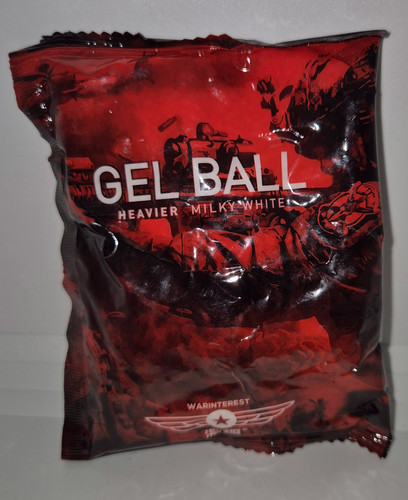

Mine had trouble feeding AKAs and the larger gels. Fed flawlessly with War Interest reds.

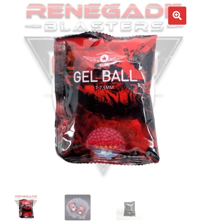

I believe renegade blasters is shut down
Akgelblasters is currently sold out of the war interest red gels
RandRblastersTSV has stock and are in Australia but I haven’t purchased from them so not sure of their legitimacy
M16gelblaster also still has stock that I have found but I believe they are in Holland? But are legit
No idea how legit this site is but they have the v4 war interest Red’s

Don’t get hung up on WI reds too much either… plenty of other smaller sized gels would work just as well, and the KELe manuals do like the ultra hards.
