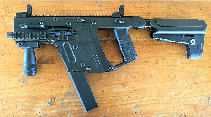

Has anybody managed to find a red dot sight with enough elevation djustment to zero in somewhere close when it’s mounted on a KV V2?
Tried a Sig Romeo, Aimpoint Micro, EOTech 551 and 552, they all run out of adjustment before they get anywhere near zeroed. Obviously the problem’s in the janky sliding top pic rail arrangement, it seems the top surface of the upper receiver and therefore the pic rail’s in no way on the same elevation plane as the inner barrel.

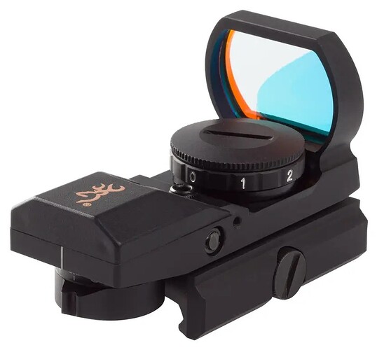

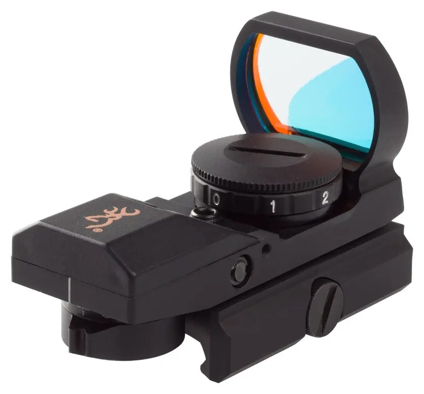

Funny you mention red dots…
This just arrived today.
I was going to put it on a pistol, but mounting issues…
“If it doesn’t have a upper rail, likely not to prevail…!”
I put it on a SCAR.
super cheapy, but seems ok so far…adjustment works…

@BME SCARs are easy to sight in… they’ve got a solid top pic rail. Sadly, the removable Vector top rails are pretty janky and poorly designed.
@RokSolid I’ve dressed the top of the receiver flat and square, the pic rail slides on and sits flat and level, held down pretty securely around the sight location with a couple of extra screws. All I can think of is the receiver top and inner barrel aren’t anything like parallel. As it is now, at max adjustment I’m putting the dot or reticle about 40cm or more above target when I’m hitting it at a range of about 4 metres. Pretty shitful.
I guess a metal pic rail might help, X-Force still have one… but it’s a dovetail fitment and if it’s firm it won’t allow me to cant it up at the back to angle it downward to realign it with the bore.
I’m probably way overthinking it… hate to say it but I think @Maiphut is right… it may just have to be iron sights for this Vector. :person_shrugging:

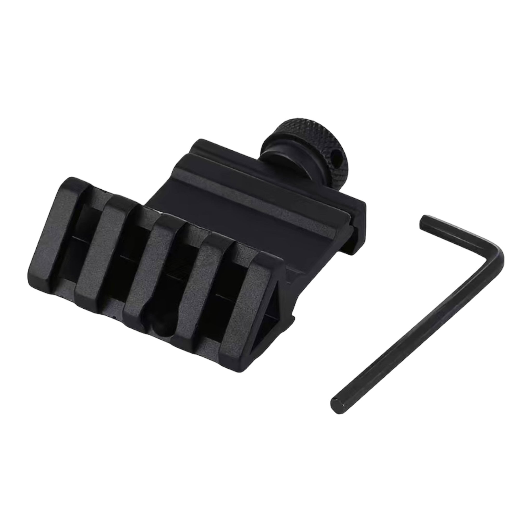

If you mounted it on the side rail would it help getting the elevation angle better or would it be just as bad or worse?
Edit: My bad I read wrong, it’s been a long night at work, thought you meant just a red dot attachment
side mount a sight, good one @shadow187 ya f#ckwit :joy::joy:
Although if you were shooting sideways Gangsta style it could work :thinking::joy:

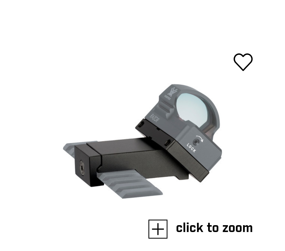

Found these
images (20)
images (24)
You’re in luck, vipertac have them in stock for $24
$15 at x-force
I kinda want one for myself now

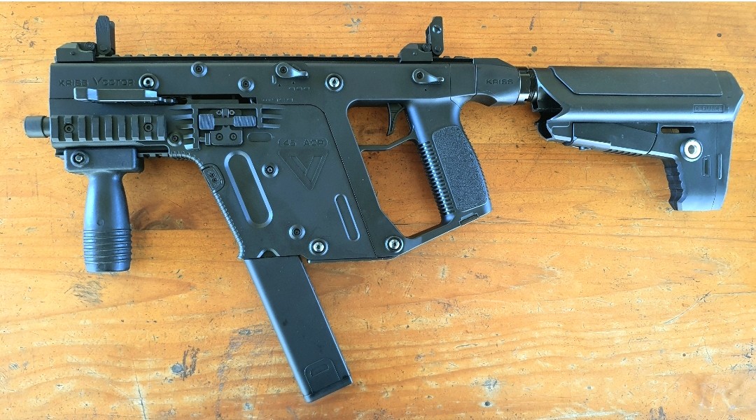

By creatively packing under the nylon rail of the KV with masking tape I managed to get a downhill run happening underneath the red dot sight… just enough to get it close and zero in an Eotech 553 clone. With the rail secured with a couple of small screws into the receiver top the sight’s almost at the limit of it’s elevation adjustments but it’s there.
At about 5 metres with the reticle centred on a 10cm round target I’m getting pretty much a 100% bullseye rate with gels bang on the target every trigger pull.
Beyond that range, at around 10-15 metres all the gels hit the target with a spread within the circle of the reticle, so I’m guessing about 20cms, prettu good for such a short barrel and certainly good enough to hit an opponent sticking his cruet around a corner in a CQB game. :wink:
