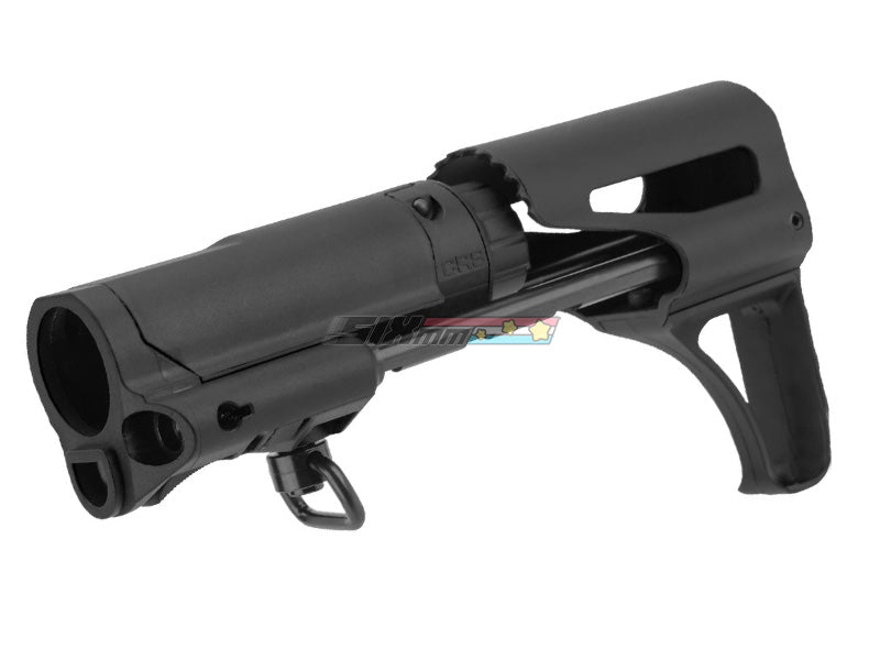

PDW stock from X-Force and it’s done. :sunglasses:
