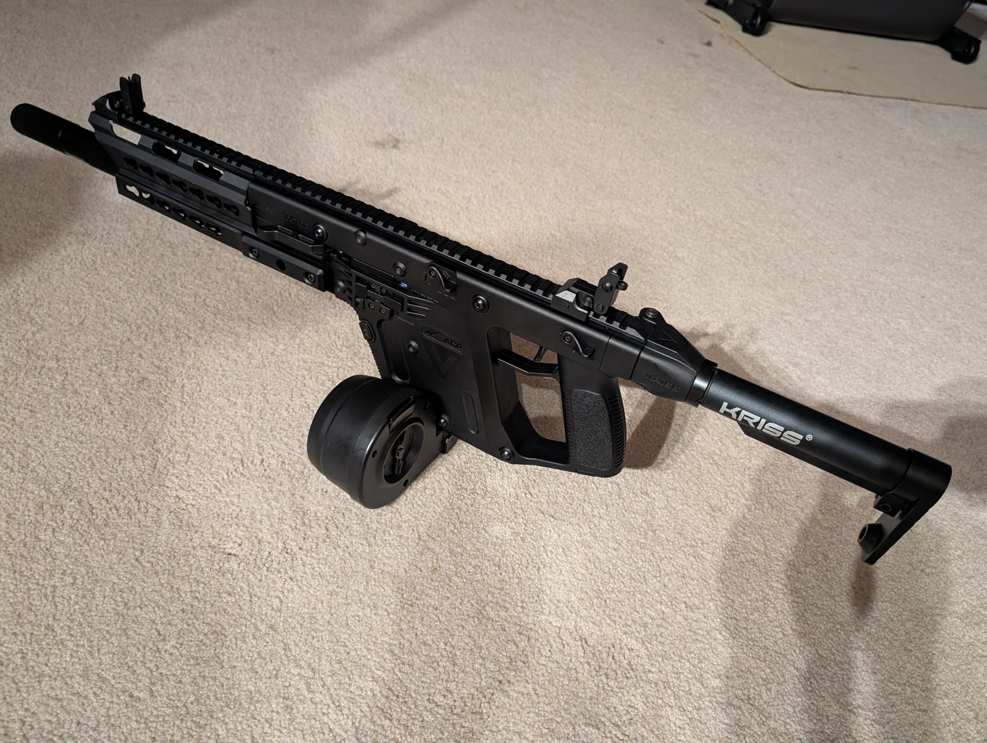

Run the double drum mag, then you really wont hold it there is how the wife and I have dealt with it.
I am working on a customers vector at the moment, and casually chipping away at another one for me and the wife…
How much vector is too much vector?
Going for the LMG/DMR build :rofl::rofl::rofl:

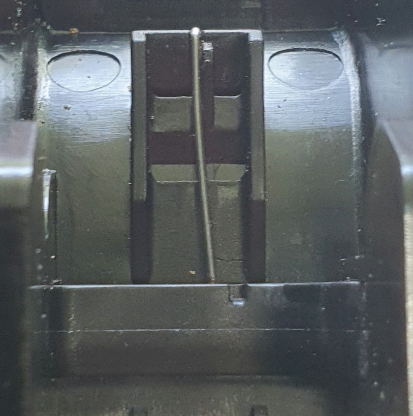

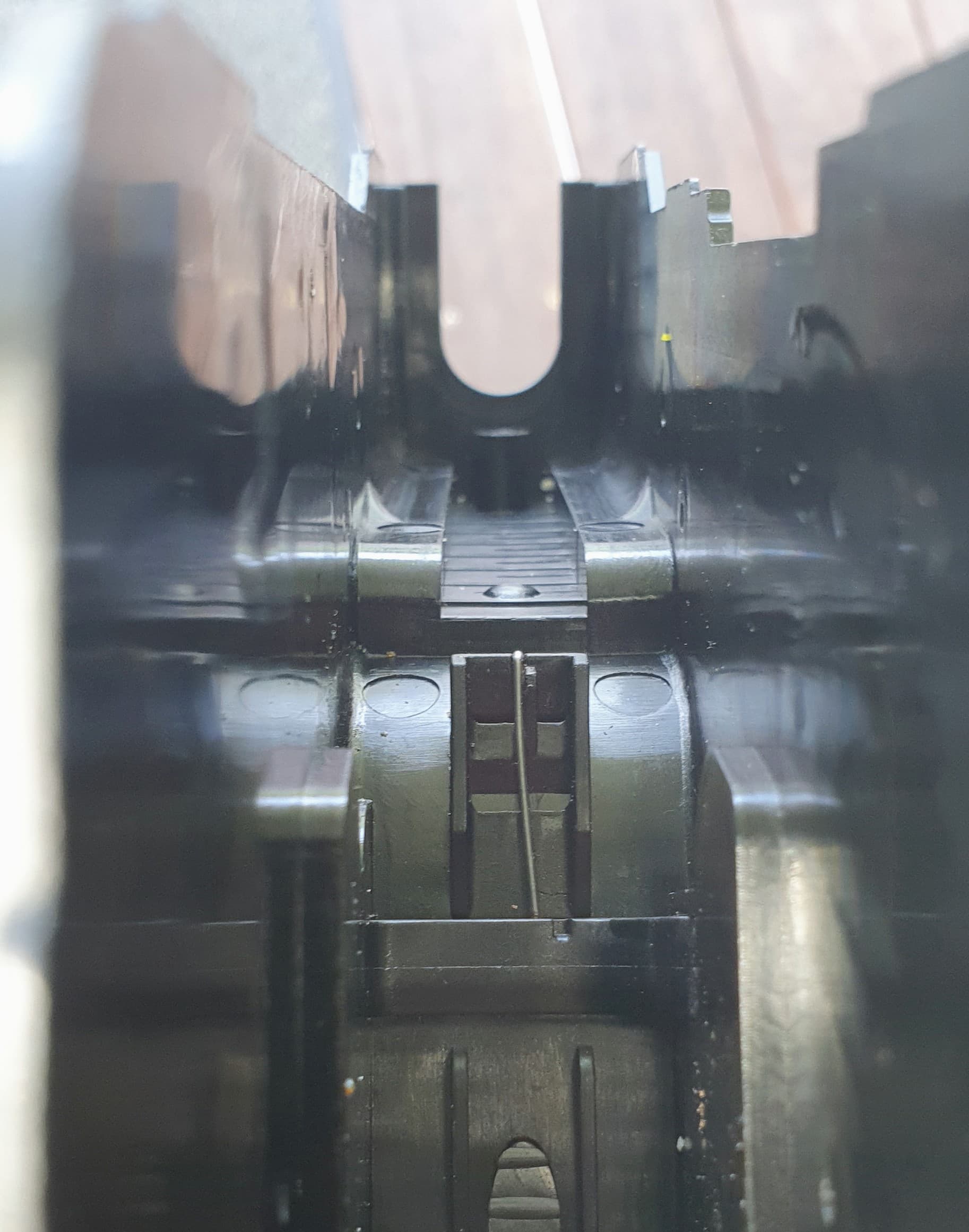

For the KV uninitiated, the OEM mag catch arrangement is like this… you’d know if you ever fitted a blackout kit to a Vector.
Looking at it close up, easy to see the flimsy spring and catch bar.
Woefully weak and poorly designed. The rib that is on the receiver that prevents the spring from moving sideways is very high up, allowing a lot of spring doing the minimal work.

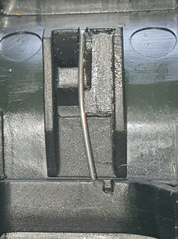

Easiest fix was to cut up a nylon block and glue it onto the receiver, effectively shortening the working part of the spring, preloading the catch bar a little more and stiffening up the button. You get the idea.
It would have been nice to replace the spring with a heavier item but the location holes in the receiver and catch bar don’t have enough meat around them to drill out.
All back together and working a treat. It now has about the same resistance at the button as an M4 running a coil spring.

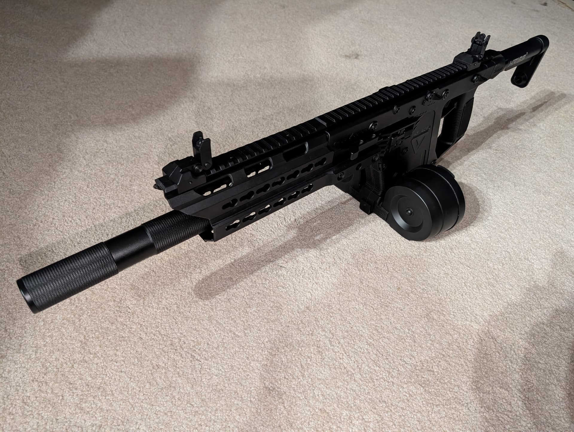

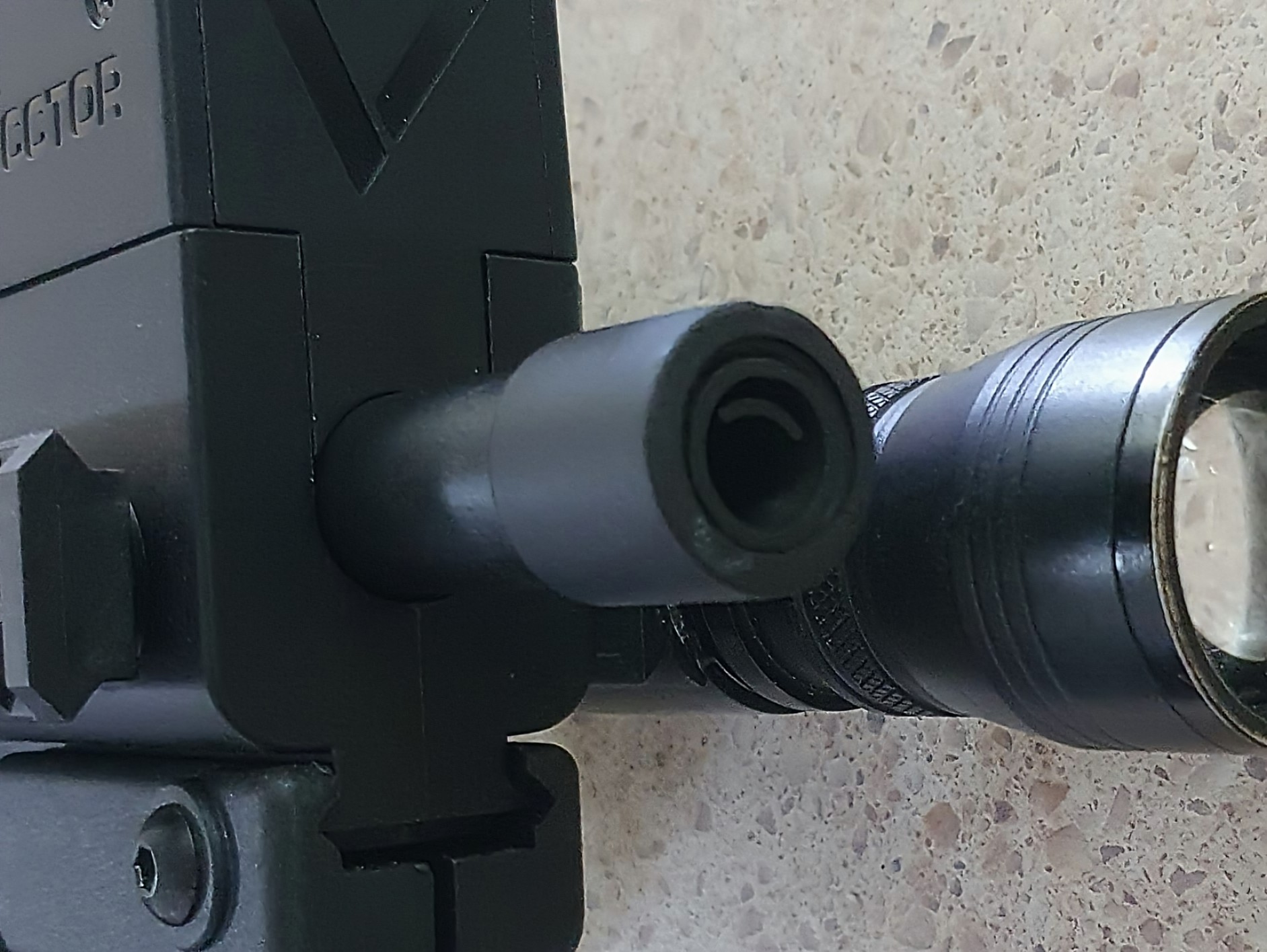

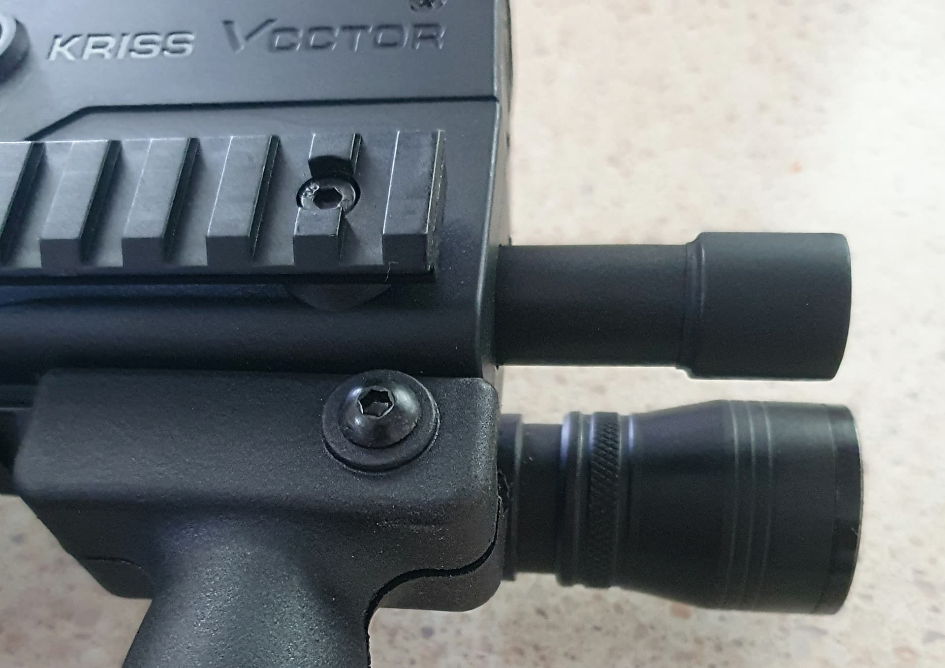

While I was there I bored out the outer barrel to take a hopup and made it look a bit more Kriss correct… a knurled cap would be nice, but that’ll have to wait for now. Electrical tape and heatshrink does the job okay.
The Vector lives on! Good times! :sunglasses::+1:I
